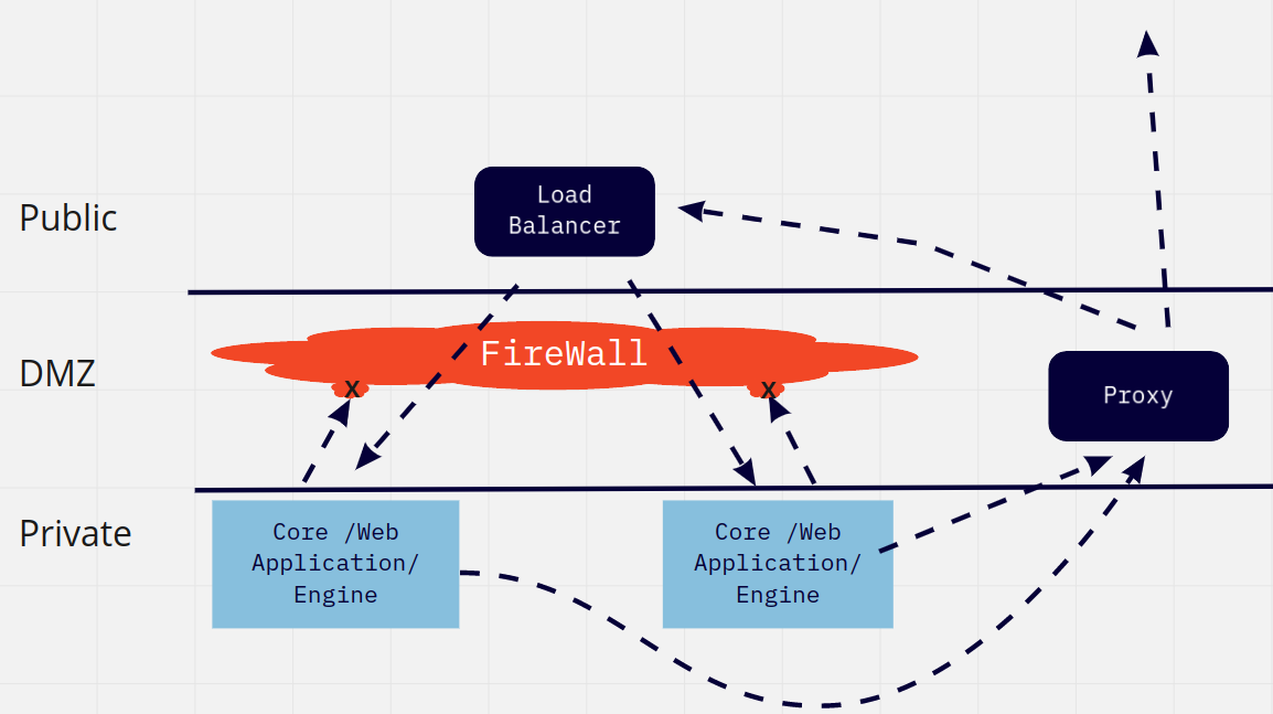

“How can I run jobs when my FME Flow Core cannot send traffic to my Load Balancer directly?”
FME Flow can be configured with a proxy server to enable the Web Application/Core/Engines to send outgoing traffic. However, the FME Services used to submit jobs were designed to remain internal, so they are not included in this proxy configuration. In some installations, your Load Balancer may be able to send traffic to the core, but the core may not be permitted to send traffic back to the Load Balancer. In this case, you will be unable to submit jobs via the run workspace page.
The file ‘hosts’ is an operating system file that maps hostnames to IP addresses. For each core machine, add a line to the host file mapping the Load Balancer's hostname to the current machine. The mapping consists of two values: “127.0.0.1”, which will reference the local machine, and the name of the load balancer.  This entry will allow the calls needed to submit a service (run a job) to stay local to the machine.
On Windows, this file can be found at C:\Windows\System32\drivers\etc\hosts.
For Linux, it is /etc/hosts.
Example line to add to hosts file: 127.0.0.1        MyLoadBalancerName
