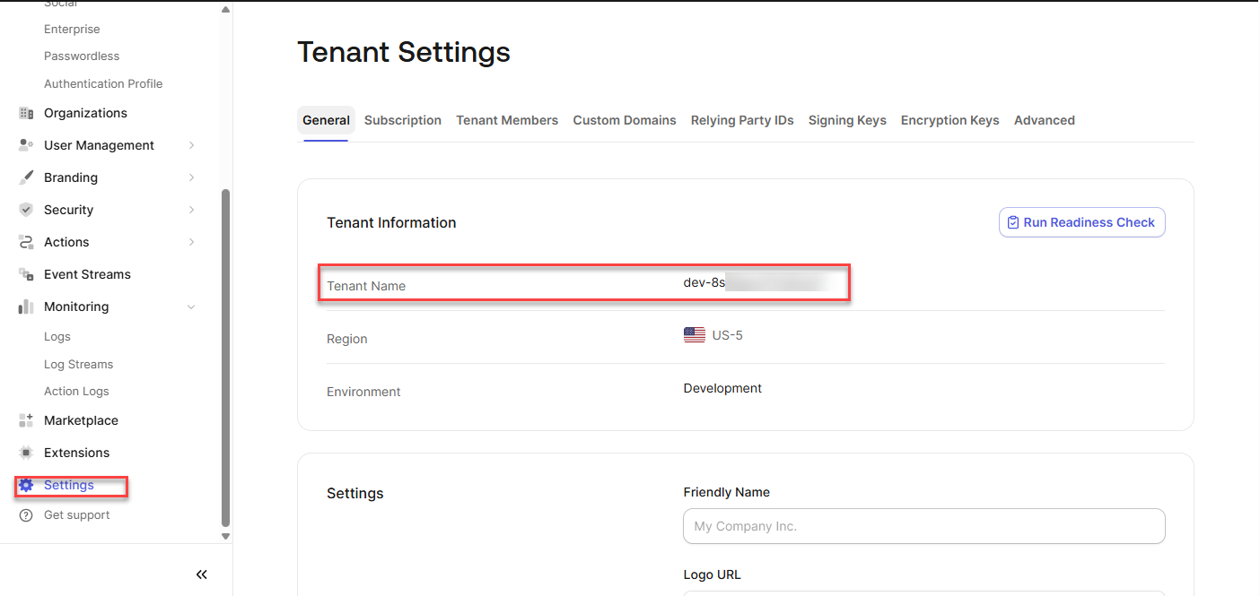

1. Record the Tenant Domain
On the Auth0 homepage under Settings > General, record your tenant's domain name. This value is needed later to build the Authorization Server URL in FME Flow.
In Auth0, the tenant domain is the issuer, the formal identity of the login service that gets stamped into every token.

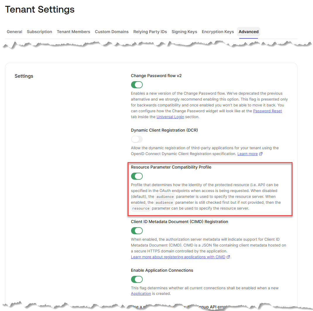

2. Enable the Resource Parameter Compatibility Profile
MCP clients declare their destination with the RFC 8707 resource parameter, and the identity provider must translate that into the token's audience. This setting tells Auth0 to honor that parameter.
Under Settings > Advanced, enable Resource Parameter Compatibility Profile and click Save.

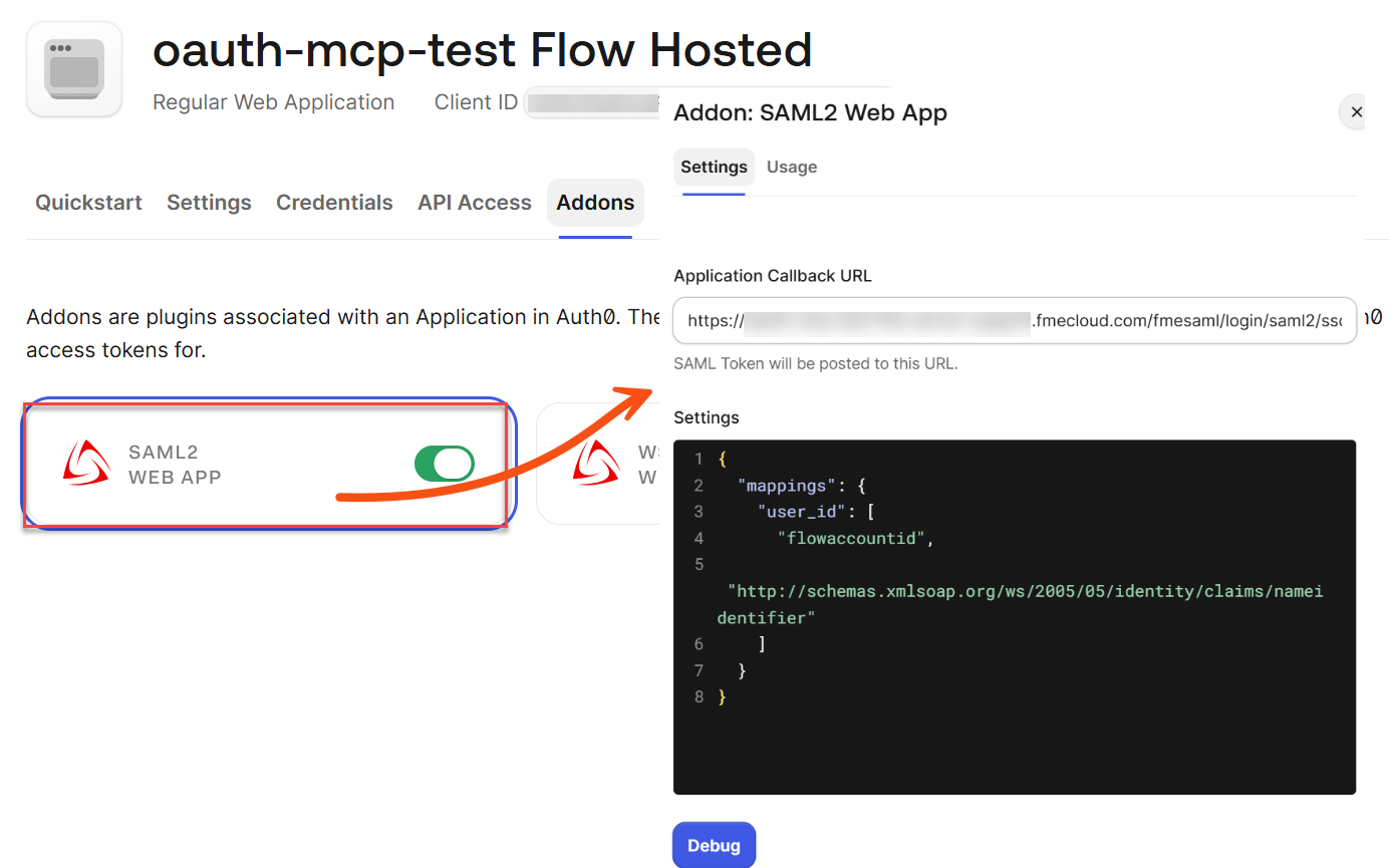

2. Add the flowaccountid Attribute Mapping
In the configuration menu for the SAML2 Web App addon, under the Settings tab, add the following attribute mapping to the JSON settings and click Save:
"mappings": {
"user_id": [
"flowaccountid",
"http://schemas.xmlsoap.org/ws/2005/05/identity/claims/nameidentifier"

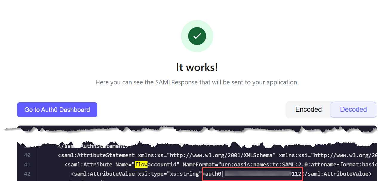

}This mapping is the link between the two authentication systems: Auth0's OAuth access tokens identify the user with the sub claim, which contains the Auth0 user_id (for example, auth0|abc123…). This mapping makes the SAML assertion carry that same value as the flowaccountid attribute, which is what allows FME Flow to match an OAuth token to the SAML-provisioned user.
To confirm the mapping was added correctly, click the Debug button and check that the decoded SAML response contains an attribute named flowaccountid with a value beginning with auth0|.

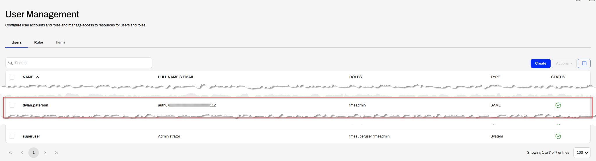

3. Log In to FME Flow via SAML to Provision the User
Complete Part 2: FME Flow Configuration and Part 3: Test your Configuration of Configuring FME Flow for Auth0 SAML Authentication.
Logging in for the first time creates the FME Flow user account and stores the flowaccountid value on it. Every user who will access the MCP Server through OAuth must log in via SAML at least once. Verify the account was created under User Management.

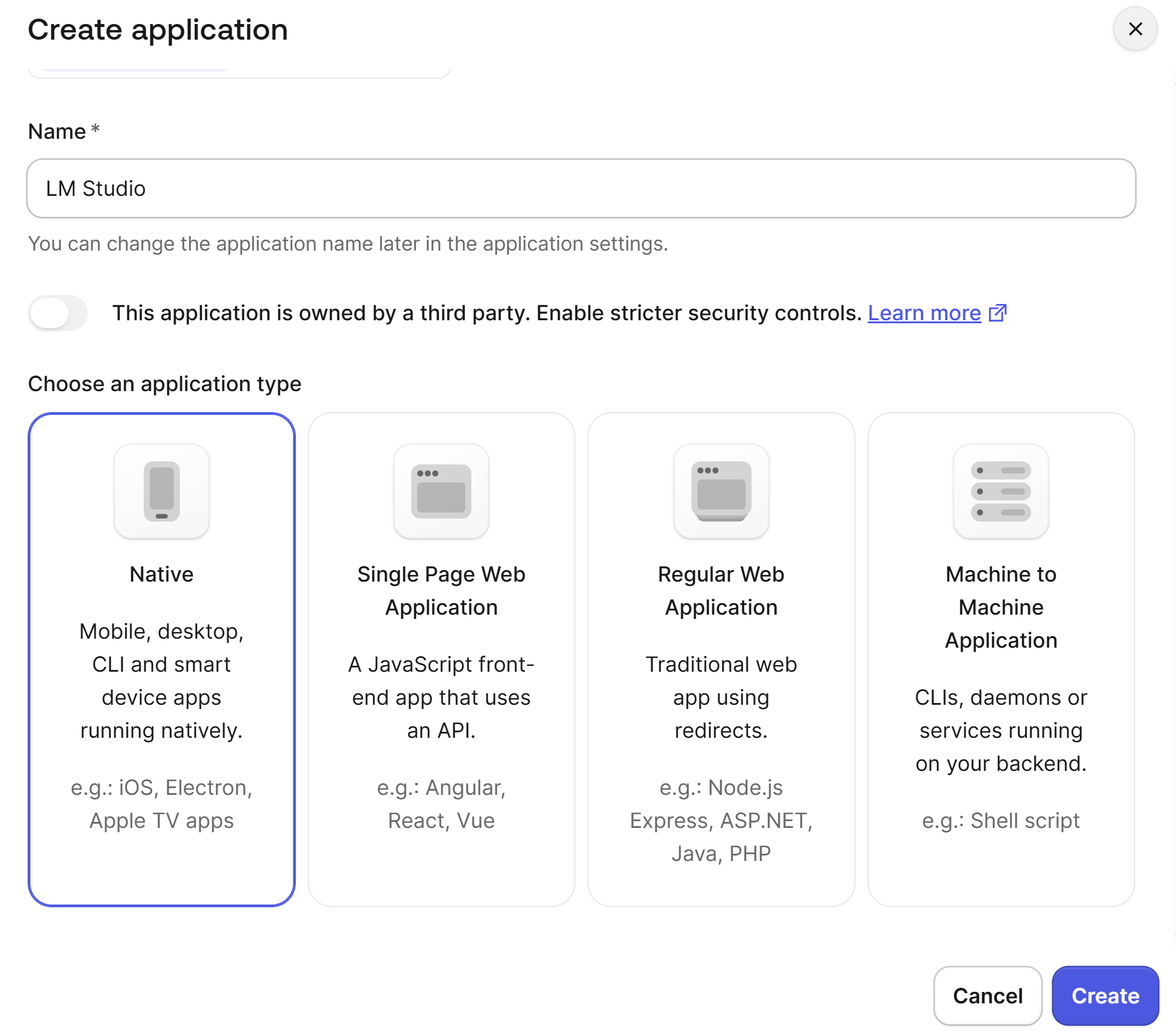

1. Create a Native Application
Return to the Auth0 portal. On the Applications page, create a new application for LM Studio and set the type to Native.

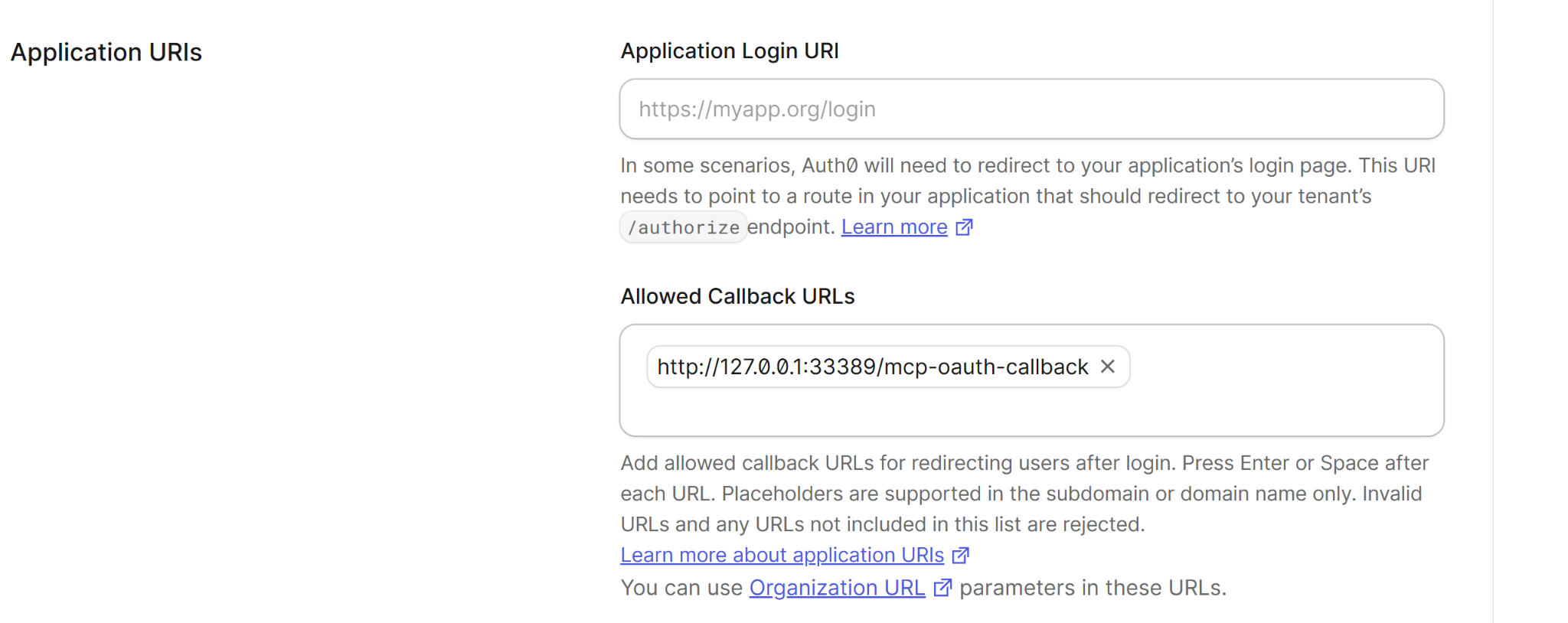

2. Set the Allowed Callback URL
Under Settings for the newly created application, scroll down to Application URIs, and set Allowed Callback URLs to:
http://127.0.0.1:33389/mcp-oauth-callbackas specified in the LM Studio documentation.
Auth0 will only return login results to pre-registered addresses. The exact value comes from the client's documentation; when adapting this tutorial, always use the value your client documents or displays.

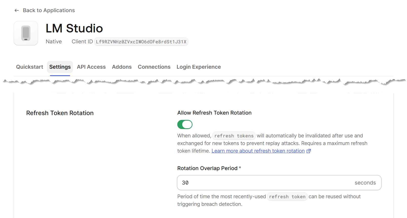

3. Enable Refresh Token Rotation (optional)
If you plan on using refresh tokens, this step is required. Under the application's Settings, in the Refresh Token Rotation section set:
- Allow Refresh Token Rotation: Enabled
- Reuse Interval: A value of your choice, for example 30 seconds
Public clients receive rotating refresh tokens; each renewal invalidates the old token and issues a new one.

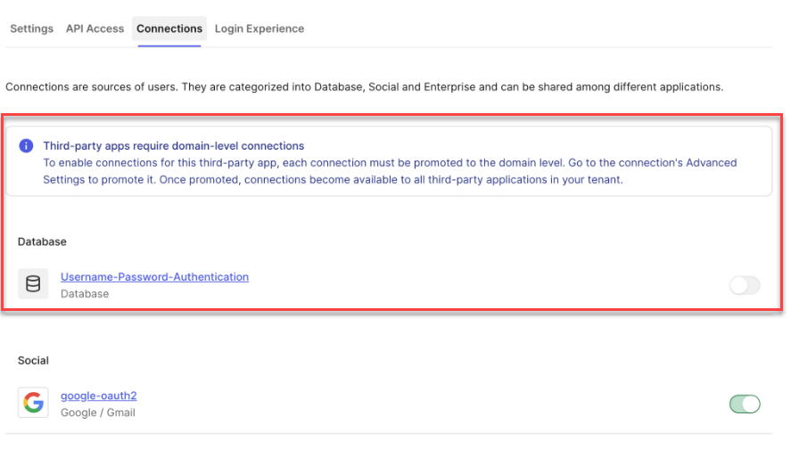

4. Enable the Database Connection
Under Connections, ensure Username-Password-Authentication (or whichever connection your SAML users belong to) is enabled for this application. You may need to promote the connection to the domain level. Follow Auth0’s instructions to do so.

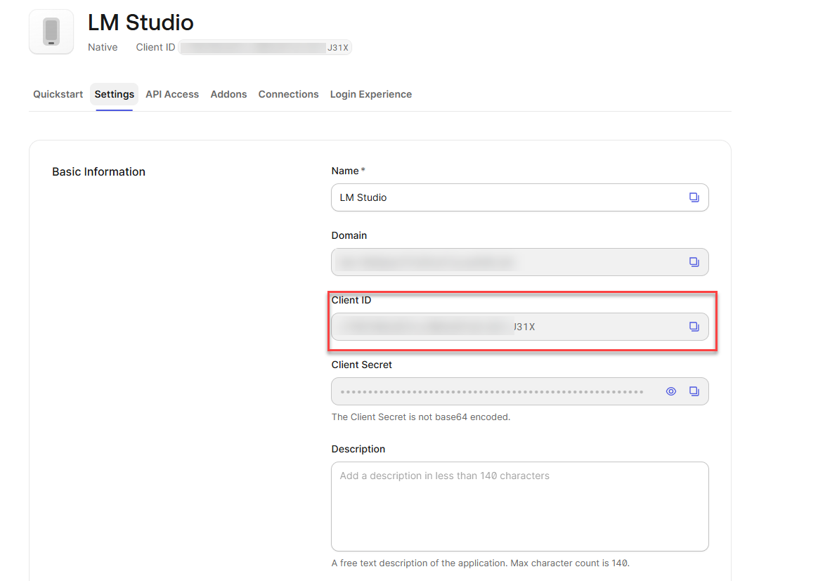

5. Record the Client ID
Return to the application's Settings and record the Client ID. This will be entered in LM Studio's configuration in Part 6.

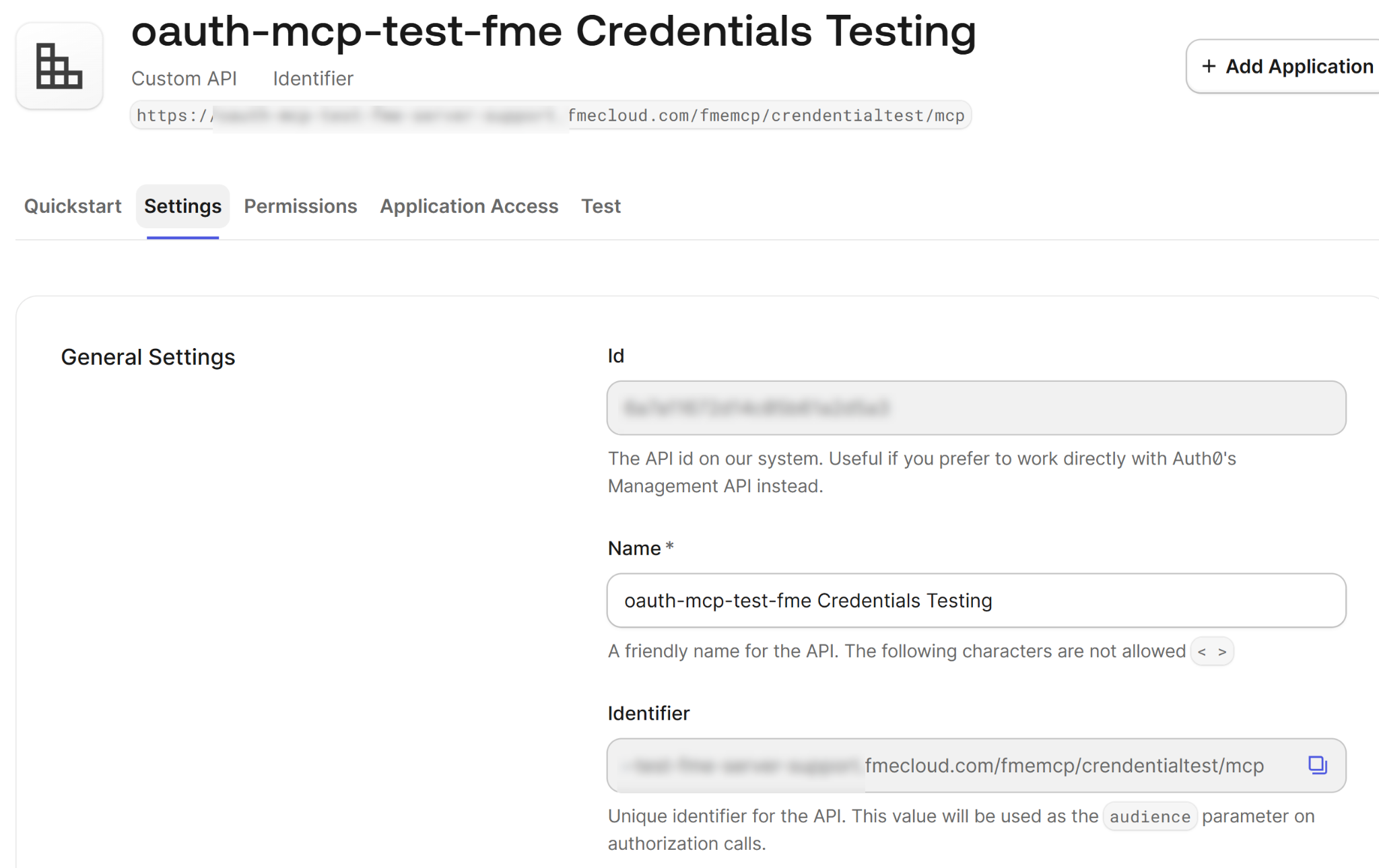

1. Create the API (the MCP Server's Identity)
From the Auth0 sidebar, navigate to Applications > APIs. Click Create API. Give the API a name, and enter the MCP Server URL as the Identifier:
https://<your-flow-host>/fmemcp/<server-name>/mcp
Important: The Identifier must match the MCP Server URL exactly, character for character. This value becomes the aud (audience) claim inside every token, and FME Flow compares it to its own URL exactly. A single character of difference produces tokens FME Flow will reject.

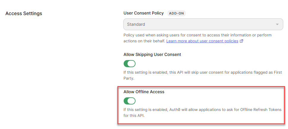

2. Enable Offline Access (Optional)
Under the API's Settings, enable Allow Offline Access. This permits clients to request refresh tokens, which lets them renew access silently instead of re-prompting for login each time the access token expires.
Note: If you enable this setting, you must also enable Refresh Token Rotation on the client application in Part 3, step 3.

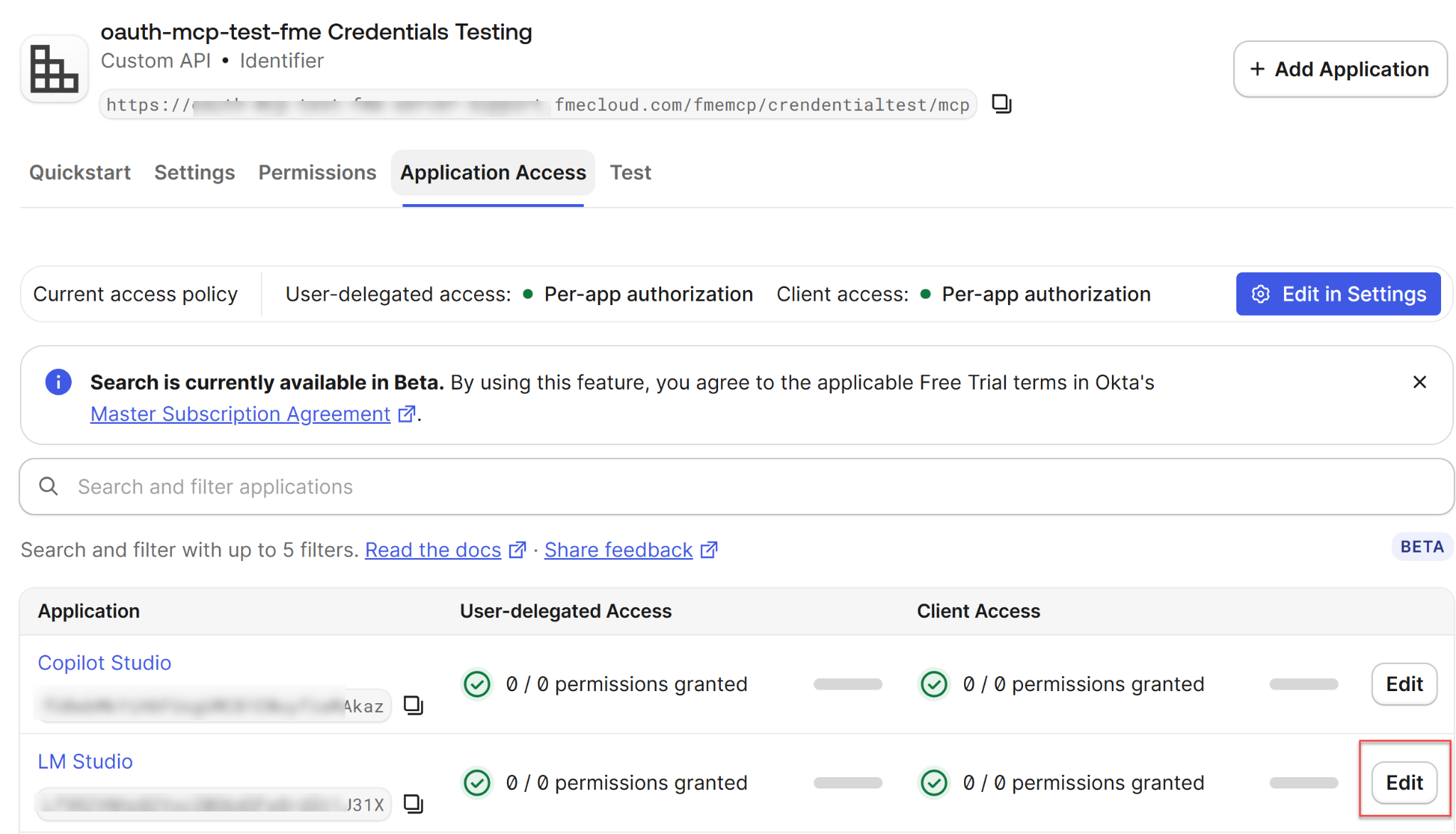

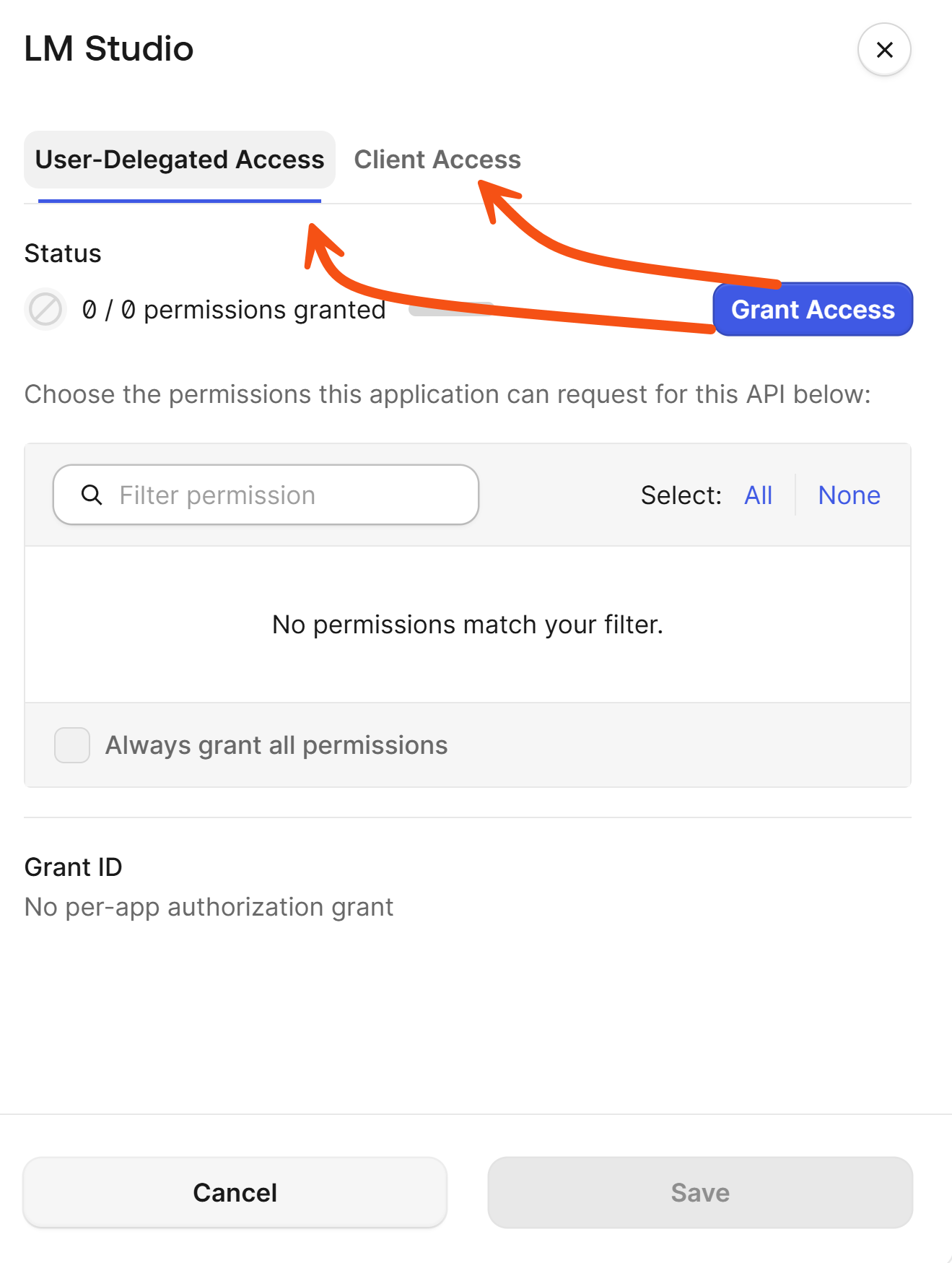

3. Grant the Client Permissions
Under the Application Access tab, find the LM Studio application and click Edit.
Grant User-Delegated Access and Client Access. Click Save if prompted.

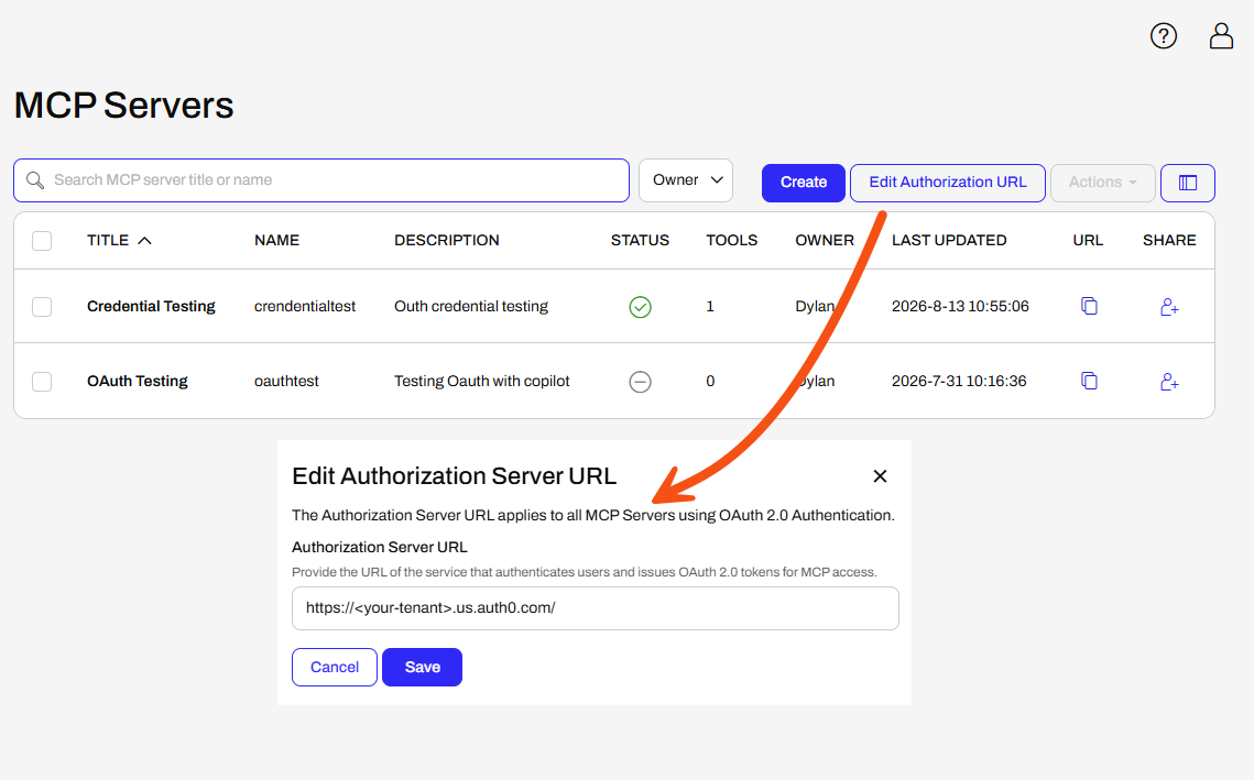

2. Set the Authorization Server URL
From the MCP Servers menu, select the Edit Authorization URL option and enter your Authorization Server URL. For Auth0, this is your tenant domain from Part 1. Depending on your region, your URL might look different.
https://<your-tenant>.us.auth0.com/This field expects the issuer, the identity of the login service.

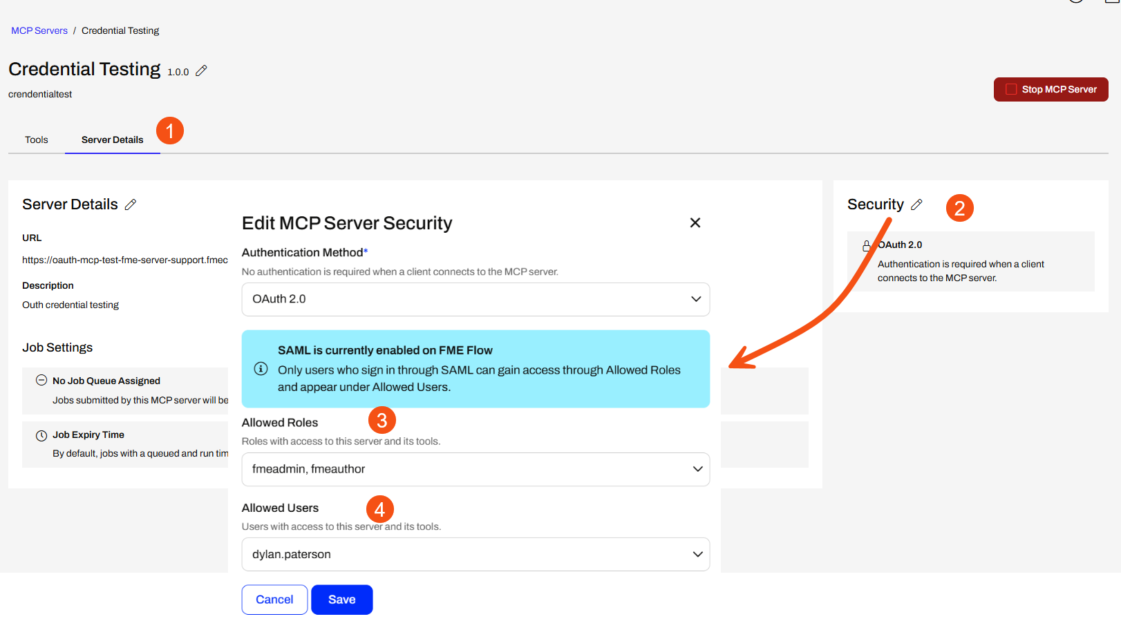

3. Register Allowed Users
On the MCP Server's Server Details tab, open the Security menu and add the SAML-provisioned user (and/or roles) from Part 2.

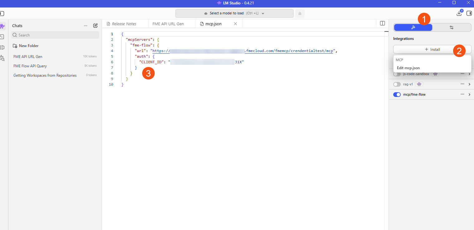

1. Add the MCP Server to LM Studio
In LM Studio, navigate to the Integrations pane, select Install > Edit mcp.json, and add an entry for your MCP Server, including an auth object containing the Client ID from Part 4:
"mcpServers": {
"fme-flow": {
"url": "https://<your-flow-host>/fmemcp/<server-name>/mcp",
"auth": {
"CLIENT_ID": "<your-client-id>"
}See LM Studio's MCP integration documentation for details.

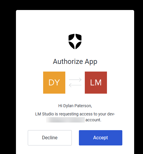

2. Complete the Browser Login

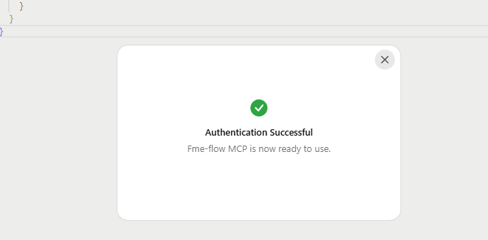

The MCP Server connection appears in the Integrations side pane. Expand it and select Authenticate. Your browser should open to the Auth0 login page. Sign in as the SAML user from Part 2 and click Accept on the authorization screen.
If authentication was successful, you should see an Authentication Successful message in LM Studio

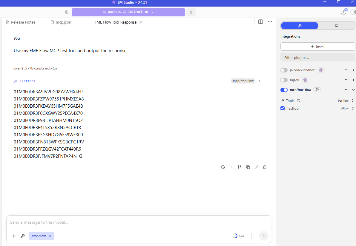

3. Verify and Run a Tool
On success, LM Studio shows the connection as ready and lists the server's tools. Confirm everything works end-to-end by invoking a tool in a chat and validating the response.

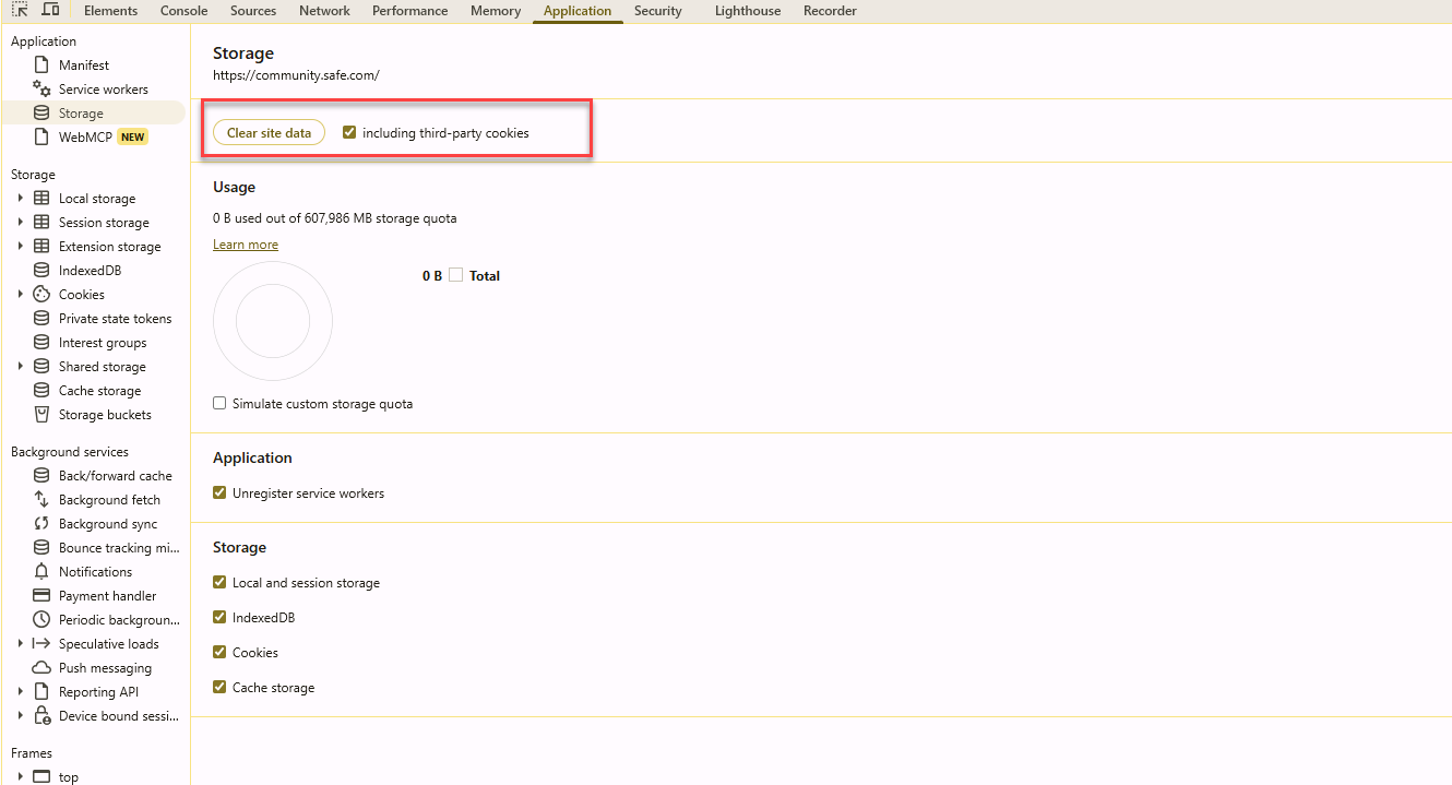

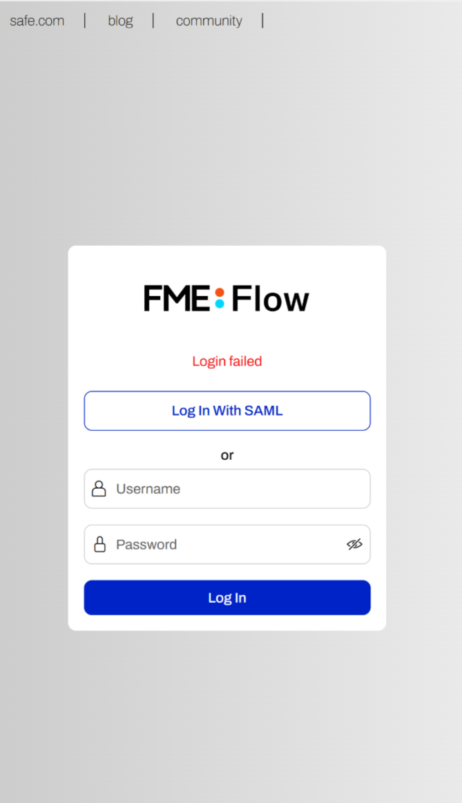

I’ve enabled SAML, but the FME login page returns Login Failed every time I try to log in.
You may need to clear the page's memory due to stale page data. Open the browser developer tools (F12 on most keyboards) and navigate to the Application tab. Check including third-party cookies and select Clear Site Data. Try the login again.
