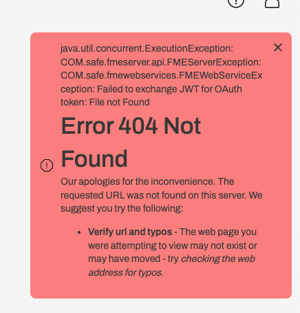

Example 2: Error 404 Not Found
Probable causes are related to the URLs used to register the Remote Engines Service.  Carefully review the URLs and the Account Name value used in Part 4, Step 3 in Getting Started with FME Remote Engines Service in Snowflake. The Account Name should be contained within the URL provided by the Snowflake App when you launched the FME Remote Engines Service App in Part 3: Launching Container.

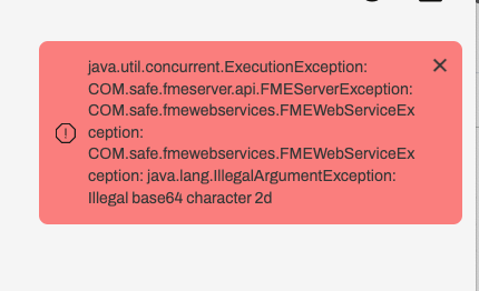

Illegal Argument Exception: Illegal base64 character
This is likely caused by the private key requiring a passphrase or by another issue related to decrypting it. Review how the public and private keys were created, ensuring that you followed the instructions in the Section called Requirements and Prerequisites, bullet 7.

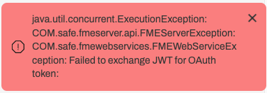

Failed to exchange JWT for OAuth token
Make sure that everything in the Snowflake Authentication section is filled out accurately. In particular, the Endpoint field should not include https:// at the start and shouldn’t end with a slash. Sample Endpoint URL: abcde-mycompany-az.snowflakecomputing.app
