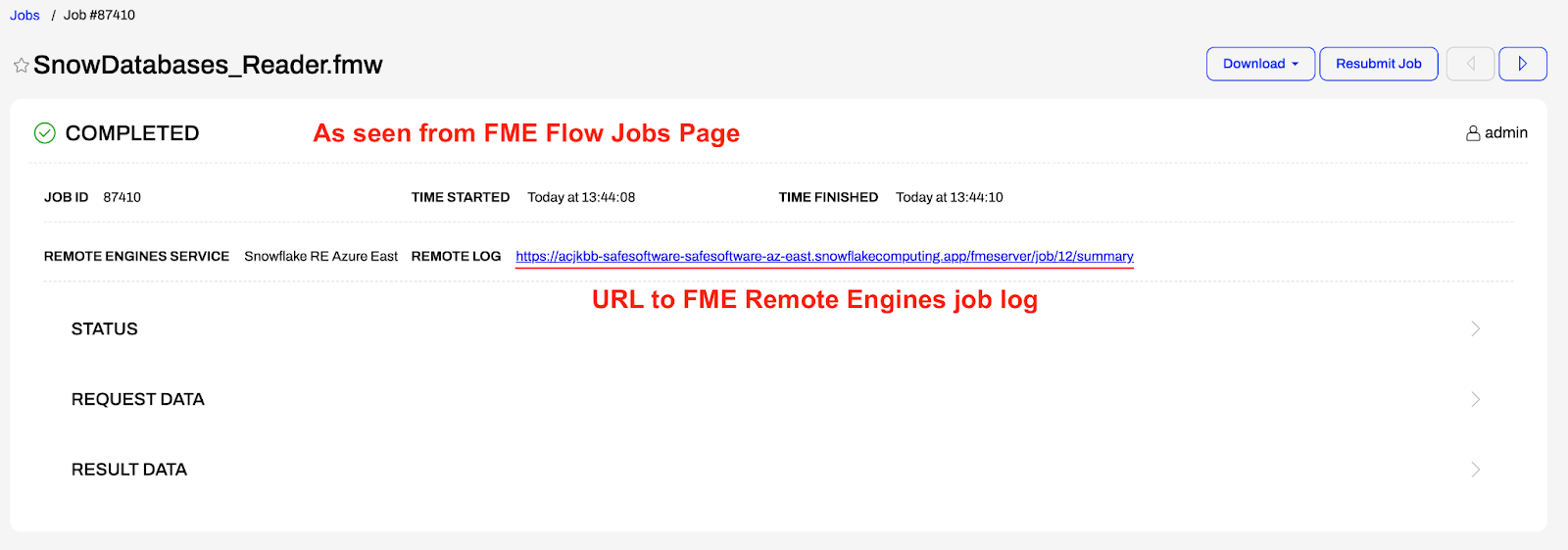

1. Publish the Workspace to the FME Flow environment as usual, ensuring the correct database connection is selected and uploaded during publishing. Once the workspace has been published, it can be tested by running the workspace.
2. Ensure the correct Queue is assigned when submitting the job. When the job is submitted, the Web UI confirms on the Completed Jobs page that it has been submitted to the FME Remote Engines Service.
You can easily access the Remote Engines Service Web UI by visiting the Completed Jobs page, locating the job, and then clicking on the URL.  This will take you to the login page for the FME Remote Engines Service Web UI, where you can review the job log.
Reviewing the job log for the remote engines is covered in Part 6 of Getting Started with Remote Engines Service for Snowflake.
Confirm the workspace results by opening the job log and verifying that the correct database connection type was used. Example:
Snowflake Reader: Creating connection using connection string 'jdbc:snowflake://mycompany-az-east.east-us-2.azure.snowflakecomputing.com' and properties '{schema="SUPPORT", tracing=OFF, application=SafeSoftwareFME, GEOGRAPHY_OUTPUT_FORMAT=WKB, warehouse="SUPPORT_WH", authenticator=oauth, account=MYCOMPANY_AZ_EAST, db="SUPPORT_DB", GEOMETRY_OUTPUT_FORMAT=EWKB, token=************}'
In the connection string above, you’ll see the following connection parameters: authenticator=oauth and token.  There will be no user parameter present.  This confirms that the workspace is connected to the database within the Application in Snowpark.

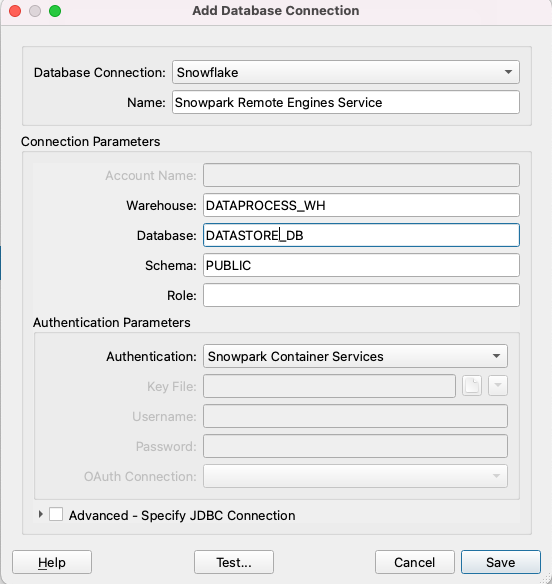

1. Creating a database connection for use in Snowpark
  • When creating a database connection for use with the FME Remote Engines Service, ensure the Authentication Type is set to Snowpark Container Services. Also, ensure that the Warehouse, Database, and Schema are all correctly set.
2. Do not set the Role in the database connection.
  • The Snowpark Database Connection will rely on grants given directly to the FME Remote Engine Service Application, as explained in Part 1.
  • The Container does not use a username or password to access the databases.

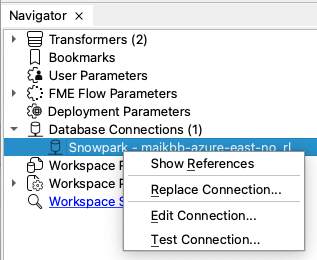

  • In FME Form, you can swap a Database Connection by right-clicking on it and replacing it with the Database Connection that contains the Snowpark Container Services authentication type.

Part 3: Snowflake Database Connections with Remote Engines
When creating a database connection for the FME Remote Engines Service in Snowflake, ensure you set the Authentication type to Snowpark Container Services, as shown below. This connection type is only compatible with the FME Remote Engines Service App in Snowflake.
Leave the Role parameter empty.
