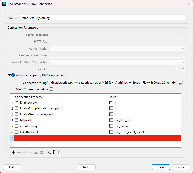

Here is a guideline:
  1. In FME Options>Database Connections, add a new Databricks (JDBC) database connection. Scroll down to the Advanced - Specify JDBC Connection then enable it to expand the configuration details.
  2. In the connection properties table, remove the existing lines for userAgentEntry, UID, and Password. Then add a new property: OAuth2Secret.
  3. Click the ... button next to “Connection String” to open the Text Editor. Paste the following, replacing the placeholders in the angle brackets with your actual values:
jdbc:databricks://<server-hostname>:443;SSL=1;AuthMech=11;Auth_Flow=1;OAuth2ClientId=<your-azure-client-id>;AzureTenantId=<your-azure-tenant-id>
  1. Fill in the connection properties table with your actual values for httpPath, connCatalog (your desired catalog name), and OAuth2Secret (your Azure client secret).
  2. Optionally, enable “Mask Connection Details” to prevent sensitive details from appearing in plain text in your FME logs.
  3. Click Test to verify FME can reach the server, then save the database connection before reading a table into FME, to confirm the connection is set up correctly.
Your connection should look similar to this:
Other configurations may still work. The steps above should serve as a guideline.
