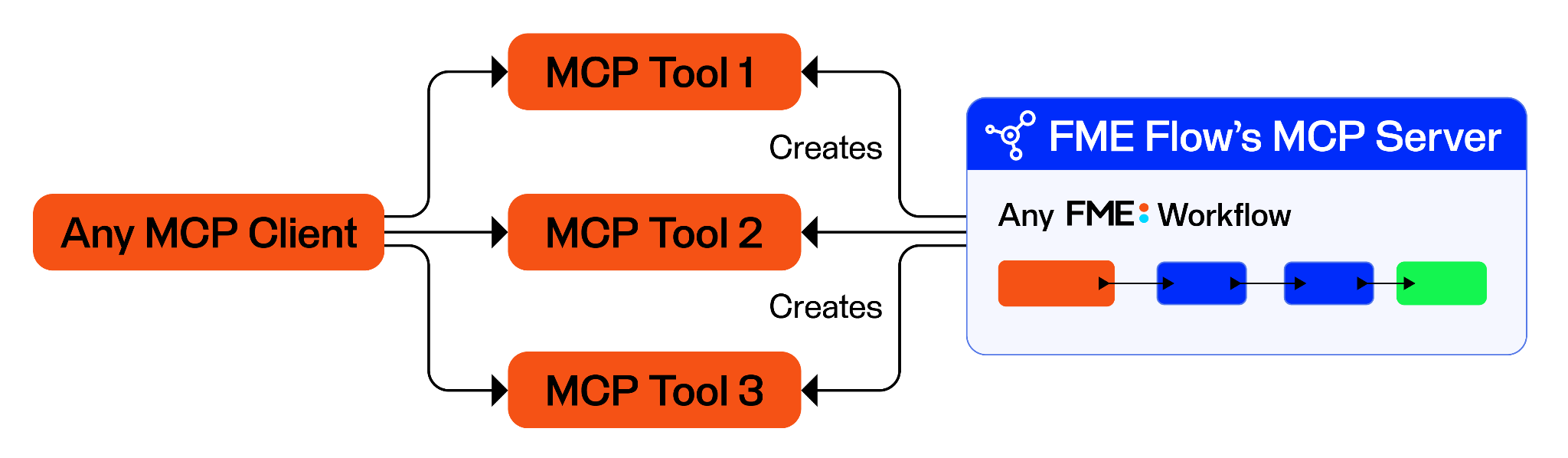

FME Flow's MCP server makes your FME workspaces available as callable tools.
This means an MCP client can run a workspace without needing to understand how the workspace is built, what systems it connects to, or which data formats it uses. The client simply discovers the available tool, provides the required inputs, and receives a structured response.
Those clients can include AI assistants, custom applications built on the MCP standard, or FME itself using the MCPCaller transformer. Existing workspaces can be registered as MCP tools without changing the workspace logic.
Because the tools run in FME Flow, they can perform the same kinds of operations as any other workspace, including reading, writing, updating, or deleting data. They also inherit FME Flow’s deployment options and security model. For example, an organization can run FME Flow on-premises or in a private cloud, allowing clients to work with governed data while the data remains inside controlled infrastructure.
A single FME Flow instance can host multiple MCP servers, so tools can be organized by team, project, or data domain.
