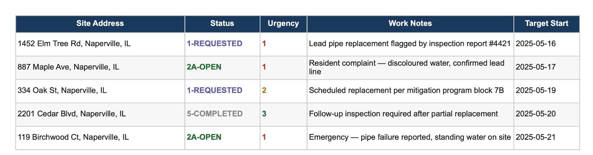

1. Review the Source Excel File
Open WorkOrders.xlsx in Excel or FME's Visual Preview. The file has two header rows and five data rows:
The column names in Row 1 come from the source system that generated the file. They won't match Trimble Unity's field names, and that's fine. FME handles the mapping inside the connector.

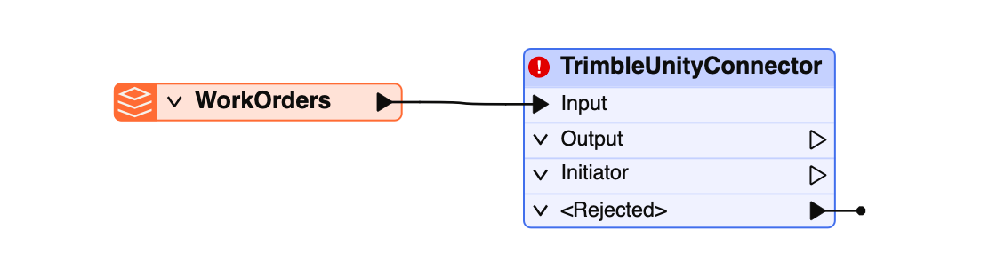

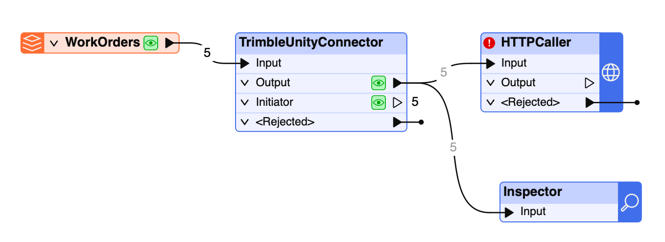

The finished workspace is straightforward: Excel Reader → TrimbleUnityConnector → Inspector. This part walks through setting it up step by step.
1. Open FME Workbench and Create a New Workspace
Start FME Workbench and click New to open a blank workspace.

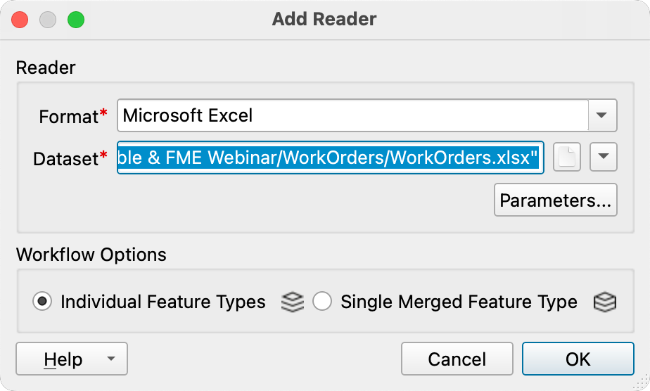

2. Add the Excel Reader
Drag the Excel file onto the canvas, or open the Add Reader dialog, set:
  • Format: Microsoft Excel
  • Dataset: WorkOrders.xlsx
    • Click on the ellipses to navigate to the location on your computer
Click OK.
3. Add the TrimbleUnityConnector
From the canvas, start typing "Trimble" and select TrimbleUnityConnector from the results. If you’ve never used it before, a download may start (from the FME Hub).
Connect the Excel reader's Output port to the connector's Input port.

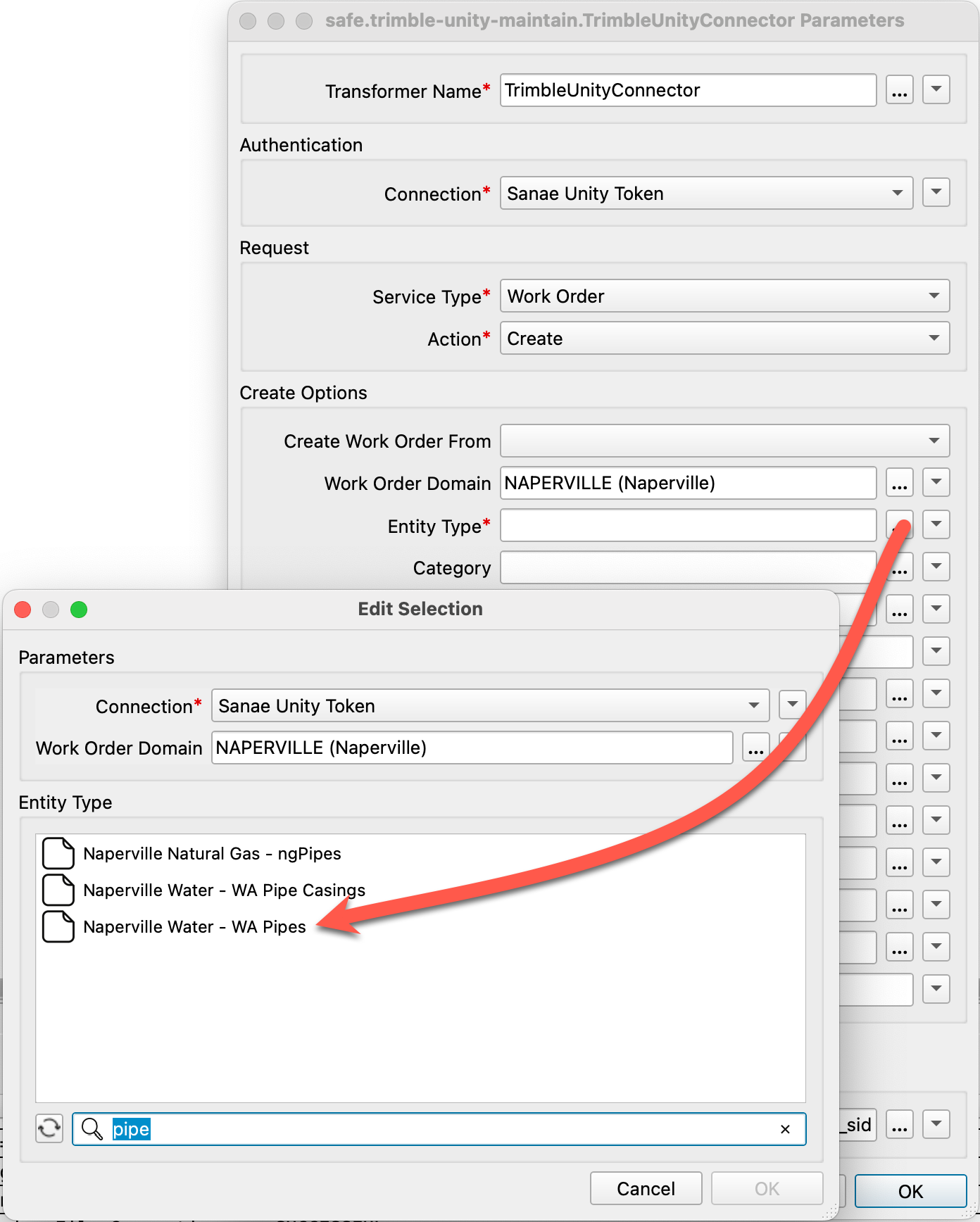

4. Configure the Web Connection

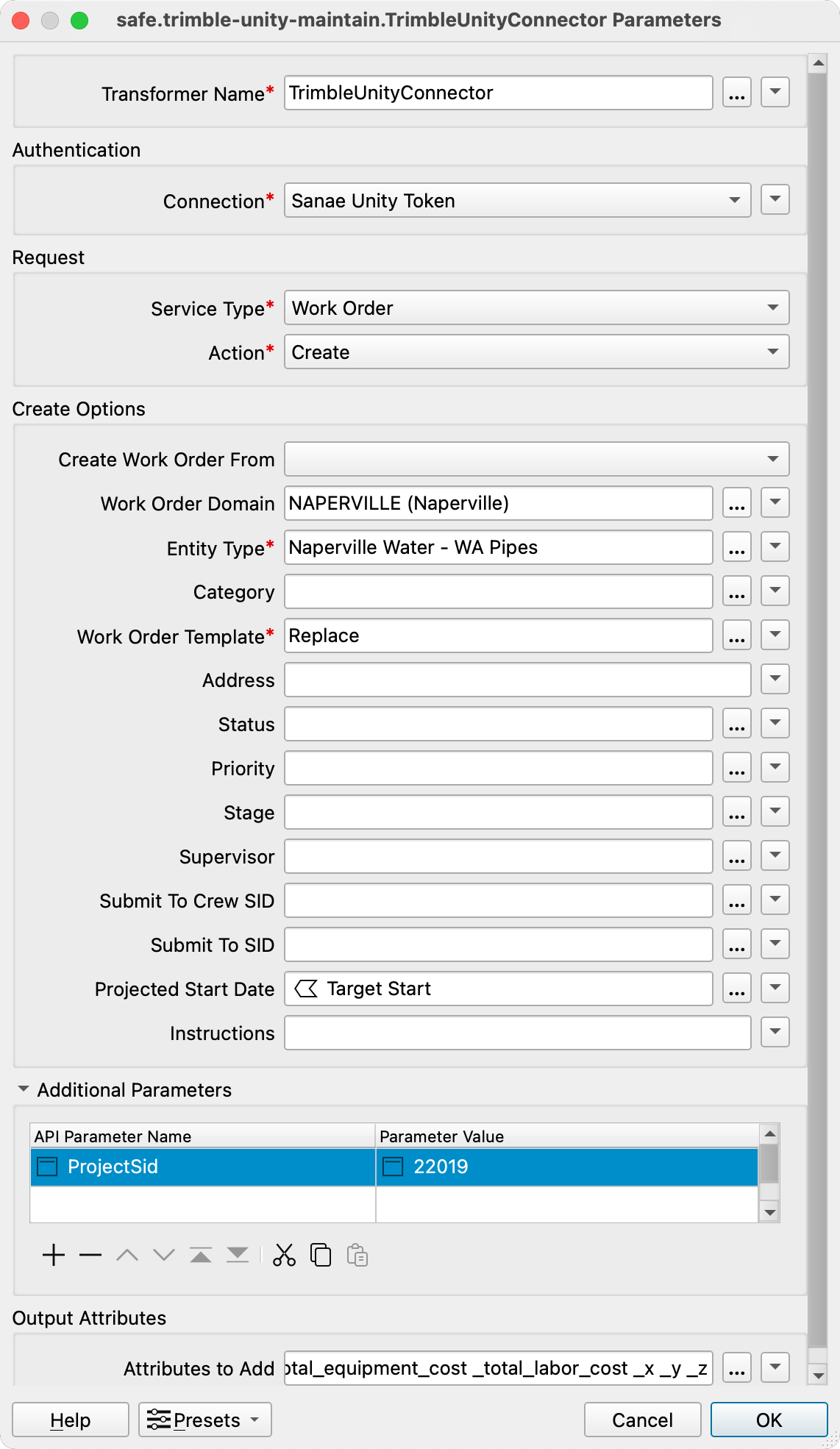

Double-click the TrimbleUnityConnector to open its parameters.
In the Connection field, click the dropdown and select your Trimble Unity Web Connection. If none is available, create one using your Trimble Unity credentials.
5. Set Service Type and Action
With the Web Connection set, configure the Request section:
  • Service Type: Work Order
  • Action: Create
The dialog updates to show the Create Options section with all available Work Order fields.
The same connector supports Case, Inspection, Service Request, and Work Order. For each type, available actions include Create, List, Update, Close, Cancel, and Delete. To automate updates or closures instead of creation, just select Update or Close from the Action dropdown. The field-mapping approach remains the same.
6. Configure Static Fields in the Connector
Some fields are the same for every Work Order in this batch. Click the “...” to see all options for your Trimble Unity configuration.
Set these directly in the connector dialog; they don't need to come from the Excel data. For example:
  • Domain: NAPERVILLE (Naperville)
  • Entity Type: Naperville Water - WA Pipes
  • Work Order Template: Replace
This tutorial uses the Naperville demo configuration, so the template and entity type names shown here are specific to that instance. Your dropdown options will reflect your own Trimble Unity setup. Choose whatever template and entity type match your project.
7. Map Per-Row Fields from the Excel Attributes
For fields that vary per row, click the dropdown next to each field and select the matching Excel attribute:
  • Address: Site Address
  • Status: Status
  • Priority: Urgency
  • Projected Start Date: Target Start
FME reads the value from the Excel attribute for each feature (row) and passes it to the corresponding Trimble Unity field when creating the Work Order.
8. Add ProjectSid via Additional Parameters
The Trimble Unity API is extensive, and some fields are not exposed directly in the connector dialog. Use the Additional Parameters section to pass these. Expand the Additional Parameters section at the bottom of the dialog and add a row:
  • API Parameter Name: ProjectSid
  • Parameter Value: 22019
This value is hardcoded; the same ProjectSid applies to every Work Order in this batch.
Note: Additional Parameters accepts any Trimble Unity API field name. If you need to populate a field that is not shown in the connector dialog, add it here. Refer to the Trimble Unity API documentation or your instance's developer console for the full list of parameter names.
Review the TrimbleUnityConnector configuration:

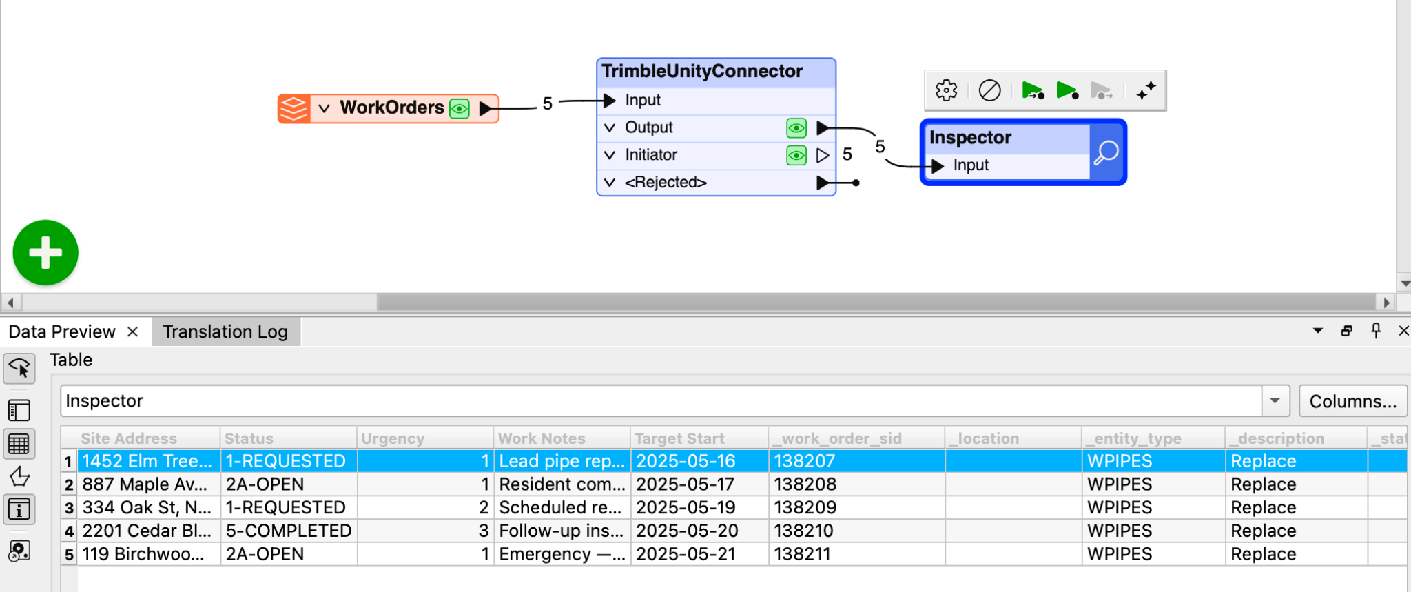

9. Add an Inspector and Run
Add an Inspector transformer connected to the TrimbleUnityConnector output port. Also note the Rejected port: any features that fail the API call (invalid field values, authentication errors) will appear there with a descriptive error message.
Click Run Workspace. FME reads each Excel row, sends one API call to Trimble Unity per feature, and routes the response to the Inspector.
Open the Inspector on the Output port. Each feature represents a successfully created Work Order. A key output attribute to check is _work_order_sid. Its value will correspond to the work order record in Trimble Unity/Cityworks.
Note that the “Work Notes” have not been used yet. This is because Work Order “Comments” are not built into the TrimbleUnityConnector and must therefore be configured via a custom API request.

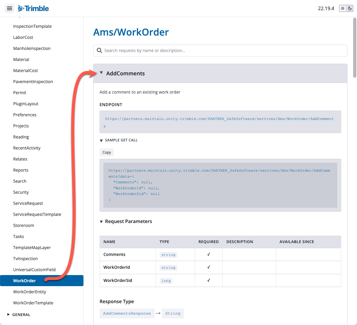

1. Identify the API Endpoint
Check the Trimble Unity API reference for your instance to find the endpoint and request format for adding a Work Order comment. You will need:
  • The HTTP method (typically POST)
  • The endpoint URL, which will include the Work Order SID returned by the connector (stored in the _work_order_sid attribute)
  • The expected request body format (usually JSON)
  • Any required headers, including Authorization

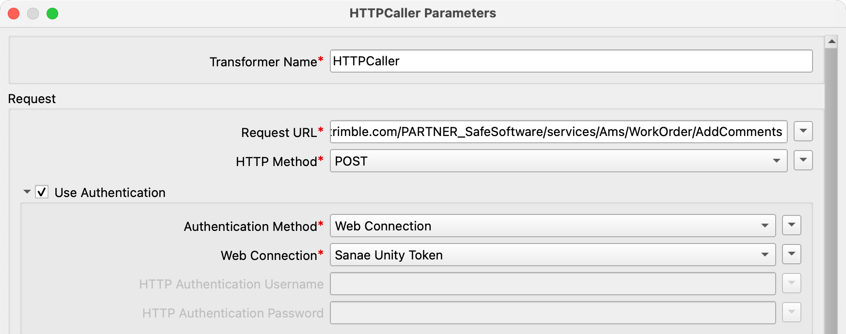

2. Add the HTTPCaller to the Canvas
In the transformer search bar, type HTTPCaller and add it to the canvas. Connect the TrimbleUnityConnector's Output port to the HTTPCaller's Input port. This means the HTTPCaller runs once per feature, receiving the Work Order SID from the connector for each row.
3. Configure the Request URL
Double-click the HTTPCaller to open its parameters. In the Request URL field, enter the comment endpoint URL.
Example: https://your-instance.trimbleunity.com/Ams/WorkOrder/AddComments
Replace the base URL with your instance's address and adjust the path to match the endpoint your API reference specifies.
4. Set the HTTP Method and Authentication
Set the HTTP Method to POST (or whichever method the endpoint requires). For authentication, use your Trimble Unity Web Connection.

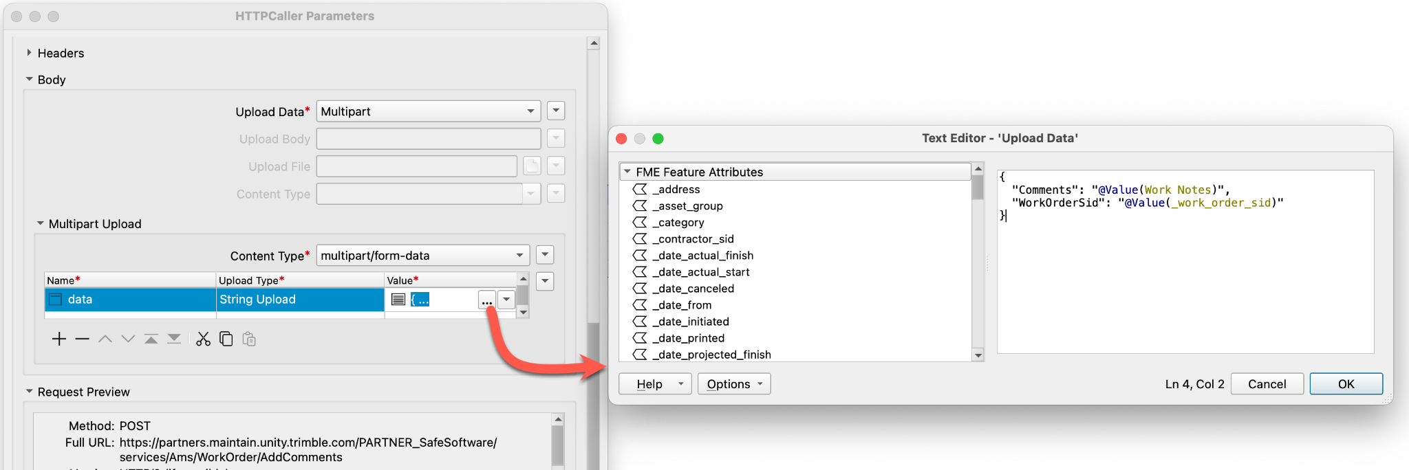

5. Set the Request Body
In the Body section, set the Upload Data to “Multipart”
In the Multipart Upload form:
  • Content Type: multipart/form-data
  • Name: data
  • Upload Type: String Upload
  • Value: {"Comments": "@Value(Work Notes)","WorkOrderSid": "@Value(_work_order_sid)"}

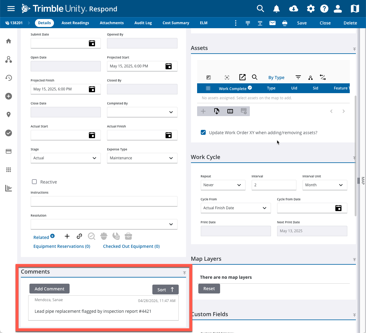

6. Inspect the Response and Run

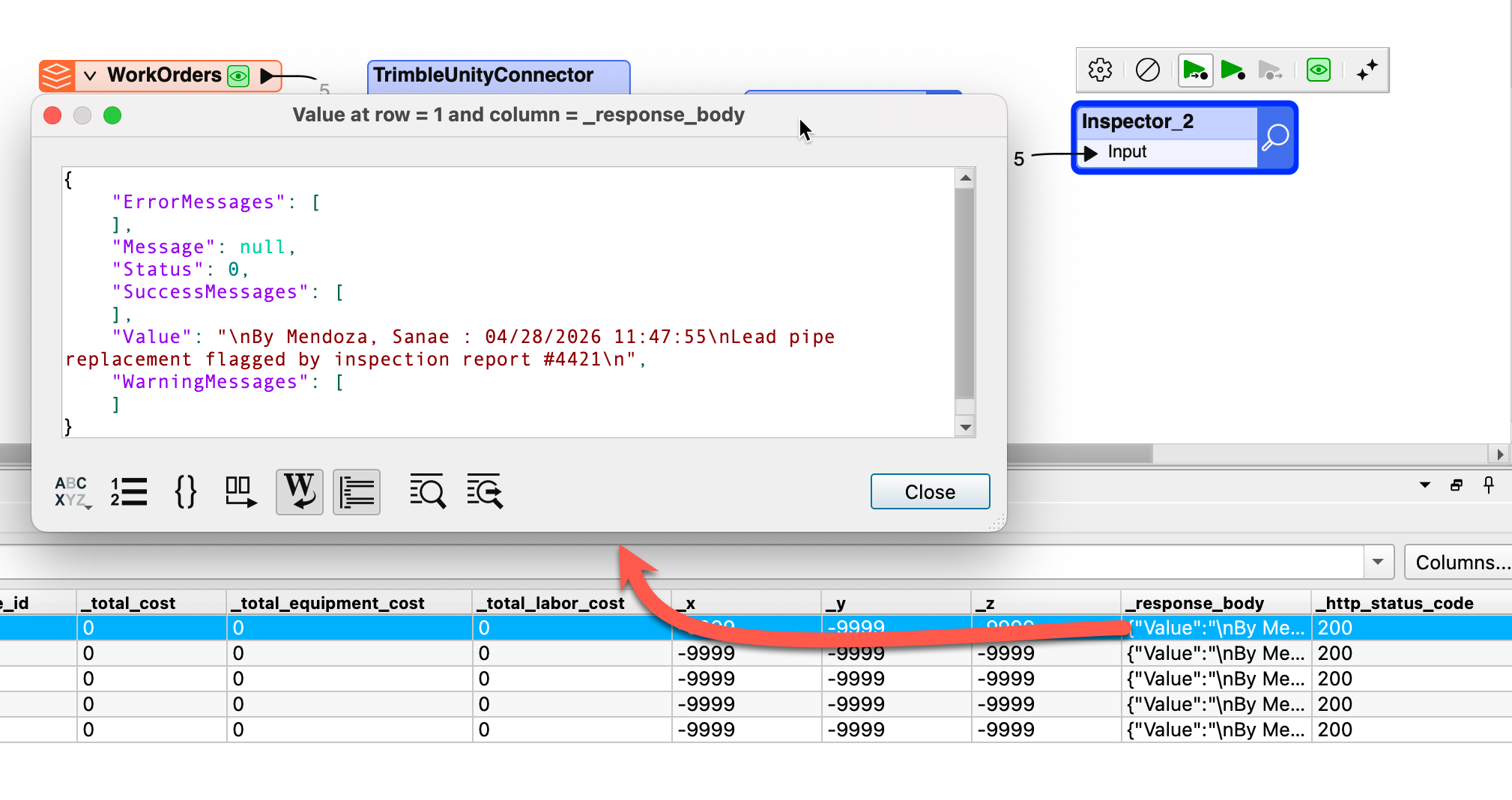

Add another Inspector connected to the HTTPCaller Output port. Run the workspace. For each Work Order created in Part 2, the HTTPCaller posts a comment and returns the API response as attributes on the feature.
Check the response_body attribute in the Inspector to confirm the comment was accepted. If any calls fail, they appear on the HTTPCaller's Rejected port with the HTTP status code and error message.
You can also verify the Work Order and comments in Trimble Unity using the Work Order ID.
