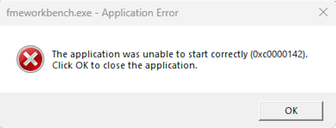

When launching FME Workbench for the first time, users may run into the error message:
The application was unable to start correctly (0xc0000142).
Click OK to close the application.
