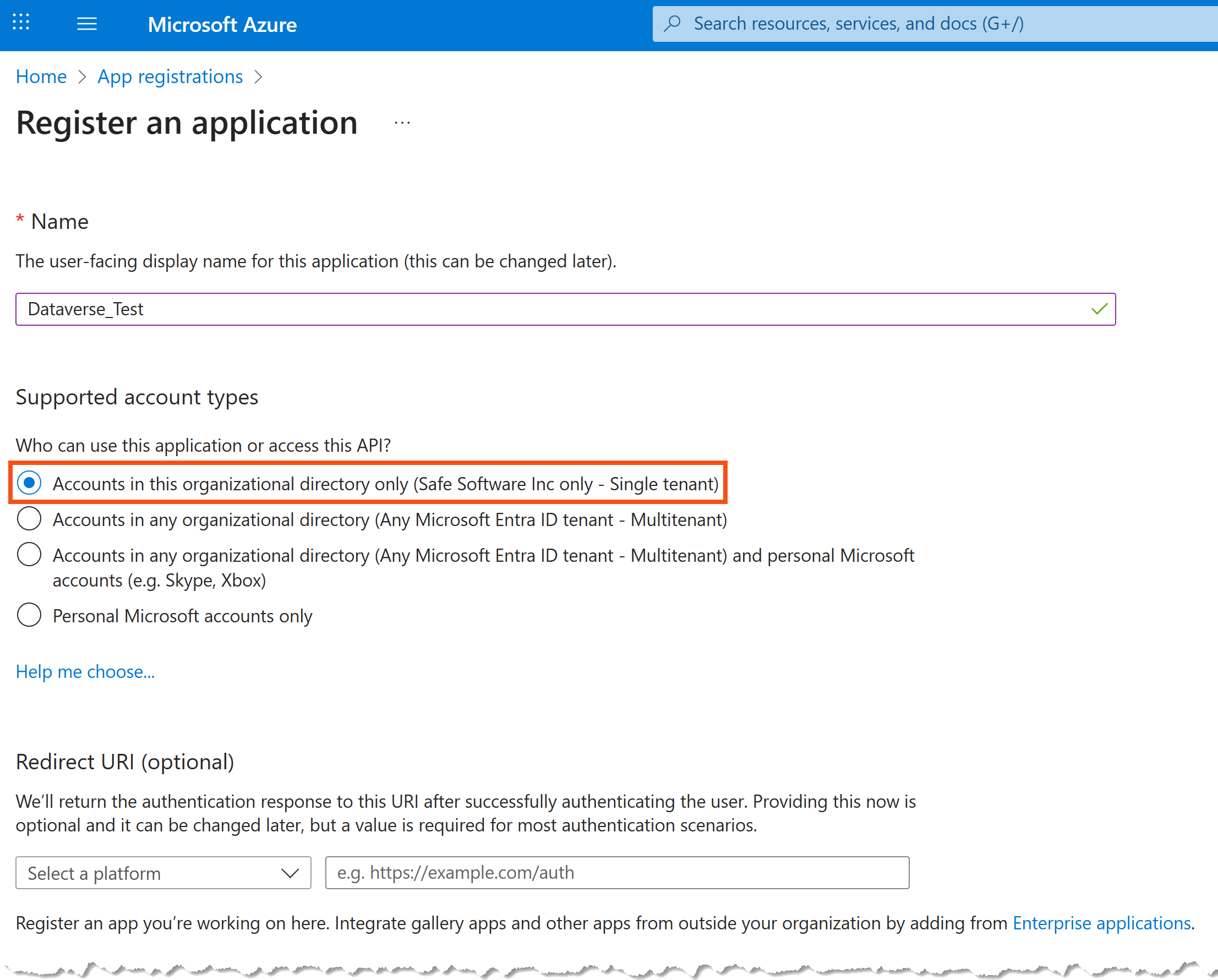

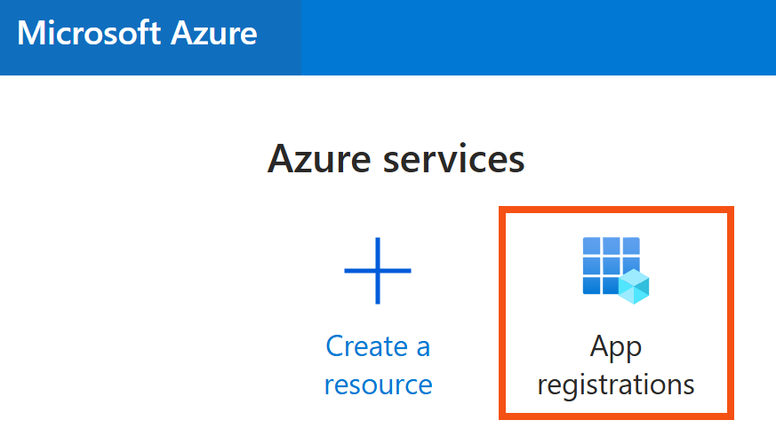

1. Register an App in the Azure Portal

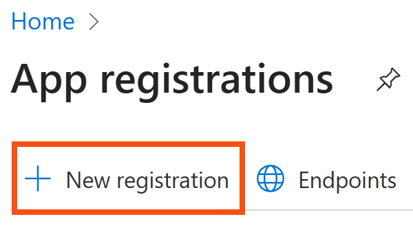

Sign in to the Azure Portal and go to App Registrations.
Click on New registration.
Provide a Name for the application and select “Accounts in this organizational directory only (single tenant)”. Leave the Redirect URI blank for now, we will update this in a later step.
Click Register.

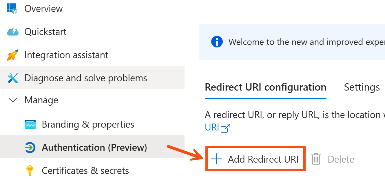

On the newly created App, select Authentication and then click on “Add Redirect URI”.

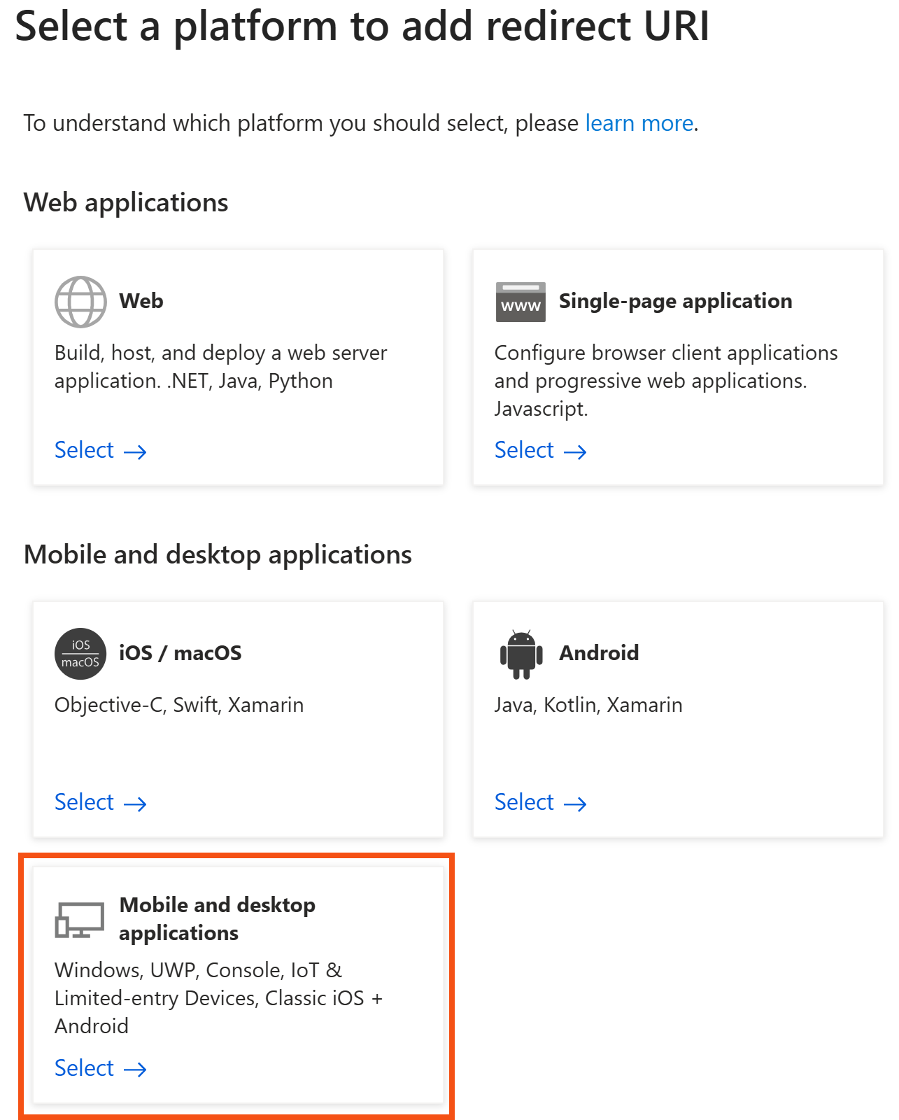

From the Platform ribbon, click on Mobile and Desktop Applications.

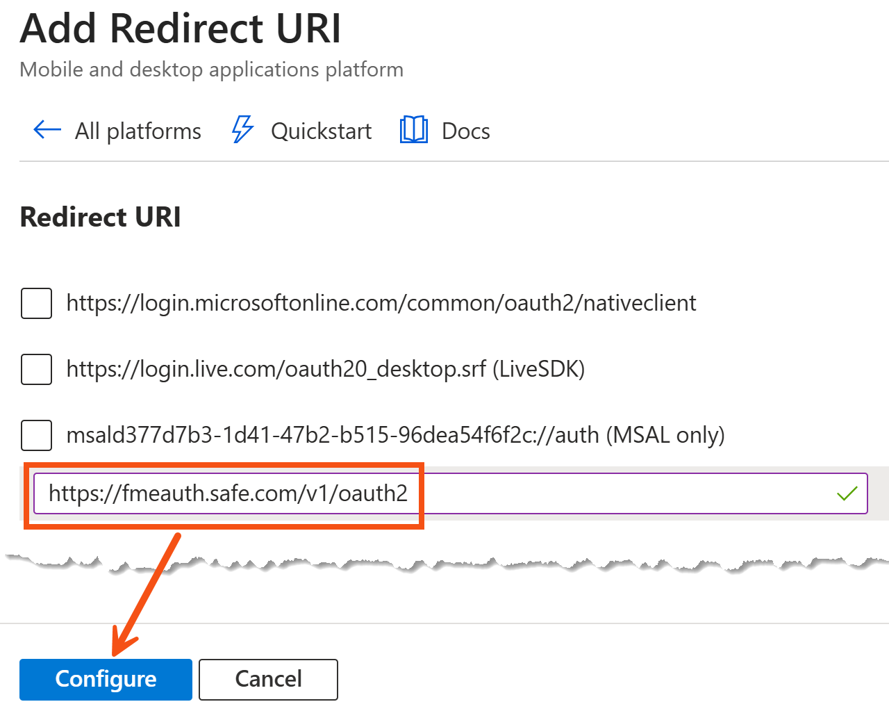

For a Custom redirect URI, enter:
https://fmeauth.safe.com/v1/oauth2
The redirect URI https://fmeauth.safe.com/v1/oauth2 is used in FME 2025.2+ to authorize the web connection in an external browser. This is the recommended approach. To learn more, please read External Browser Authentication. For older versions of FME that still use an embedded browser, you can use http://localhost as the redirect URI.
After entering the URL, click Configure.

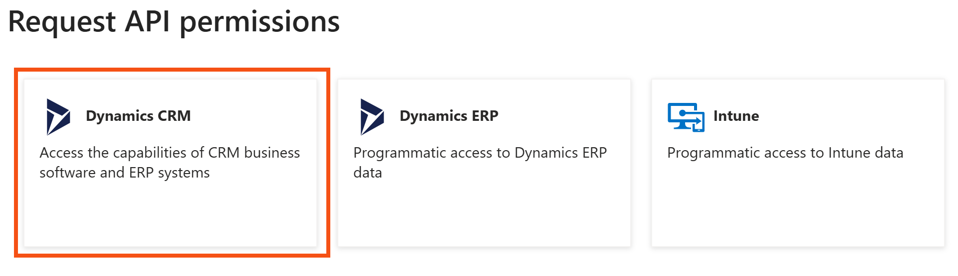

3. Configure the Permissions
API permissions allow the application to request access tokens and act on behalf of the signed-in user when accessing Microsoft Dataverse.

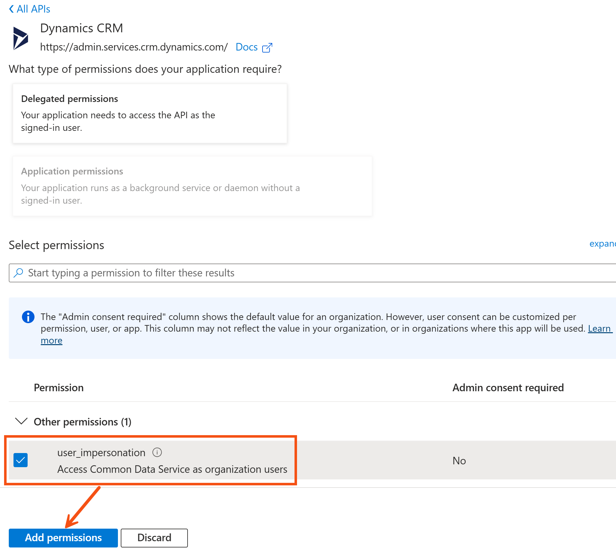

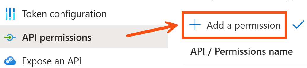

On the app, select API Permissions. Click Add a permission.
In Request API Permissions, scroll down to Dynamics CRM under Microsoft APIs.
Enable user.impersonation permission and click Add permissions

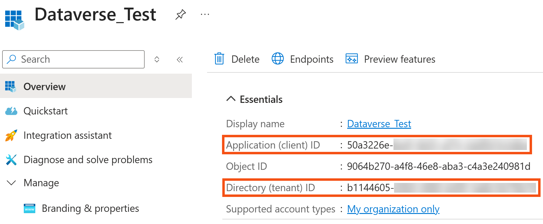

Note the Application (Client) ID and the Directory (Tenant) ID, which can be found on the app’s Overview page. These will be used to configure the web service in the later steps.

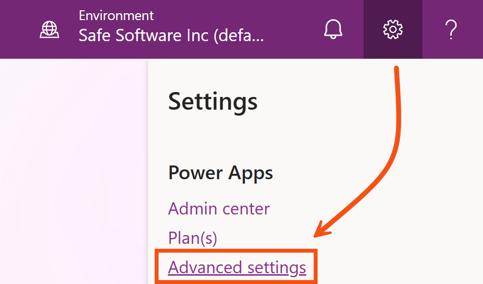

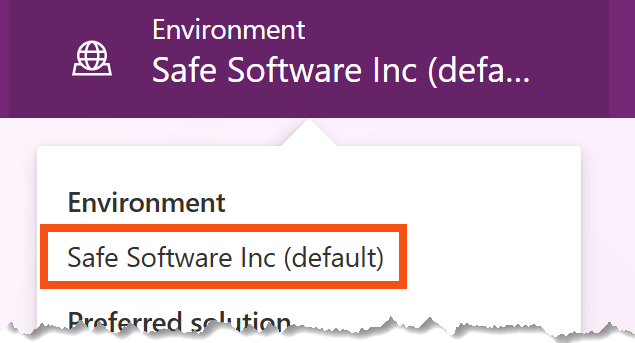

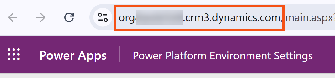

Log in to Power Apps and make sure the correct Environment is selected in the top banner.
Click the Settings icon and select Advanced settings.
This will open Power Platform Environment Settings. The base URL shown in the browser address bar is your Environment URL.

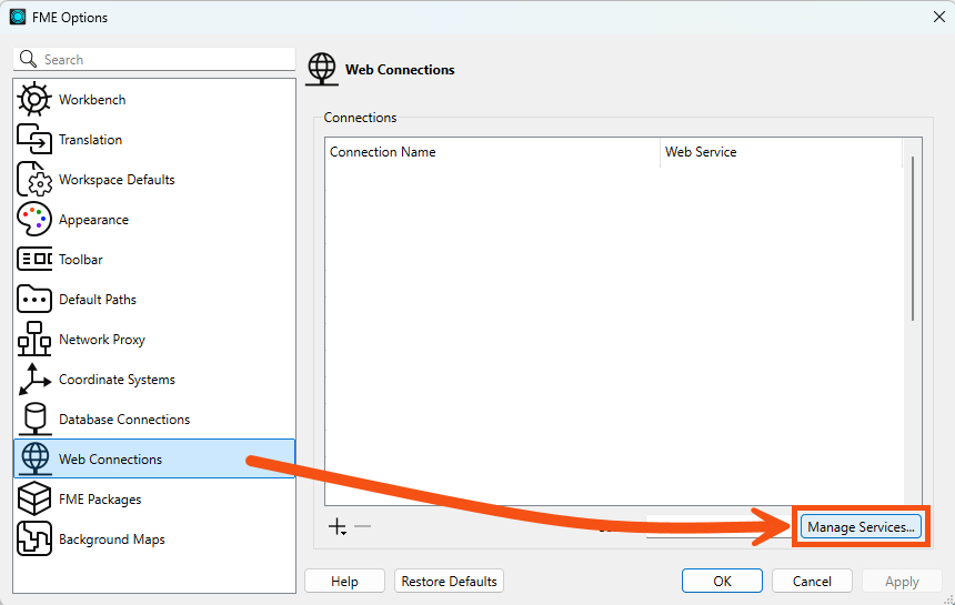

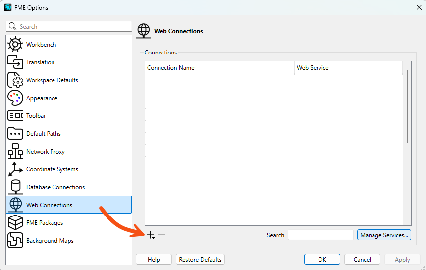

Open FME Form and go to Tools > FME Options > Web Connections > Manage Services.

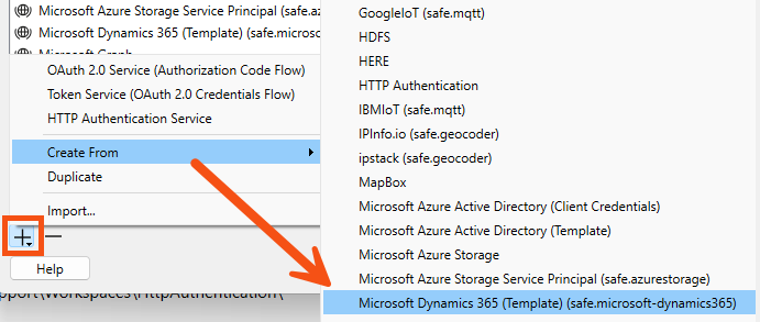

On the Manage Web Services window, click the plus sign below the list of web services and then select Create From > Microsoft Dynamics 365 (Template) (safe.microsoft-dynamics365)

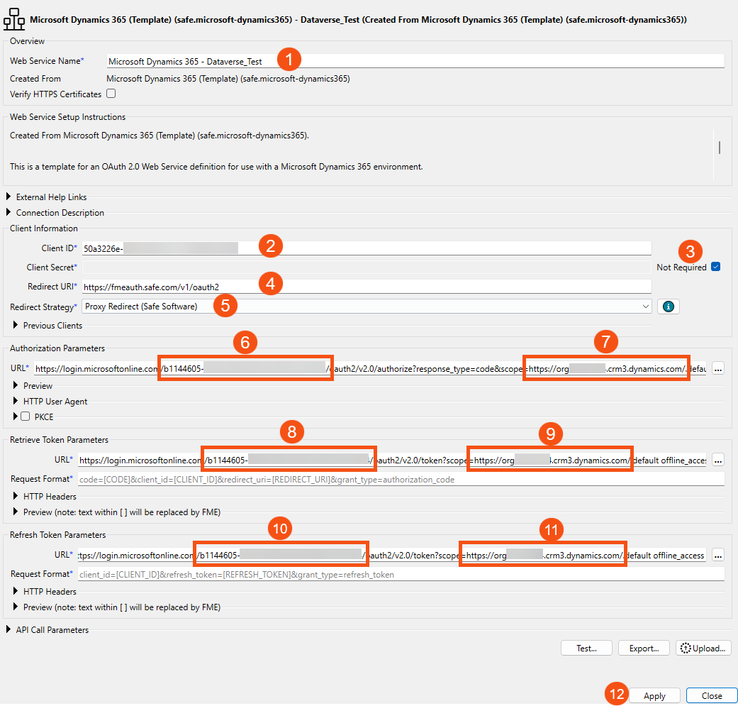

2. Configure the Web Service parameters
This section configures the parameters required for FME to authenticate against the Azure tenant and connect to the Power Platform environment.
Single tenant Azure app registrations must use tenant specific endpoints. The /common endpoints are intended for multi tenant applications and should be replaced with your Directory (tenant) ID.
Configure the parameters as follows:
  1. Web Service Name: Provide a unique name. It is recommended to include the transformer that this web service will be used for and the Azure app registration name, so the service can be easily identified later.
  2. Client ID: Enter the Application (client) ID from the Azure App.
  3. Not Required: leave this checked. Client secrets are only required when configuring this connection in FME Flow.
  4. Redirect URI: Enter the Redirect URI that matches your Azure App Registration.
It’s important to ensure that the web service’s Redirect URI value matches the custom redirect URI that was applied to the Azure registered application in Create the Azure App Registration step 2. If these two values do not match, the web service will not function properly.
  1. Redirect Strategy: Select 'Proxy Redirect (Safe Software)'. This uses your system browser to complete authentication. Note: This option is not available in versions of FME prior to 2025.2, which use the embedded browser.
  2. Authorization Parameters URL: Replace common with your Tenant ID
  3. Authorization Parameters URL: Replace [ENVIRONMENT_URL] with your Power Apps environment URL.
  4. Retrieve Token Parameters URL: Replace common with your Tenant ID
  5. Retrieve Token Parameters URL: Replace [ENVIRONMENT_URL] with your Power Apps environment URL.
  6. Refresh Token Parameters URL: Replace common with your Tenant ID
  7. Refresh Token Parameters URL: Replace [ENVIRONMENT_URL] with your Power Apps environment URL.
  8. Click Apply to save all the values

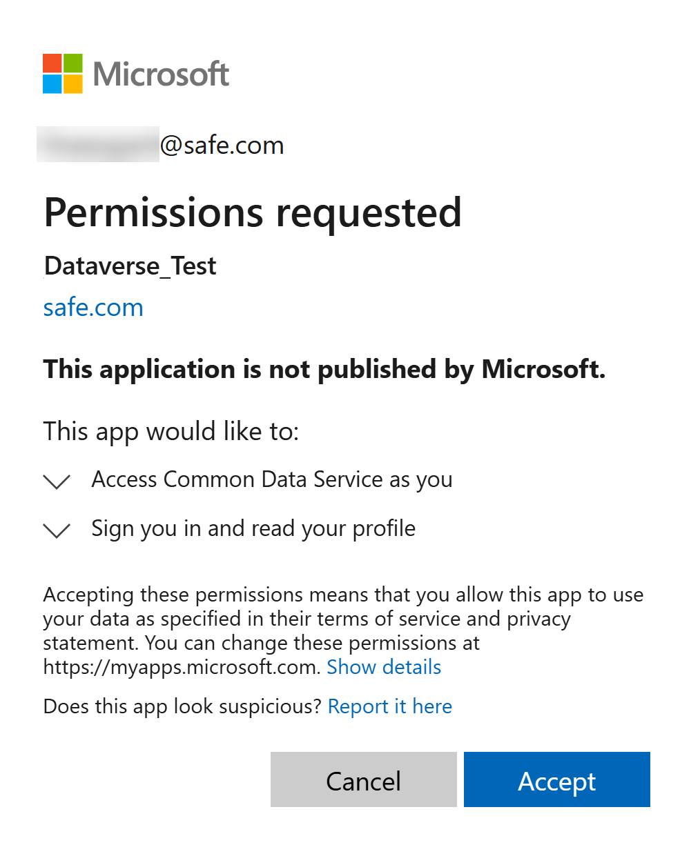

This will open a browser window to authorize the web service. When prompted, sign in using your Microsoft organizational account. If Microsoft prompts you to grant permissions to the Azure app, click Accept.

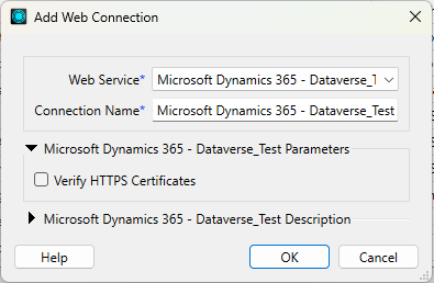

4. Create the Web Connection
In the Web Connections menu, click the plus (+) button to add a new connection.
On the Add Web Connection window, select the web service you created from the dropdown. Give the connection a unique name and click OK.
You will be prompted to authenticate with Microsoft again.
Once the Web Connection is successfully authenticated, it can be used with the Microsoft Dynamics 365 Sales Reader and Writer transformers to read and write Dataverse table data.
