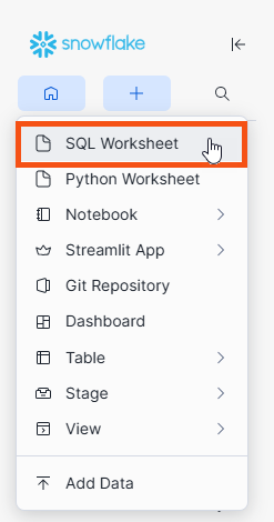

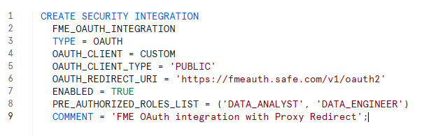

1. Connect to Snowflake and Create the Security Integration
In Snowflake, from the top left of the page, create a new SQL Worksheet:
  •  “+” →  Create
This opens a Snowflake worksheet where you can execute SQL commands to create a Security Integration. Here's an example command to create the security integration:
CREATE SECURITY INTEGRATION
  FME_OAUTH_INTEGRATION
  TYPE = OAUTH
  OAUTH_CLIENT = CUSTOM
  OAUTH_CLIENT_TYPE = 'PUBLIC'
  OAUTH_REDIRECT_URI = 'https://fmeauth.safe.com/v1/oauth2'
  ENABLED = TRUE
  PRE_AUTHORIZED_ROLES_LIST = ('DATA_ANALYST', 'DATA_ENGINEER')
  COMMENT = 'FME OAuth integration with Proxy Redirect';
Some key parameters in this example include:
  • FME_OAUTH_INTEGRATION: A unique name for your security integration (you can change this to any other descriptive name)
  • TYPE = OAUTH: A required parameter to describe the type of authentication this integration is in Snowflake
  • OAUTH_CLIENT = CUSTOM: Required parameter to allow FME to connect as a custom OAuth client
  • OAUTH_CLIENT_TYPE = 'PUBLIC': The type of OAuth Client
    • For FME Form, keep this as ‘PUBLIC.’
    • Change this to ‘CONFIDENTIAL’ in FME Flow deployments where secrets can be securely stored server-side
  • OAUTH_REDIRECT_URI: Must exactly match what FME sends during authentication
    • For Proxy Redirect in Form: https://fmeauth.safe.com/v1/oauth2
    • For FME Flow: You'll update this later to your Flow-specific URL: https://<your-fme-flow-url>/fmeoauth
  • PRE_AUTHORIZED_ROLES_LIST: Defines which Snowflake roles users can access through this integration
For complete parameter documentation, see Snowflake’s guide: CREATE SECURITY INTEGRATION (Snowflake OAuth).

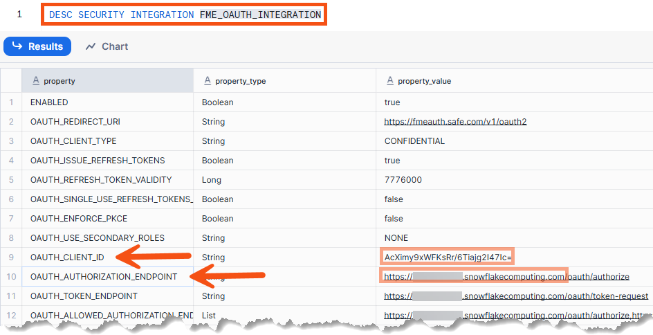

2. Retrieve OAuth Client Credentials
After creating the security integration, you need to retrieve the Custom Client details, like the Client ID that Snowflake generated. In a new worksheet, execute:
DESC SECURITY INTEGRATION FME_OAUTH_INTEGRATION;
Replace FME_OAUTH_INTEGRATION with your security integration name if necessary.
In the results, take note of the values of:
  • OAUTH_CLIENT_ID - This is the Client ID that you'll use in FME
  • Your Snowflake Account URL - This shows your account URL often in the form: https://<your-company>.snowflakecomputing.com
    • In OAUTH_AUTHORIZATION_ENDPOINT, the account URL is everything before /oauth/authorize in the Authorization Endpoint.
You’ll also be able to confirm your Redirect URI under the property OAUTH_REDIRECT_URI.

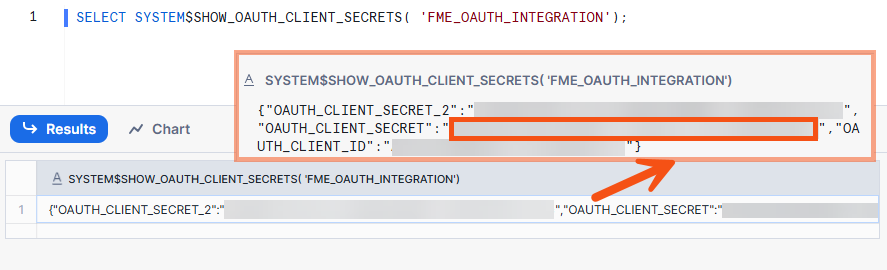

3. Retrieve the Client Secret
Next, retrieve the Client Secret by executing:
SELECT SYSTEM$SHOW_OAUTH_CLIENT_SECRETS('FME_OAUTH_INTEGRATION');
Replace FME_OAUTH_INTEGRATION with your security integration name.
You’ll receive two Client Secrets by default. Either value should work with FME. For this example, copy the value saved between the quotation marks for OAUTH_CLIENT_SECRET.
A second Client Secret is provided by Snowflake to allow for easy secret rotation. For more information, review Snowflake’s Control documentation.
Be sure to store this Client Secret securely. You'll need it to configure FME, and you won't be able to retrieve it again through the Snowflake UI (though you can regenerate a new one if needed).

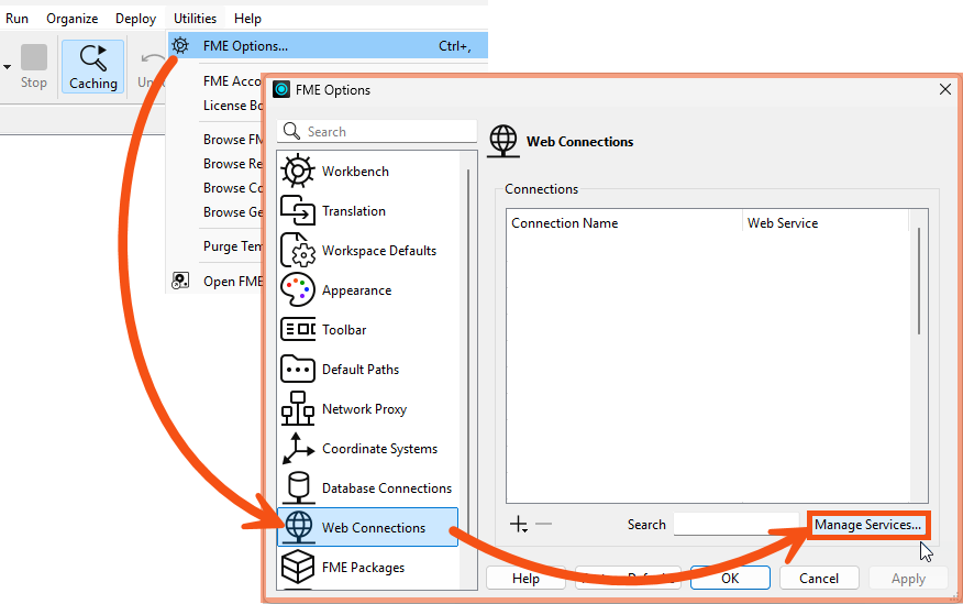

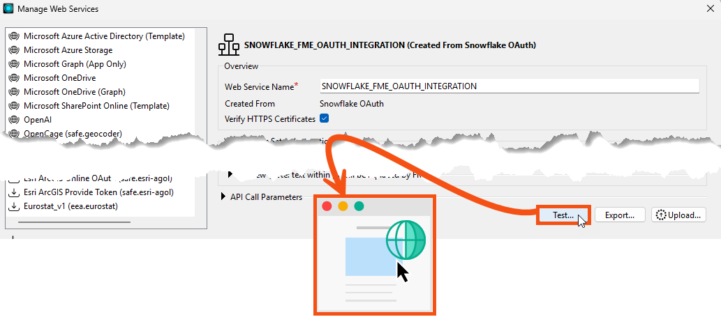

1. Open FME Workbench and Navigate to Manage Services
In FME Workbench, navigate to:
  • Utilities → FME Options → Web Connections → Manage Services…
This opens the Manage Web Services dialog, where you can configure OAuth services
2. Add a Web Connection to Snowflake

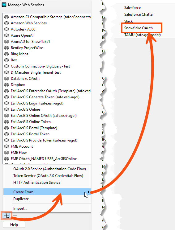

  • In the Manage Web Services dialog, click the "+" symbol → Create From → Snowflake OAuth

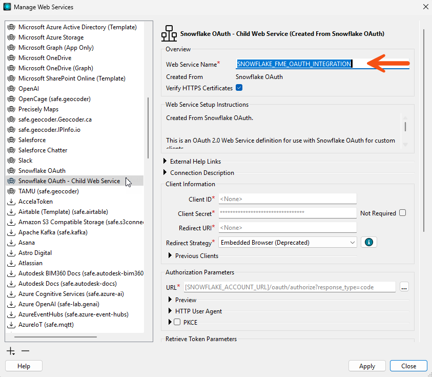

This creates a child (copy) web service based on the Snowflake OAuth template. Give your web service a descriptive name that reflects your specific integration, for example: SNOWFLAKE_FME_OAUTH_INTEGRATION
Use a naming convention that helps you identify this service later, especially if you'll have multiple Snowflake connections.

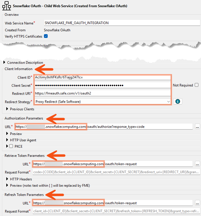

3. Configure the OAuth Web Service Parameters
Now you'll fill in the OAuth web service configuration using the credentials you retrieved from Snowflake. Parameters marked with a red asterisk are required. Here's how to configure each section:
  • Client Information
    • Client ID: Paste the Client ID from your Snowflake DESC SECURITY INTEGRATION command (Part 1, Step 2)
    • Client Secret: Paste the Client Secret from the SYSTEM$SHOW_OAUTH_CLIENT_SECRETS command (Part 1, Step 3)
    • Redirect Strategy: Select Proxy Redirect (recommended)
      • The Redirect URI field will automatically populate with https://fmeauth.safe.com/v1/oauth2
  • Authorization Parameters
    • URL: Enter your Snowflake Account URL: https://<your-company>.snowflakecomputing.com
      • This is the base URL you noted from the OAUTH_AUTHORIZATION_ENDPOINT in Part 1, Step 2
  • Retrieve Token Parameters
    • URL: Enter the same Snowflake Account URL: https://<your-company>.snowflakecomputing.com
  • Refresh Token Parameters
All three URL fields (Authorization, Retrieve Token, and Refresh Token) should contain your Snowflake Account URL, however, FME does append the Refresh Token Parameters with the appropriate URL automatically.

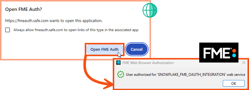

4. Test the Connection
Before saving, verify your configuration works by clicking Test at the bottom of the web service configuration dialog.

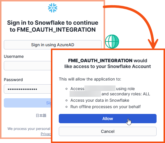

Your system's default browser will then open to Snowflake's authentication page. This happens outside of FME when using Proxy Redirect or Loopback strategies.
Complete the authentication flow:
  1. Log in with your Snowflake credentials
  2. If MFA is enabled for your account, complete the MFA challenge
  3. If prompted, consent to the requested role access
Once authentication succeeds in your browser, a pop-up will appear. Click Open FME Auth. You should see a confirmation message: "User authorized for… web service"
If the test succeeds, click OK.

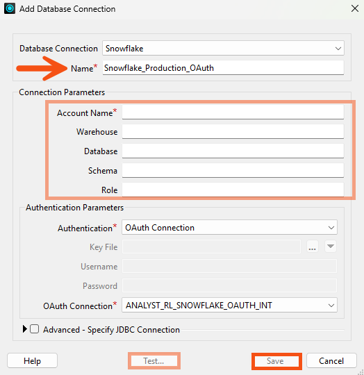

5. Add a Snowflake Database Connection
Now that your web service is configured, you'll create a database connection that uses this OAuth web service for authentication.

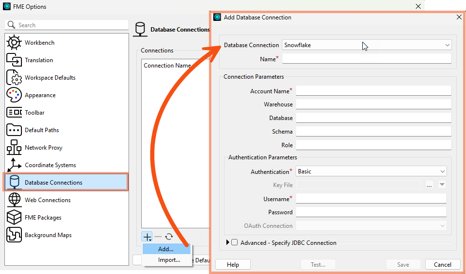

After saving and closing the Manage Web Services dialog, stay in the FME Options window and navigate to:
  • Database Connections → "+" → Add
In the Add Database Connection dialog, select Snowflake from the list of available database formats.

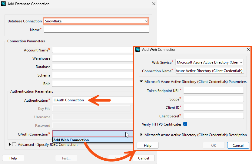

6. Link the Database Connection to Your OAuth Web Service
In the Add Database Connection dialog, configure the authentication.

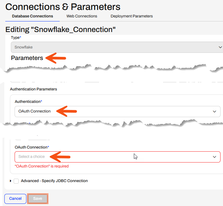

  • Authentication Parameters
    • Authentication: Select OAuth Connection from the dropdown

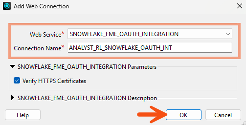

    • OAuth Connection: Click Add Web Connection
This opens the Add Web Connection dialog.
In the Add Web Connection dialog, configure it as follows:
  • Web Service: Select your newly created Snowflake OAuth web service
    • Example: SNOWFLAKE_FME_OAUTH_INTEGRATION
  • Connection Name: Give this web connection a descriptive name
    • Example: ANALYST_ROLE_SNOWFLAKE_OAUTH
    • This name should reflect the role or purpose of this specific connection
Click OK to save the web connection.
FME will prompt you to authenticate this web connection, similar to when you tested the web service. Your browser will open, and you'll complete the Snowflake authentication flow again.

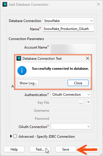

7. Complete the Database Connection Configuration
After authenticating the web connection, you'll return to the Add Database Connection dialog. Complete the remaining Snowflake-specific parameters. Required ones being highlighted with a red asterisk:
  • Name: A descriptive name for this database connection (e.g., Snowflake_Production_OAuth)
  • Account Name: Your Snowflake account identifier (e.g., orgname-account123)
  • Warehouse: The Snowflake virtual warehouse you want to use (e.g., COMPUTE_WH)
  • Database: The database containing your target schema (e.g., PRODUCTION_DB)
  • Schema: The schema containing your database resources (e.g., PUBLIC)
  • Role: A role assigned to your user and listed in your integration's PRE_AUTHORIZED_ROLES_LIST (e.g., DATA_ANALYST)
These parameters are case-sensitive and whitespace-sensitive. Ensure they match your Snowflake configuration exactly.
Click Test to verify the full connection works. If successful, you'll see a confirmation message. You can now click OK to save this database connection.
You now have a working Snowflake OAuth database connection in FME Form. You can use this connection in your workspaces to read from or write to Snowflake.

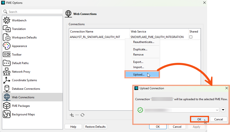

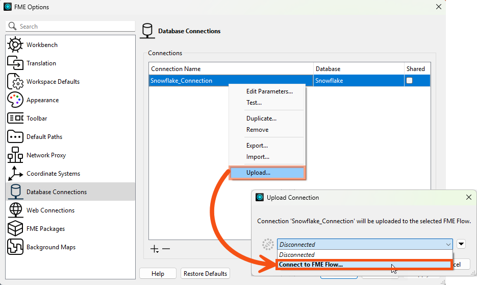

1. Upload the Database Connection to FME Flow
  • FME Options → Database Connections

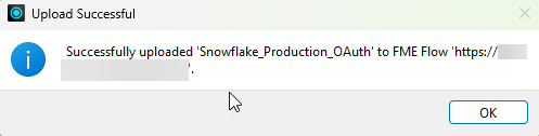

Then right-click on your newly created Snowflake Database Connection and click Upload. This will open an Upload Connection dialog, where you either:
  1. Select the FME Flow instance you want to use, or
  2. Select Connect to FME Flow
When prompted, enter your FME Flow connection details (server URL, username, and password).
Once complete, you'll see an Upload Successful confirmation dialog.
2. Upload the Web Connection to FME Flow
Next, upload the web service definition. Navigate to:
  • FME Options → Web Connections → Upload
This uploads your Snowflake OAuth web service configuration to Flow.

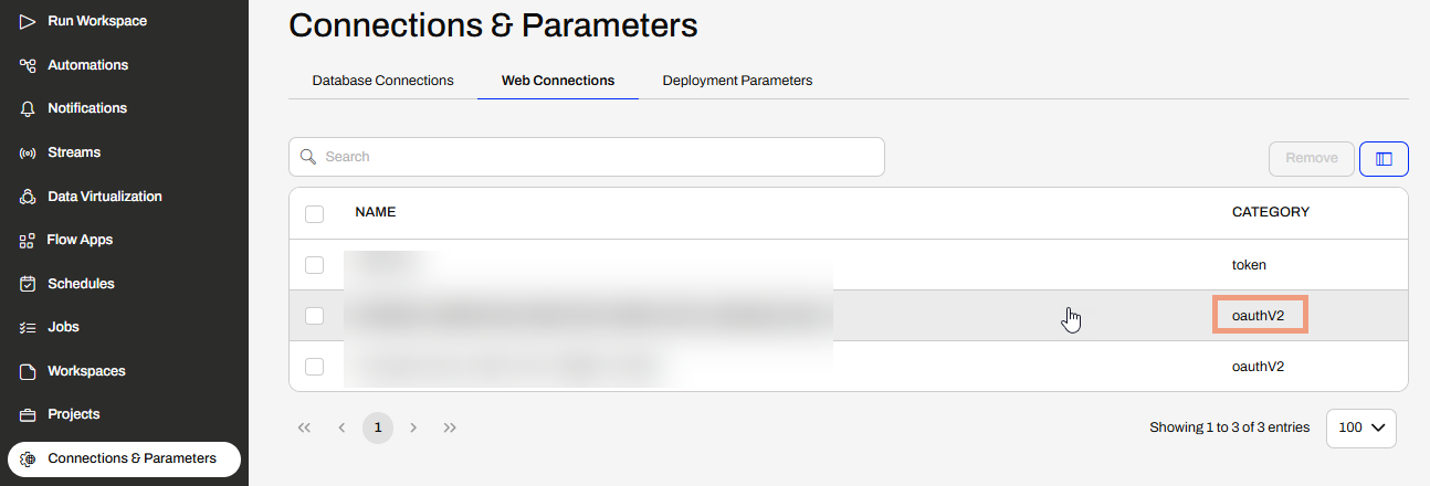

3. Configure the Web Service in FME Flow
Now you'll update the web service configuration in FME Flow's web interface to match the new redirect URI.

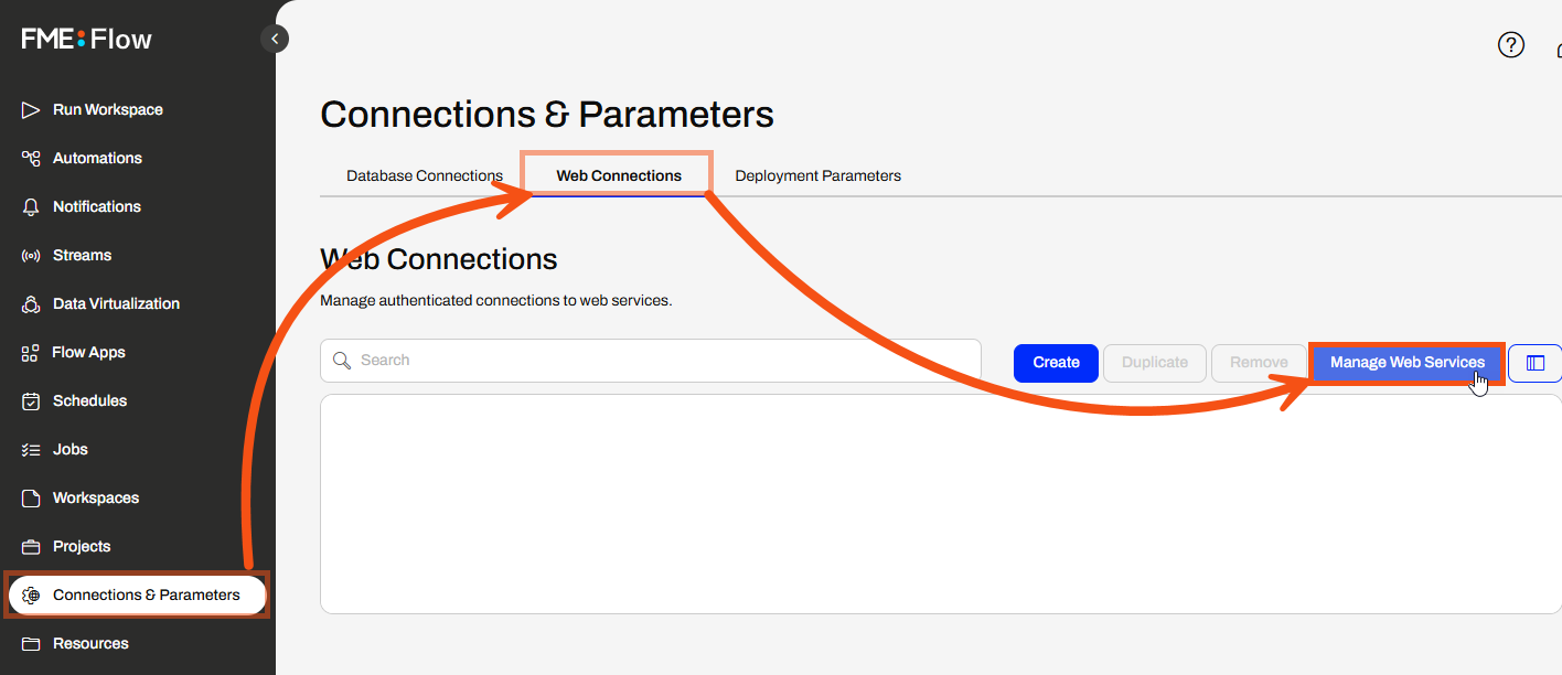

In your browser, log in to your FME Flow web interface and navigate to:
  • Connections & Parameters → Web Connections → Manage Web Services
Locate your web service in the Manage Web Services page, and find your uploaded Snowflake web service.  It will have the category oauthv2. Click on it to open the configuration.

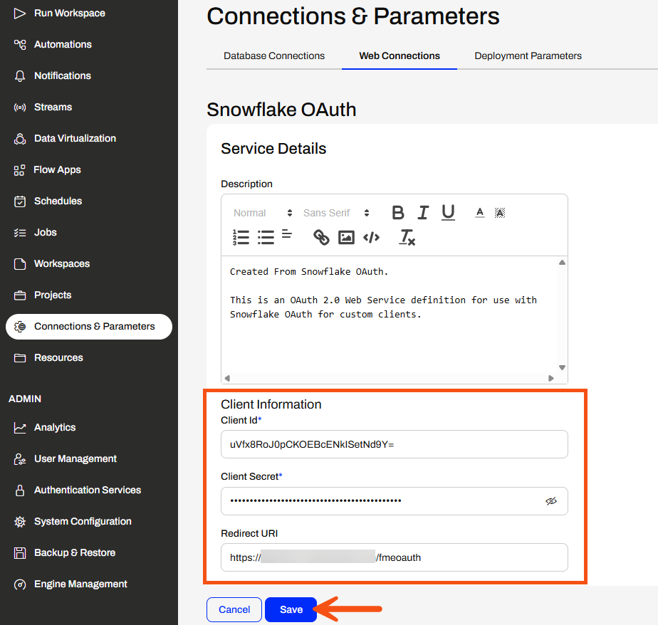

Update the redirect URI and verify credentials:
  • Redirect URI: Change this to https://<your-fme-flow-url>/fmeoauth
    • Replace <your-fme-flow-url> with your actual FME Flow URL
    • This should match exactly what you set in Snowflake when you created the security integration in Part 1
  • Client Information:
    • Client ID: Verify this matches your Snowflake security integration's Client ID
    • Client Secret: Verify this is correctly populated
Click Save to apply the changes.

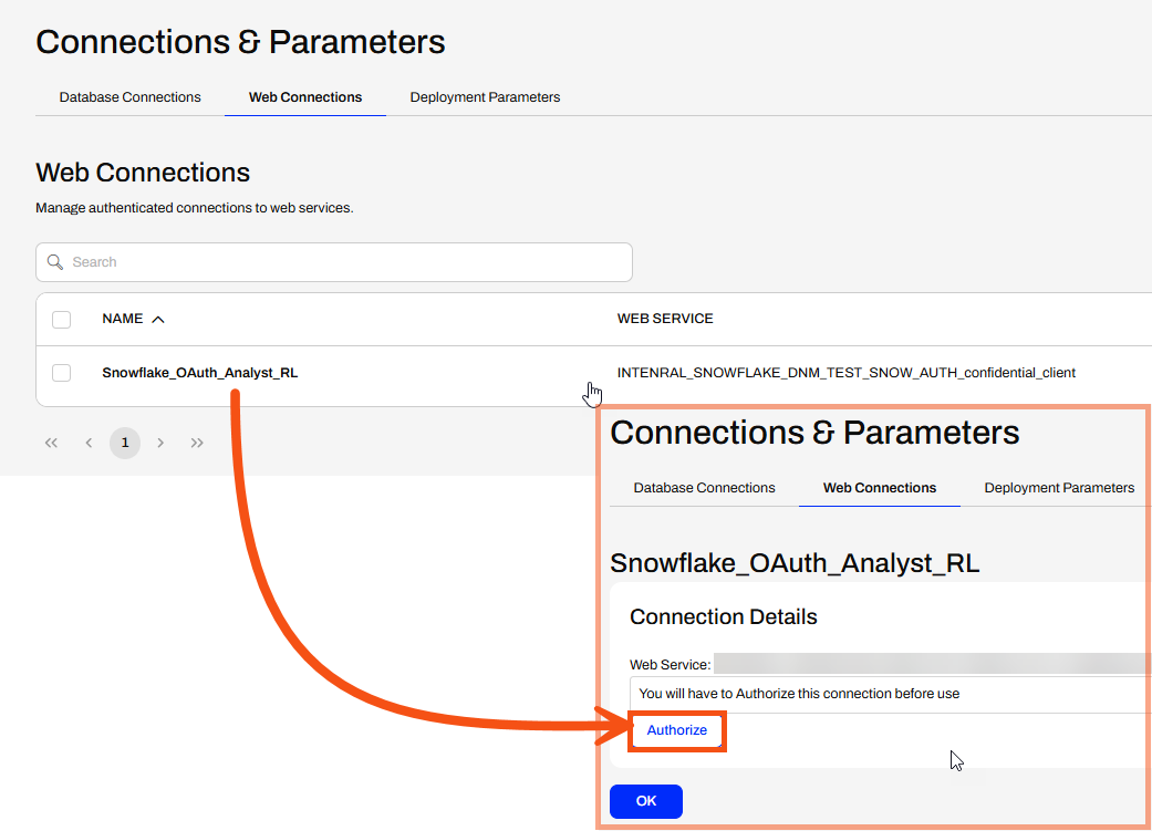

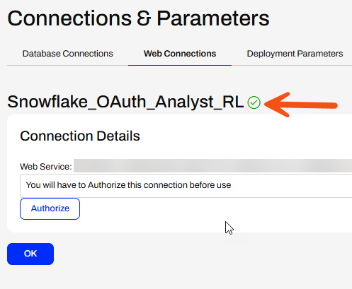

4. Authorize the Web Connection
After first publishing the connection from Form to Flow, it’s important to re-authenticate in FME Flow, to confirm that it is working:
Find your Snowflake web connection in the list, select it, then click Authorize.
Your browser will redirect to Snowflake's login page. Log in with a Snowflake account that has appropriate role permissions and complete the OAuth Process. You’ll then be redirected back to your FME Flow instance, where a green check at the end of your Web Connection name will validate that you’re successfully reauthenticated to the webservice.

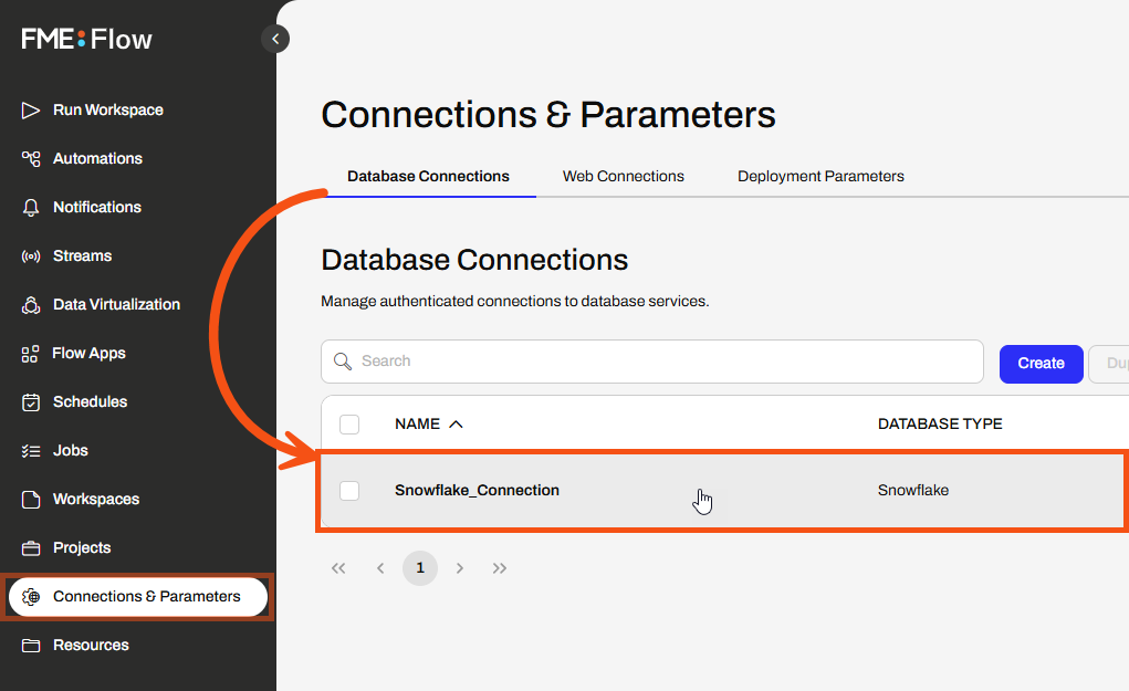

5. Configure the Database Connection in FME Flow
Finally, verify that your database connection is configured correctly in Flow.
In the Connections & Parameters tab, navigate to Database Connections and select your uploaded Snowflake database connection.
Verify all configuration details:
  • Parameters: Confirm these match your Snowflake environment:
    • Account Name
    • Warehouse
    • Database
    • Schema
    • Role
  • Authentication Parameters:
    • Authentication: Should be set to OAuth Connection
    • OAuth Connection: Select your configured Snowflake OAuth web connection from the dropdown
Click Save to apply any changes.
Your Snowflake OAuth database connection is now configured and authenticated in FME Flow. This connection can be used in any published workspaces, scheduled jobs, or automations running on your FME Flow server.
