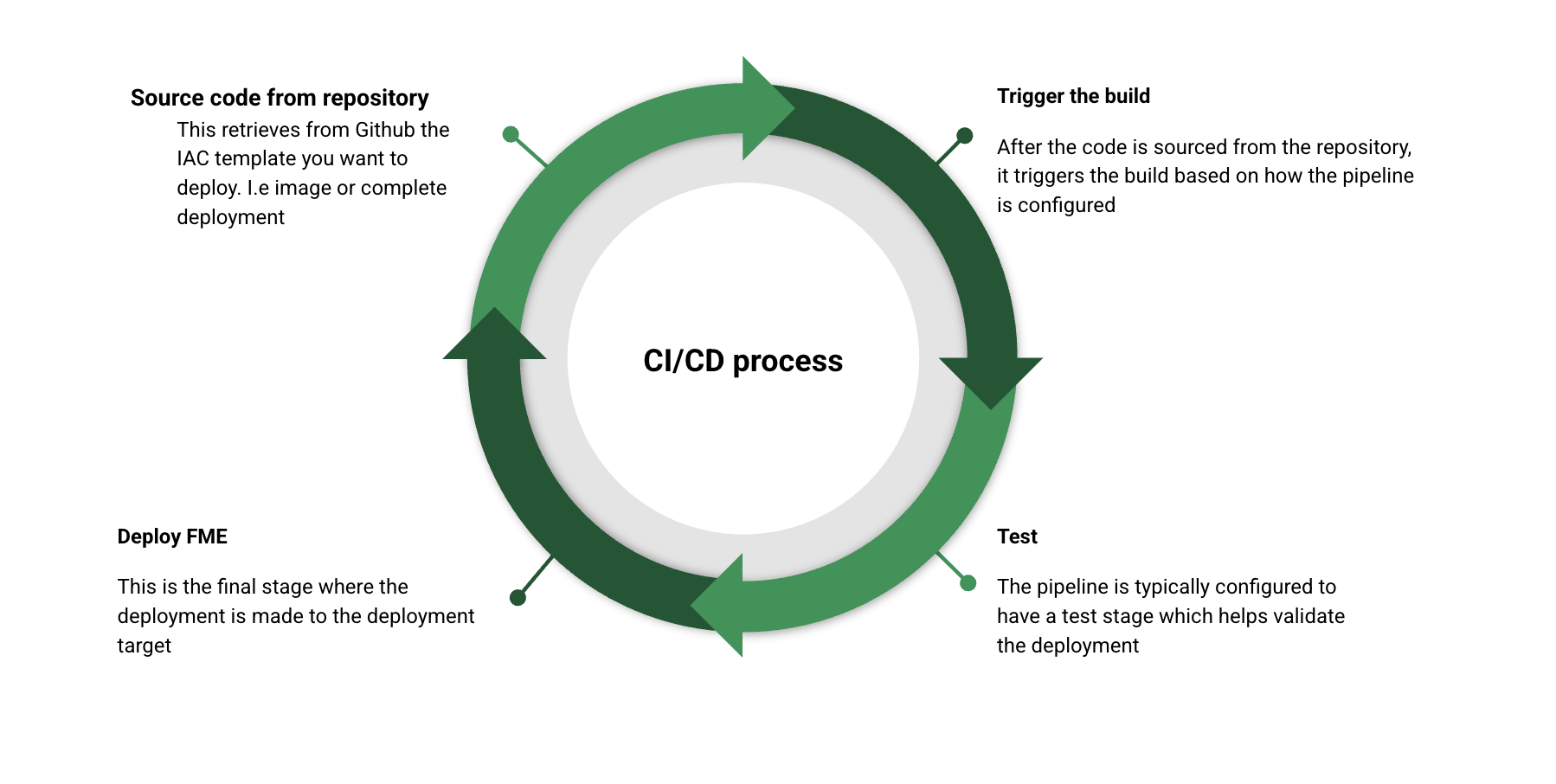

The diagram below describes the flow
       CI/CD lifecycle

1. Build Image
This is one of the most fundamental aspects of the overall FME CI/CD pipeline, as the image serves as the final FME deployment once the CI/CD workflow is completed. You will need to source the code needed to create a custom AMI(with FME installed) with Packer from the IAC repository. This process will be automated with Jenkins, as described in this article. The Jenkins setup requires a configured Jenkins server with all the necessary plugins and proper AWS credentials of the deployment target.
Key pipeline components include the agent declaration, parameter configuration, environment variables, and various operational stages. A real scenario with the actual process to build the AMI can be found here.
2. Set up and Trigger the Pipeline
This is the main step of the CI/CD process, as it deploys FME after preparing the created image. This process involves creating a structured Jenkins pipeline that automates the provisioning and teardown of AWS infrastructure using Terraform. The Jenkins server at this point should have the necessary plugin,s which include the Git, Pipeline, Terraform, GitHub Integration, Credentials Binding, and Pipeline Utility Steps plugin. You'll need to clone the IaC repository and add the GitHub credentials to Jenkins for secure GitHub access. After this, you can access and deploy all the deployment options available on the IAC template as long as the repository information is entered in Jenkins. The pipeline structure should follow a logical progression with clearly defined stages. An example of how this looks, along with a working full configuration, can be found in this article
3. Test the Deployment
This involves using Terraform to validate and display the resources the pipeline will deploy. The process to configure this stage is also found in this document.  This stage typically helps some save, as there are some errors that would be caught in this stage without having to wait for the complete deployment
4. Run the Deployment
At this point, the pipeline is created using the pipeline structure and can be deployed to its target environment in AWS. In this stage, you can determine whether you want to deploy to a production or a dev environment. If any other deployment needs to be made after this stage, the process will start again from the first stage.
 Once these steps are completed and you have a complete deployment, a user can trigger their FME deployment pipeline anytime, and they can just make changes to the IAC template based on their own situational needs. Once the pipeline is triggered, it follows the process described in the CI/CD lifecycle diagram above
