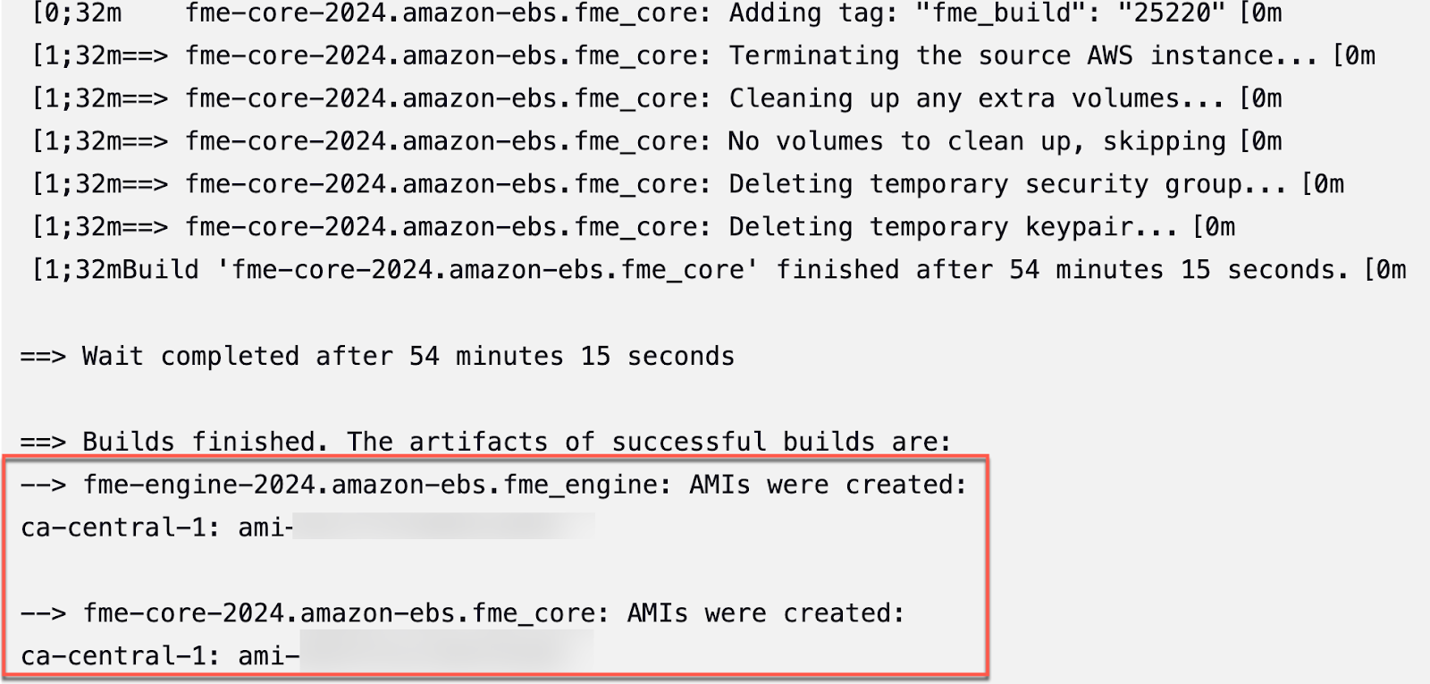

packer build -var "..." fme_flow_aws.pkr.hcl | tee output.log
This triggers the actual AMI creation process. Packer uses the parameters and builds an EC2 instance, installs FME using the installer_url and creates a new AMI from the customized instance. This tee output.log ensures logs are saved for AMI ID extraction [This is an optional step].
Extract AMI ID [Optional]
grep -o 'ami-[a-zA-Z0-9]*' output.log | tail -n 2
This pulls the last created AMI IDs from the Packer output log. This AMI ID can be passed to downstream jobs (like Terraform provisioning) or saved for audit.

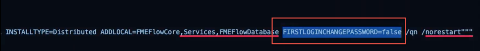

By default, the first login on the FME Flow Web UI as admin prompts a password change. If you want to access FME Flow via a pipeline using Flow CLI immediately after deployment, you need to set the silent install parameter FIRSTLOGINCHANGEPASSWORD=false when installing FME core.
On line 7 of the PowerShell script here [config/powershell/install-flow-core.ps1], add FIRSTLOGINCHANGEPASSWORD=false as shown below.
After this change, the user login can persist as admin/admin after install. FME Flow does not enforce an immediate password change, allowing you to use the Flow CLI within your pipeline right after deployment without any additional login configuration.
Conclusion
This pipeline should provide you with two AMIs -one for Flow Core and one for Flow Engine.
