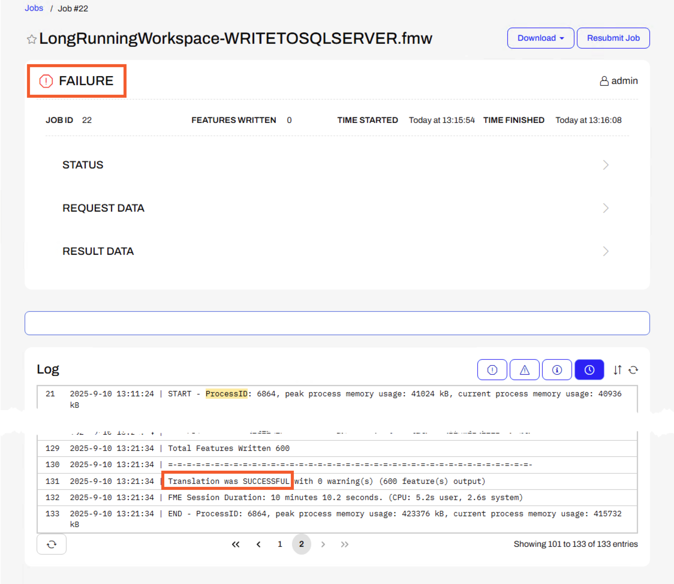

Issue
FME Flow indicates a job that has failed, but there is evidence in the job log and/or downstream databases that it is still running or completed successfully.

If FME Flow has reported that the job failed, but the job log doesn't show that the translation completed, check the failed job log for the ProcessID. For example:
START - ProcessID: 6864

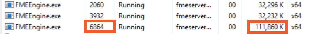

Check the distributed engine host for that same ProcessID (PID). For example:
If there is a process still running with the same ID, then the job is still running.
If the engine hasn't lost connection to the FME Flow system share, then job log will continue to be updated. Refresh the job log to monitor job progress and check for successful completion. Note that the details above the job log (Feature Written, Time Finished etc...) will be inaccurate as well as the status.
