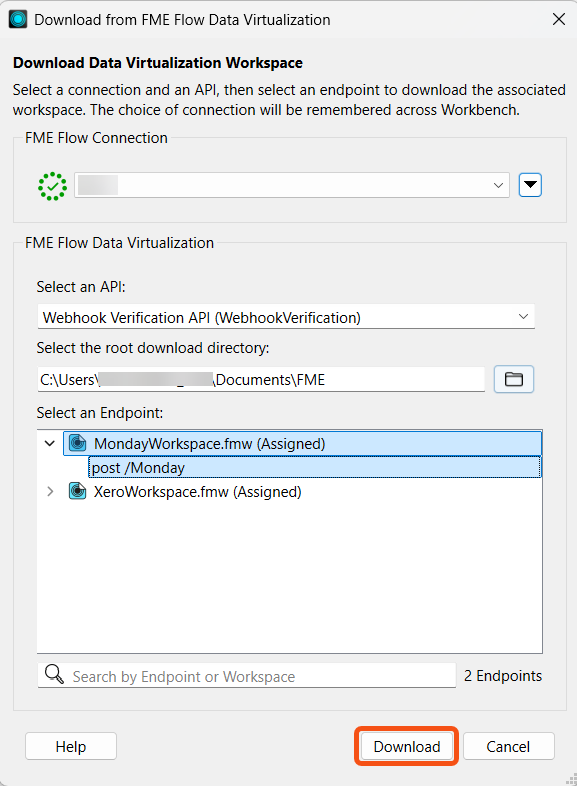

To inspect the workspace that processes the request from Monday.com, open FME Workbench and select Data Virtualization from the Get Started menu. Select the appropriate FME Flow connection, then select the Webhook Verification API from the API dropdown menu (if it is not already selected). Select the MondayWorkspace.fmw assigned workspace, then click Download to open the workspace.

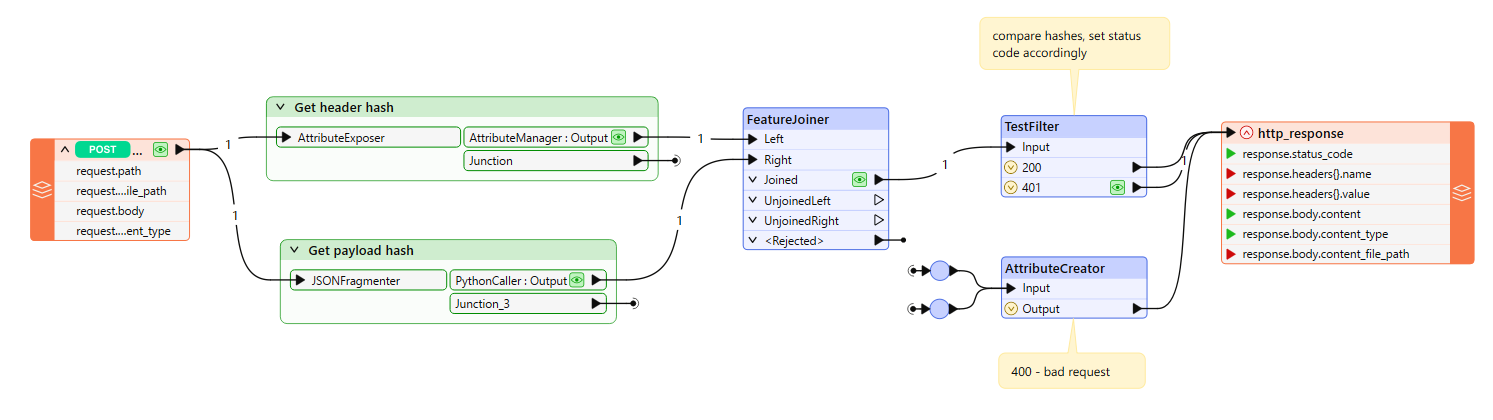

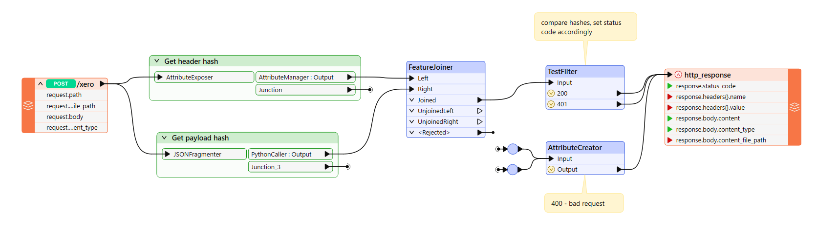

3. Open and Inspect the Workspace
In FME Form, open XeroWorkspace.fmw:
Look at the workspace with the bookmarks collapsed to get a high-level overview of its logic:
From this, we see the workspace generates a hash of the payload, which it compares to the hash specified in the header. If they match, it responds with a 200 status code; if they don't, it responds with a 401 status code; and if there are problems with the request, it responds with a 400 status code and error.

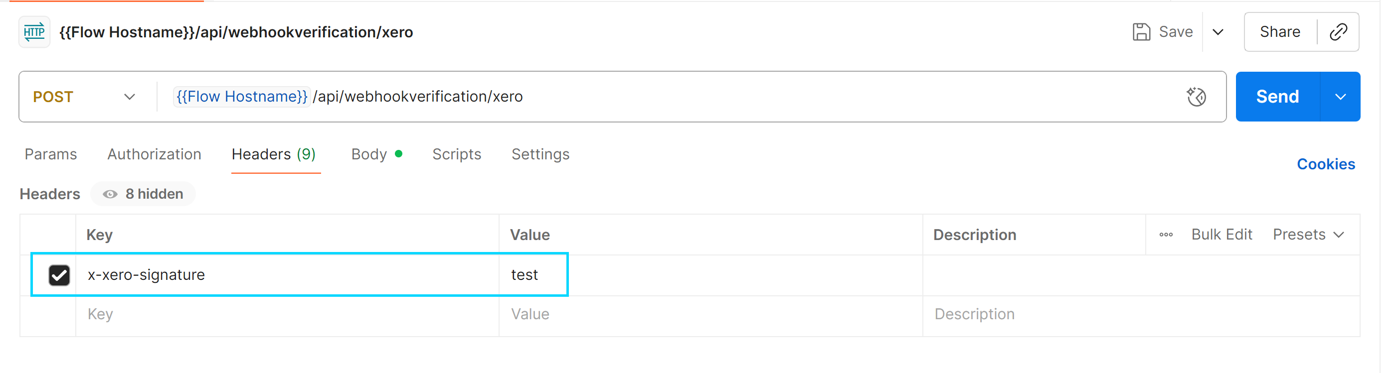

In Postman or the Swagger API Docs, make a POST request to https://<Flow Hostname>/api/webhookverification/xero with header "x-xero-signature":"example" and payload:
    "entropy": "example",
    "events": [],
    "firstEventSequence": 1,
    "lastEventSequence": 2
The response should have a 401 status code, with no body. See troubleshooting below if the response is something else.

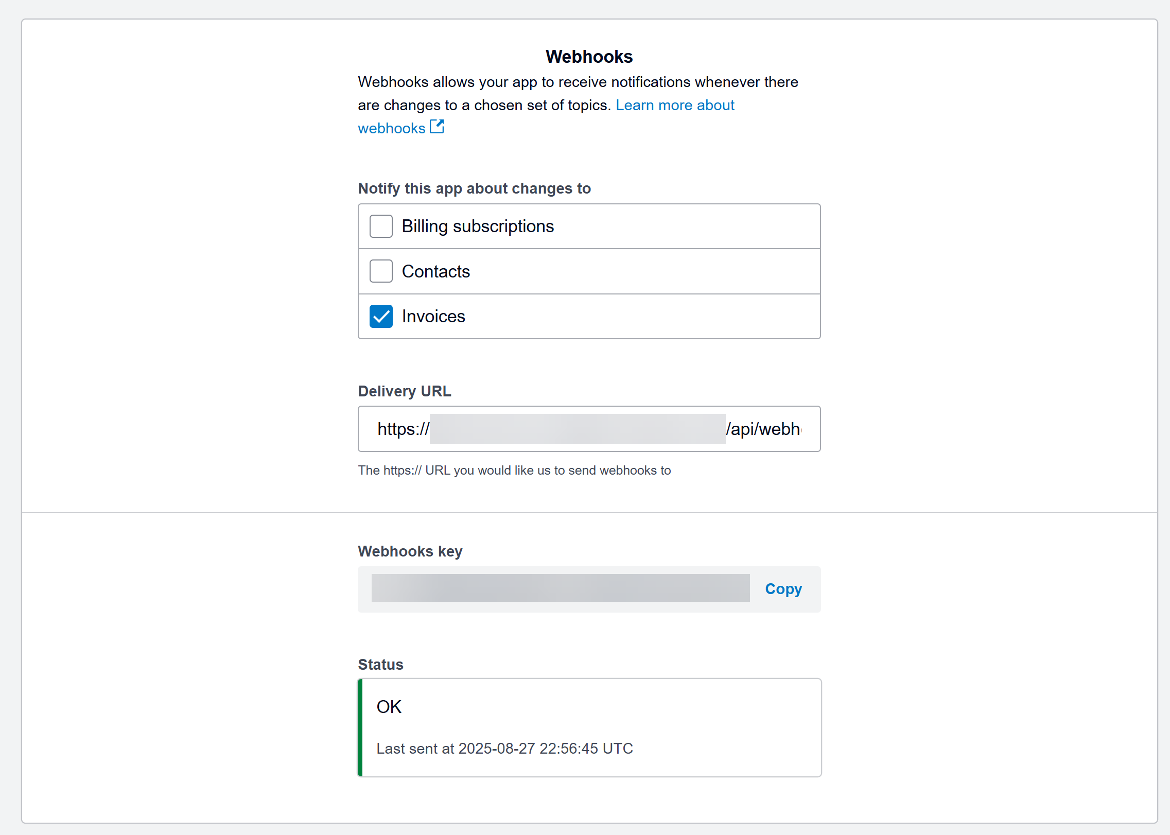

8. Validate the Webhook
In Xero Developer, click Send Intent to receive. After a few seconds, the status should be OK.
