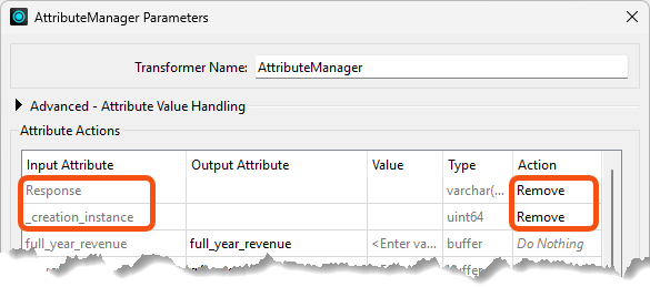

2. Add an AttributeManager Transformer
We can easily delete attributes that we don’t need with an AttributeManager transformer. Add one on the canvas and connect it after the JSONFlattener.
Remove the following attributes:
  • Response
  • _creation_instance
3. Run the Workspace
With feature caching enabled, run the workspace.
Inspect the AttributeManager feature cache. The information extracted from the financial report has been neatly packaged into attributes with values.
