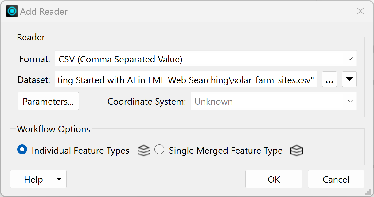

1. Open a New Workspace
Open FME Workbench and create a new blank workspace. Add a Reader to the workspace and set the parameters as follows:
  • Format: CSV (Comma Separated Value)
  • Dataset: solar_farm_sites.csv
Click  OK to add the reader to the workspace.

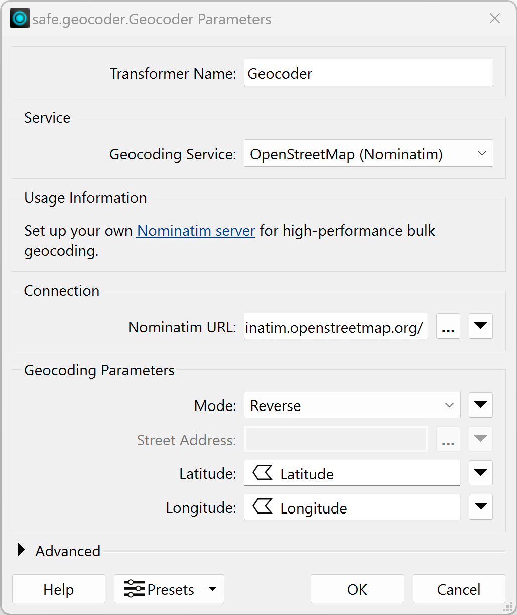

2. Add a Geocoder Transformer
Connect it to the CSV Reader. In the Geocoder, set the parameters as follows:
  • Geocoding Service: OpenStreetMap (Nominatim)
  • Mode: Reverse
  • Latitude: select the Latitude attribute from the drop-down
  • Longitude: select the Longitude attribute from the drop-down
Click OK to accept the parameters.

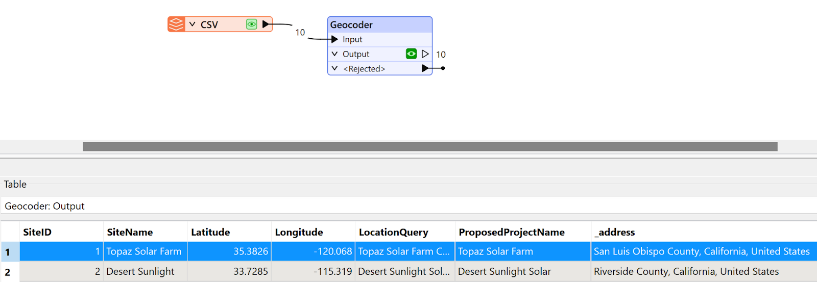

3. Run Workspace
With feature-caching enabled, run the workspace and inspect the results of the Geocoder in the visual preview table view. Each record should now contain a new attribute called _address that contains the address of each site. You will use this information in our prompt to ensure that the AI service gathers information about the correct site.

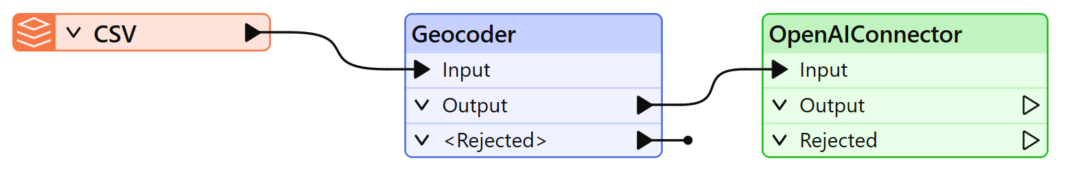

1. Add an OpenAIConnector
Connect it to the Geocoder Output port

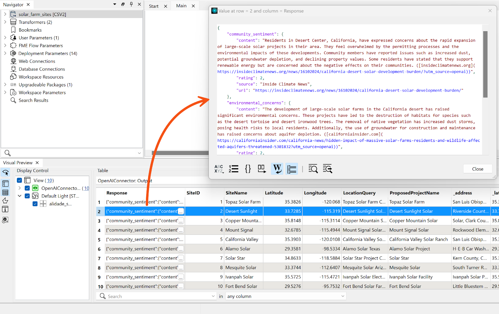

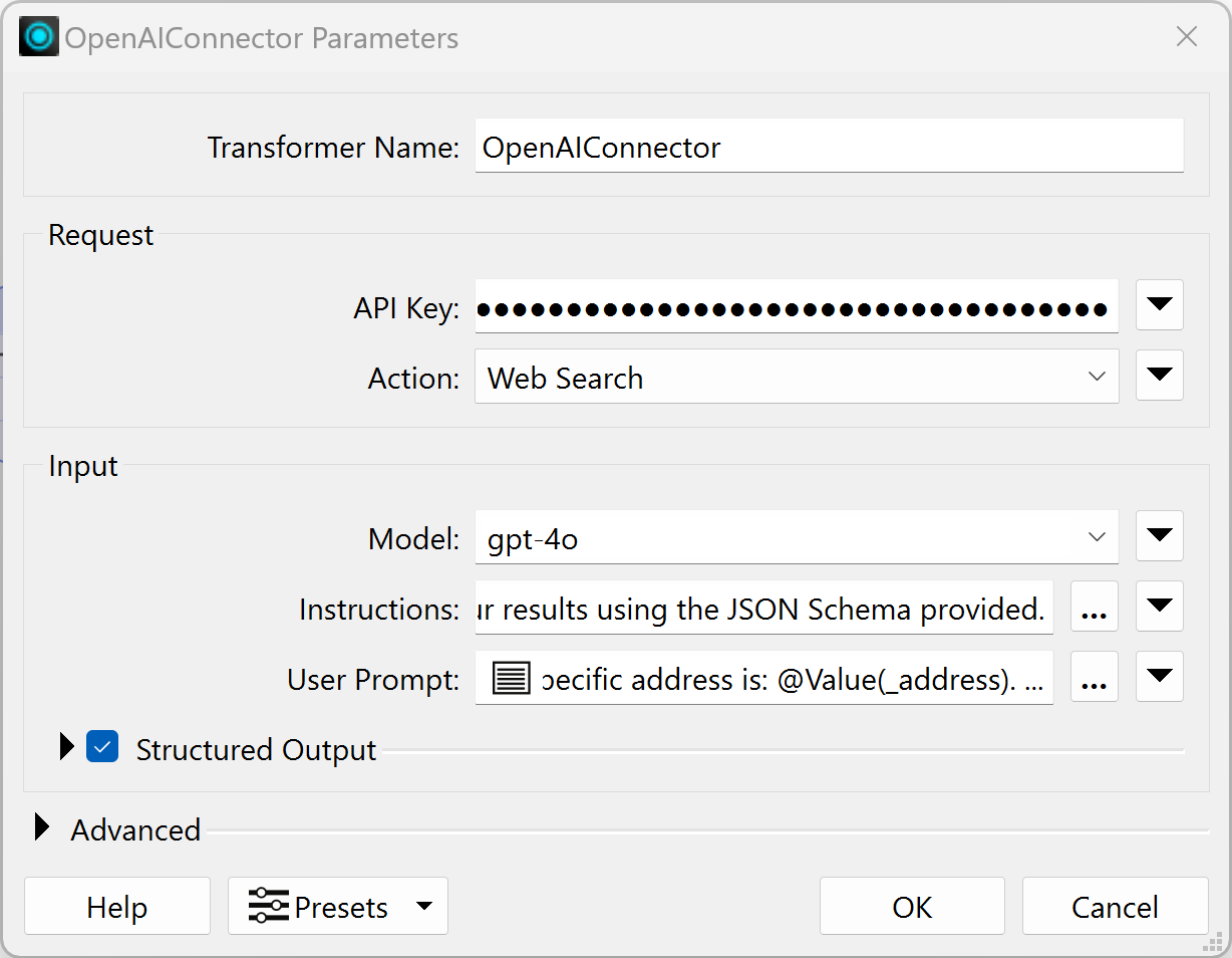

Your OpenAIConnector parameters should look like the following screenshot.
3. Run the Workspace
Inspect the result from the OpenAIConnector. The Response attribute in the Visual Preview window contains a JSON-formatted response with the results from the OpenAIConnector Web Search.

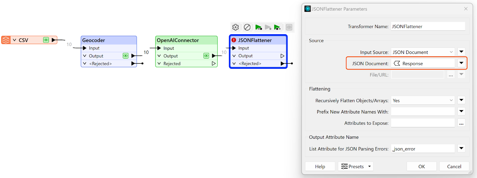

1. Format the JSON Response
Add a JSONFlattener to your workspace and connect it to the OpenAIConnector Output port. Open the JSONFlattener parameters and configure them as follows:
  • JSON Document: Response
2. Run the Workspace
With feature caching enabled, run the workspace up to the JSONFlattener. This will cache the flattened JSON response, which we can then expose in the transformer, which we will add next.

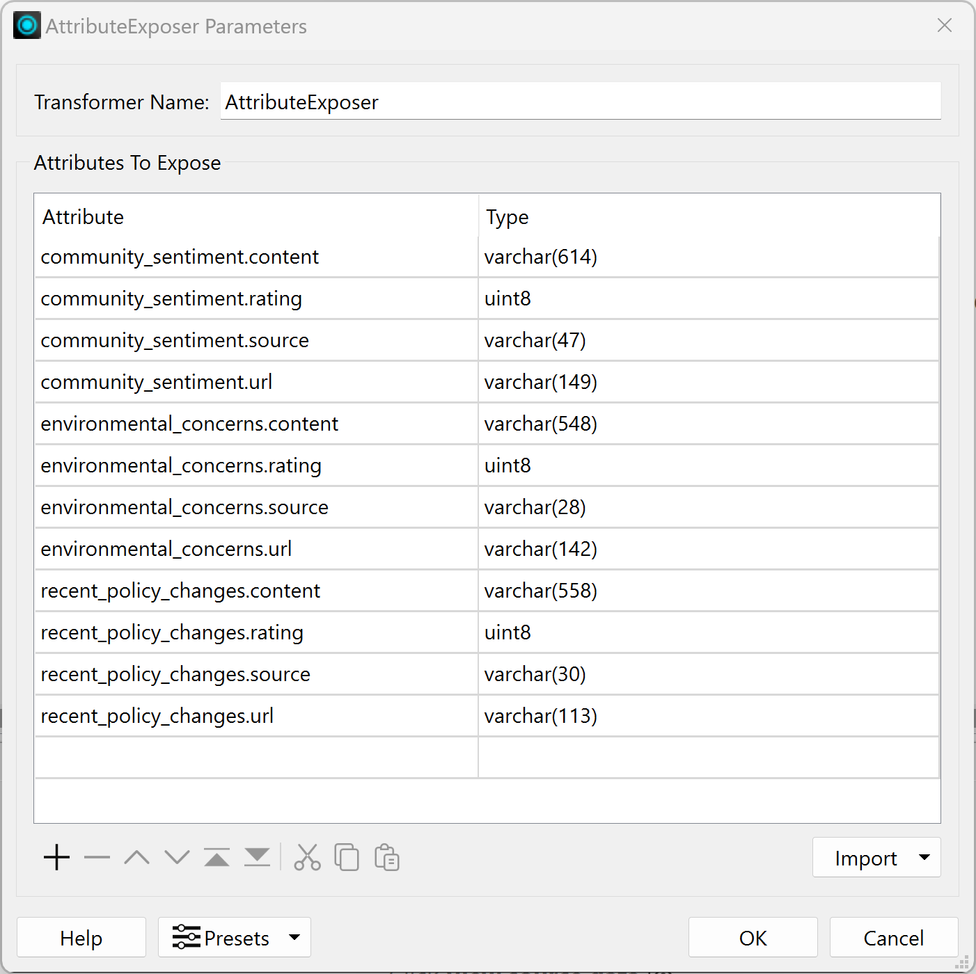

3. Add an AttributeExposer
Connect it to the JSONFlattener. Open the AttributeExposer parameters and select the Import > From Feature Cache button. Click the Select All button to deselect all the attributes. We only want to import the following attributes:
  • community_sentiment.content
  • community_sentiment.rating
  • community_sentiment.source
  • community_sentiment.url
  • environmental_concerns.content
  • environmental_concerns.rating
  • environmental_concerns.source
  • environmental_concerns.url
  • recent_policy_changes.content
  • recent_policy_changes.rating
  • recent_policy_changes.source
  • recent_policy_changes.url

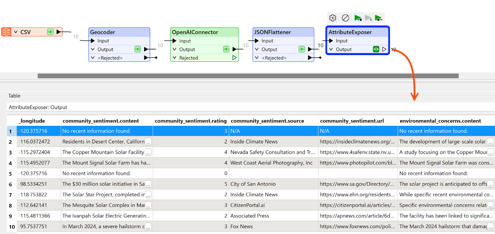

4. Run the Workspace
Inspect the AttributeExposer output. In the Data Preview Table, you can see the community sentiment, environmental concerns, and recent policy changes set of attributes have been exposed, including their source & URL that was used to generate the content. A general rating is also provided for each of these categories to help you gauge whether or not any of these categories are a concern for the solar farm site.
