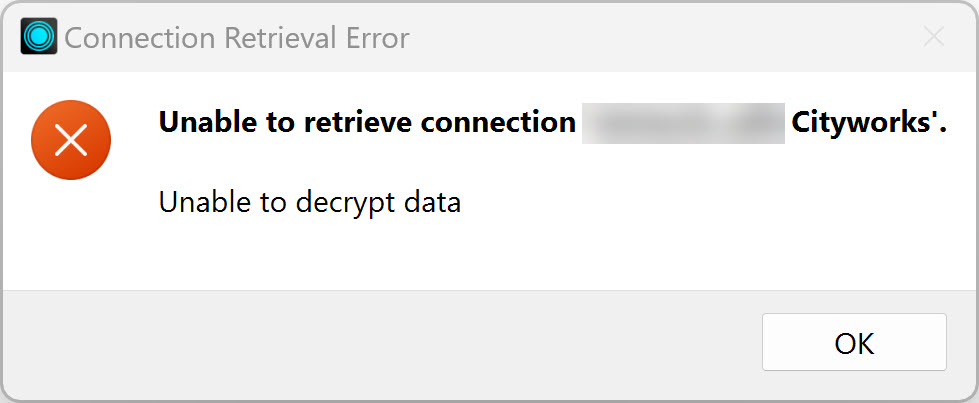

Users who log into Windows or macOS using third-party credentials (e.g., GSuite login) may lose access to saved connections stored in Personal Connection Storage after a password change in the third-party system.
Why This Happens
  • Personal Connection Storage relies on OS provided encryption algorithms tied to your system login credentials.
  • When using third-party authentication, a password change outside the OS environment breaks the OS decryption algorithms, making saved connections inaccessible.
  • This is a limitation of how Windows and macOS manage credential-based encryption, and affects both Web and Database connections stored under Personal Storage.

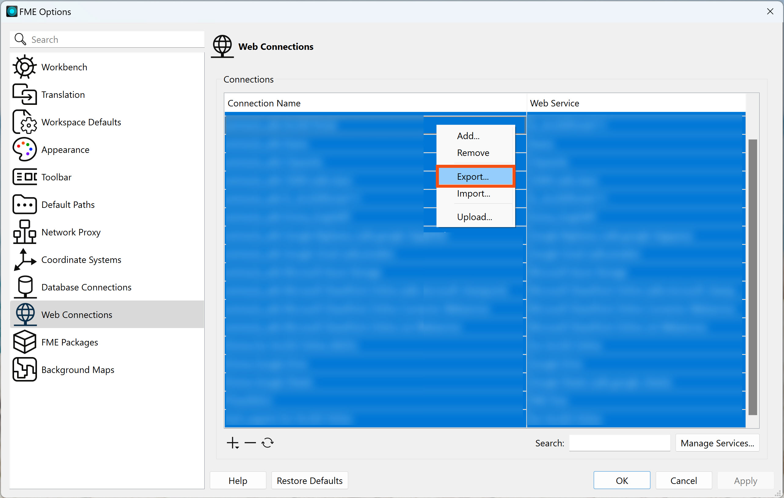

1. Export Connections from Personal Storage
  • Go to Tools > FME Options > Web Connections
    • If you are on 2025.1, go to Utilities > FME Options > Web Connections
  • Select all connections, right click, and choose Export
  • Choose a destination to save all the connections as an .xml file
  • Repeat these steps under Database Connections

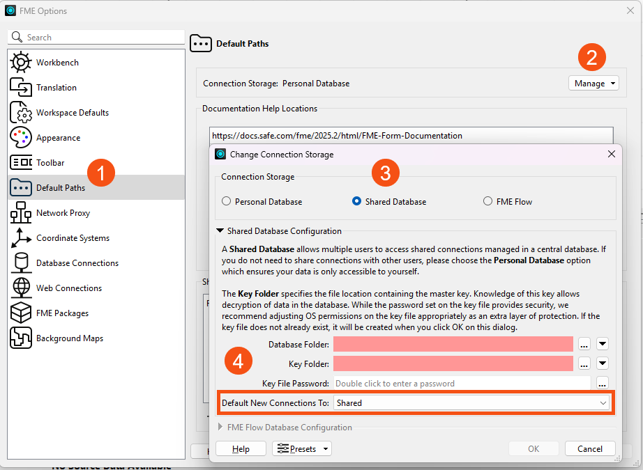

2. Switch to Shared Connection Storage
  • Go to Tools > FME Options > Default Paths > Manage > Change Connection Storage
    • If you are on 2025.1, go to Utilities > FME Options > Default Paths > Manage > Change Connection Storage
  • Under Connection Storage, select Shared Database
  • Choose destinations for your Database Folder and Key Folder
  • Leave the password field blank and ensure your file system permissions restrict access to your user account only.
  • If you are using 2025.1, choose Shared as the Default Connection Storage

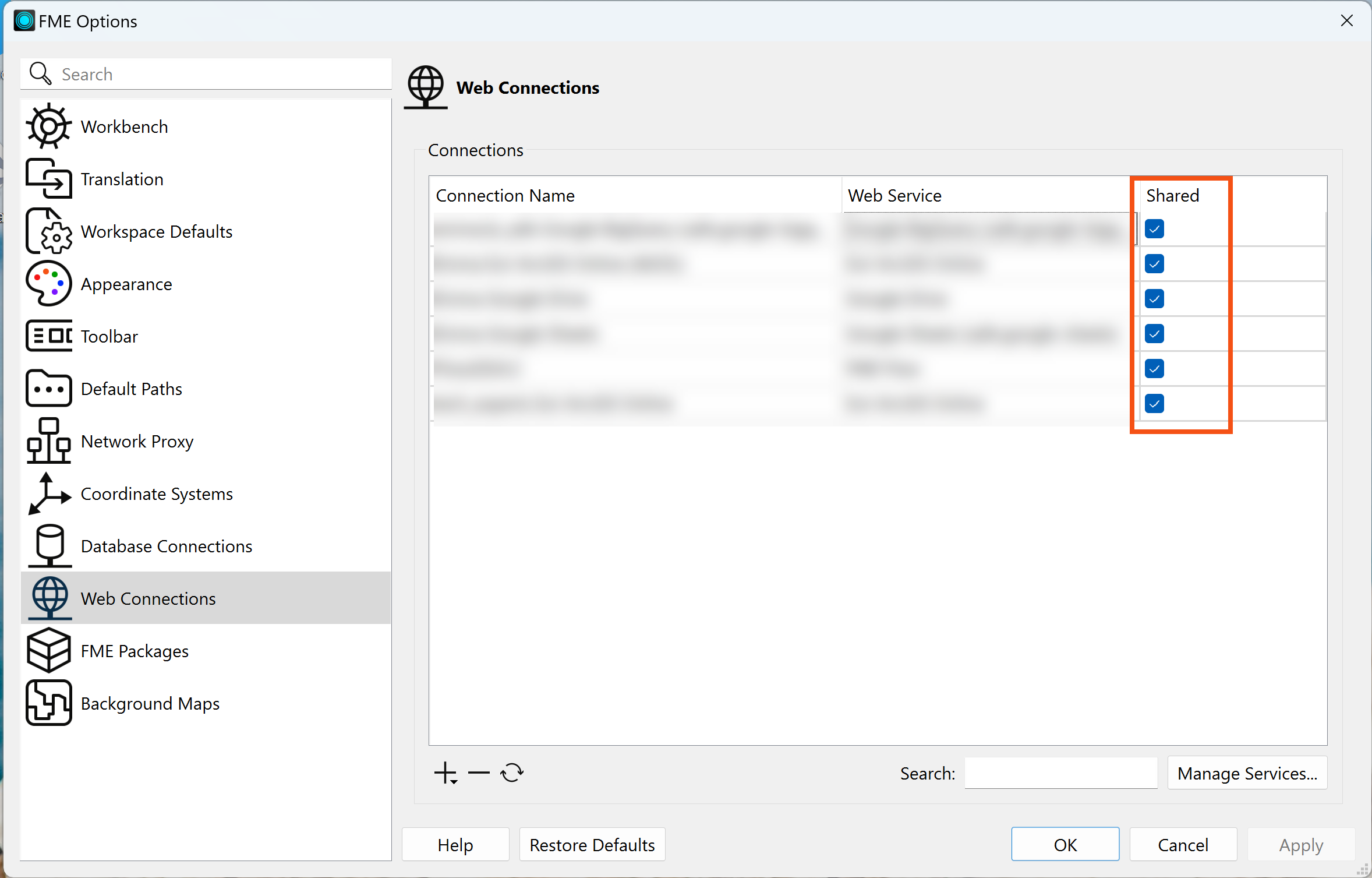

3. Import Connections and Mark Them as Shared
  • Return to Tools > FME Options > Web Connections
  • Right click and choose Import
  • Select the .xml file you exported earlier
  • Check the boxes in the Shared column next to each connection. If not marked as Shared, they will still be treated as Personal connections.
  • Repeat for Database Connections
If connections are not marked as Shared, they will still be treated as Personal connections.
