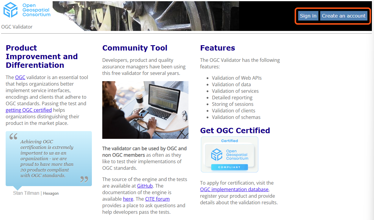

1. Navigate to the OGC’s TEAM Engine Page
We can test a dataset in the TEAM Engine to ensure everything is up to standard. To access the test suite, we need to either sign in or create an account by clicking here. If you do not have an account, you will need to create one and log in before proceeding to the next step.

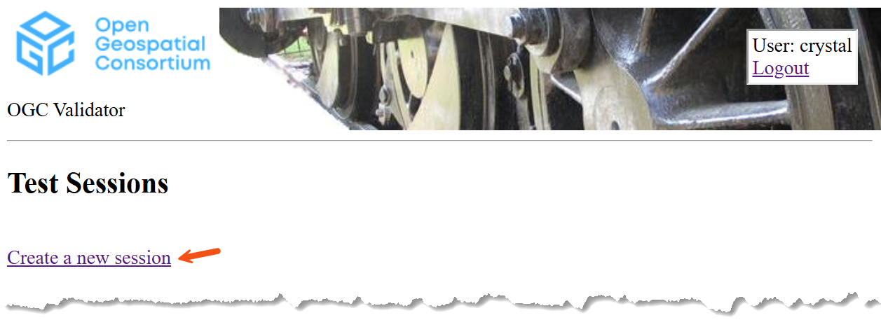

2. Create a New Session
After logging in, click “Create a new session”.

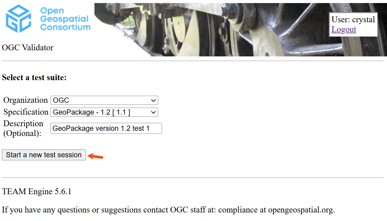

3. Select a Test Suite
Now that we have created a new session, we can select a specification and add a description. For example, we can set the following:
  • Specification: GeoPackage - 1.2[1.1]
  • Description (Optional): GeoPackage version 1.2 test 1
Click “Start a new test session” at the bottom.

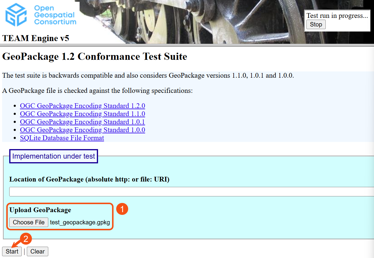

4. Upload GeoPackage and Start Test
Choose the dataset you want to test based on the format set in the Specification. We can upload a GeoPackage for this example because we set the specification to GeoPackage in Step 3.
Click Start to begin the test.

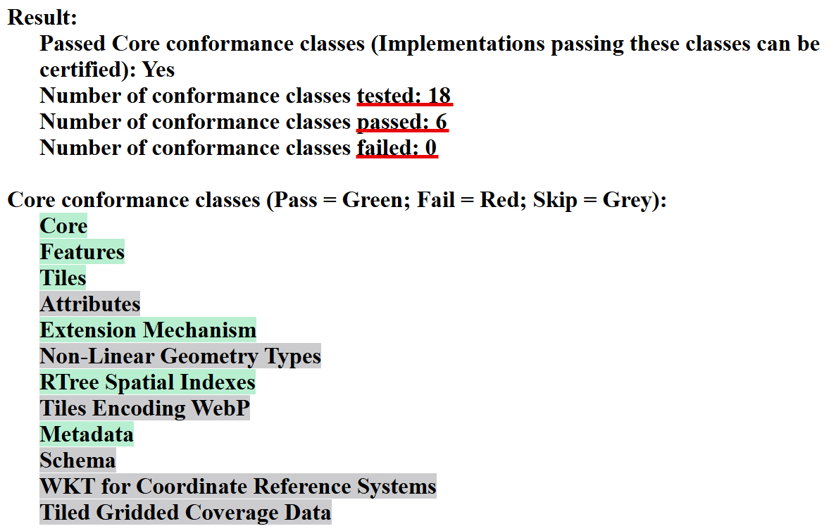

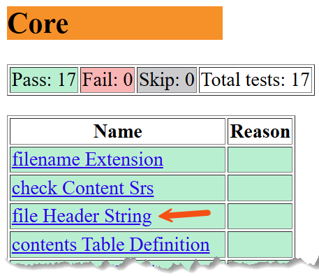

4. View Test Session Results
After the test finishes running, we will see the results. In the Result section, we can see if our dataset passed the Core conformance classes and how many conformance classes were tested/passed/failed. Below that, we can also see a color-coded list of the core conformance class results.
If we scroll down, we can see the specific tests for each conformance class. We can click on the “file Header String” test under Core to learn more about it

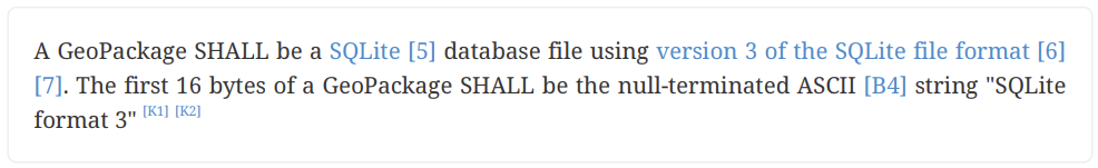

Based on the information provided after clicking, we can see that this test is implemented to satisfy Requirement 1 from the implementation standard document. According to the document, Requirement 1 necessitates the following:
