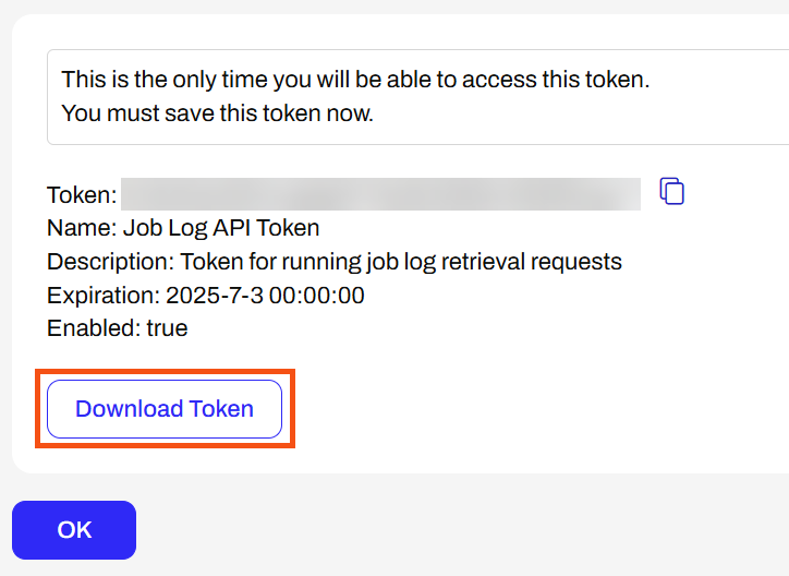

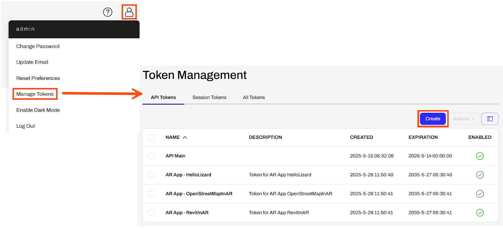

To start, we will need an API token that will give us the proper permissions to access the job log files we need. From your FME Flow home page, navigate to User Settings in the top-right corner, and select Manage Tokens. Ensure the API Tokens tab is selected, then select Create.
Give your new token a name (e.g. ‘Job Log API Token’), a description, and set an appropriate expiration date. Under Permissions, navigate to Jobs, and select the Manage permissions option. Click Save, and then be sure to download your token and save it somewhere safe, as this will be your only opportunity to download it.

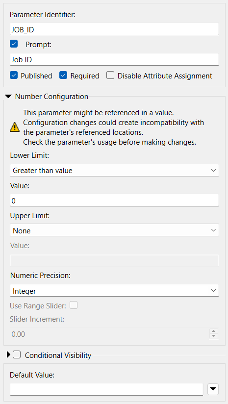

Create a new workspace in FME Workbench. In the Navigator window, right-click User Parameters, then select Manage User Parameters. We are going to create a new user parameter that will allow the user to pass in the job ID value for the log file they would like to retrieve.
In the User Parameters window, click the green + button in the top-left corner, then select Number and fill in the parameter information below:
  • Parameter Identifier: JOB_ID
  • Prompt: Job ID
  • Published: Yes
  • Required: Yes
  • Number Configuration:
    • Lower Limit: Greater than value
    • Value: 0
    • Upper Limit: None
    • Numeric Precision: Integer
Once your parameter has been configured, click OK.

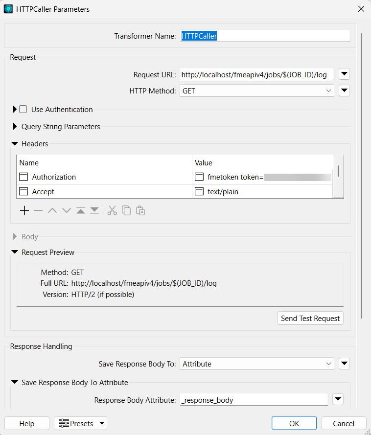

Add an HTTPCaller to the workspace, and open the HTTPCaller parameters. Configure the HTTPCaller parameters:
  • Request URL: http://<Your_Flow_URL>/fmeapiv4/jobs/$(JOB_ID)/log
    • Replace ‘<Your_Flow_URL>’ with the URL for your Flow environment. Note that you may have to change the above request to HTTPS based on your configuration. This request passes in our user parameter as the job ID value, and will return the associated log file.
  • HTTP Method: GET
  • Headers:
    • Name: Authorization
      • Value: fmetoken token=<Your_API_Token>
    • Name: Accept
      • Value: text/plain
  • Response Handling:
    • Save Response Body To: Attribute
    • Response Body Attribute: _response_body

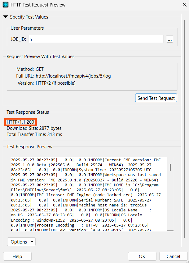

Be sure to replace ‘<Your_API_Token>’ with the token value you downloaded at the beginning of this tutorial. Once you have configured all the necessary parameters, we can test that our HTTP request is working properly by clicking the Send Test Request button. Enter a valid job ID value for our JOB_ID parameter at the top of the window, then click Send Test Request. The preview window should then display the log file for the associated job in plain text format.
Once you have confirmed that the request is working, click OK on the request preview window and tten OK again on the parameters window to close it. If your request is not working, double-check your request URL and token permissions.

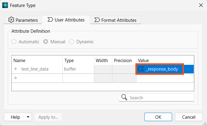

Double-click the writer to open the Feature Type Parameters window. Select User Attributes and set the value of text_line_data to the attribute that stores our log file response: _response_body.

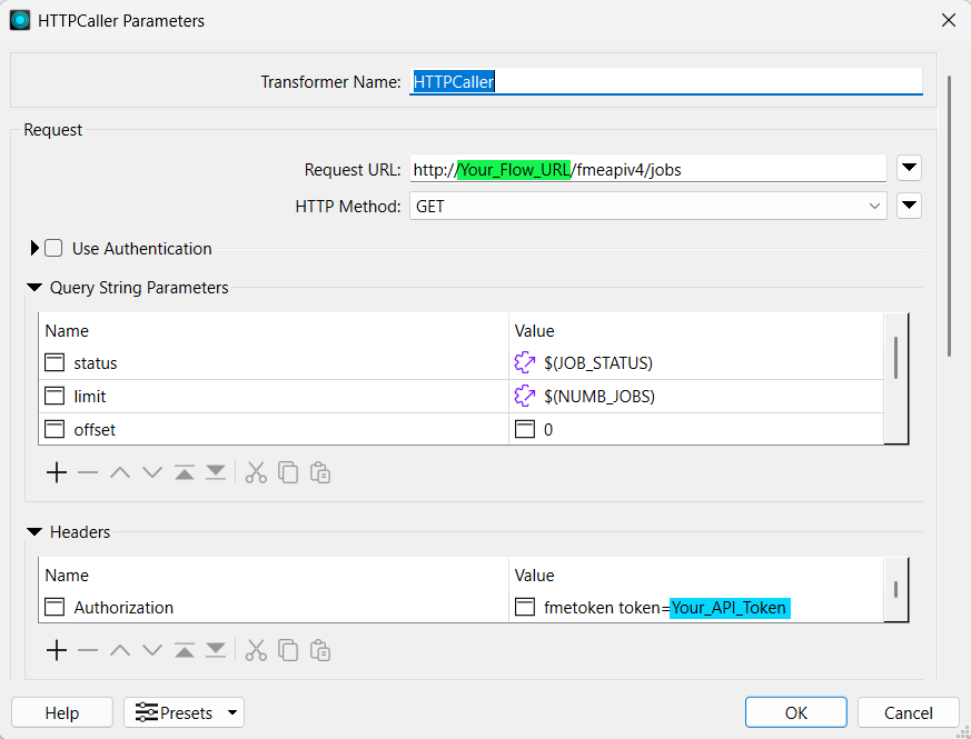

The first returns a list of jobs based on two user parameters: the status of the jobs they would like to return (success or failure), and the number of jobs they want. These parameters are passed into the request to generate a list of recent jobs.

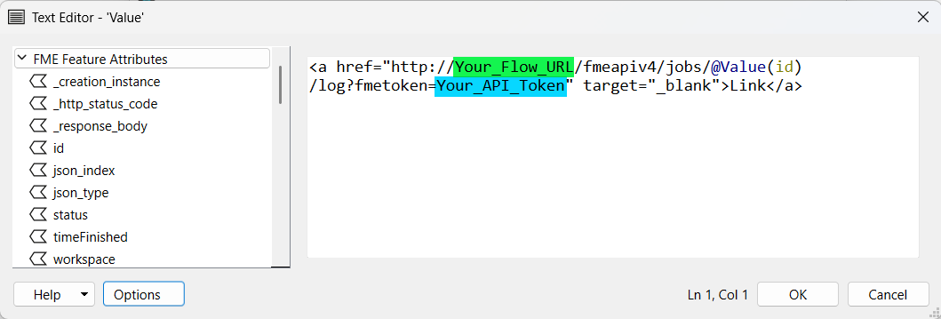

The second request is actually found in the AttributeCreator transformer, where we generate a new attribute for each job that is returned. This attribute contains an API request for the job log, which is wrapped in an HTML tag that generates a link in our list of jobs. When the user clicks that link, it triggers that API request and opens the log file in a new browser tab.
This second request will expose your API token in the URL of your request, which is not recommended for production or retrieving sensitive data. This is purely meant to be a demonstration of the different ways API requests can be made and how they can be integrated into workspaces.
1. Update the HTTPCaller
Open the workspace in FME Workbench. Open the HTTPCaller parameters and change the ‘Your_Flow_URL’ value in the request URL to your actual Flow URL. Update the ‘Your_API_Token’ value in the Authorization header to your actual API token.
2. Update the AttributeCreator
Open the AttributeCreator parameters and open the text editor for the log_request value by clicking the ellipsis button. Similarly, replace ‘Your_Flow_URL’ and ‘Your_API_Token’ with your actual Flow URL and token value, respectively.
For steps 1 and 2, note that you may have to update the request URLS to HTTPS, depending on your Flow configuration.

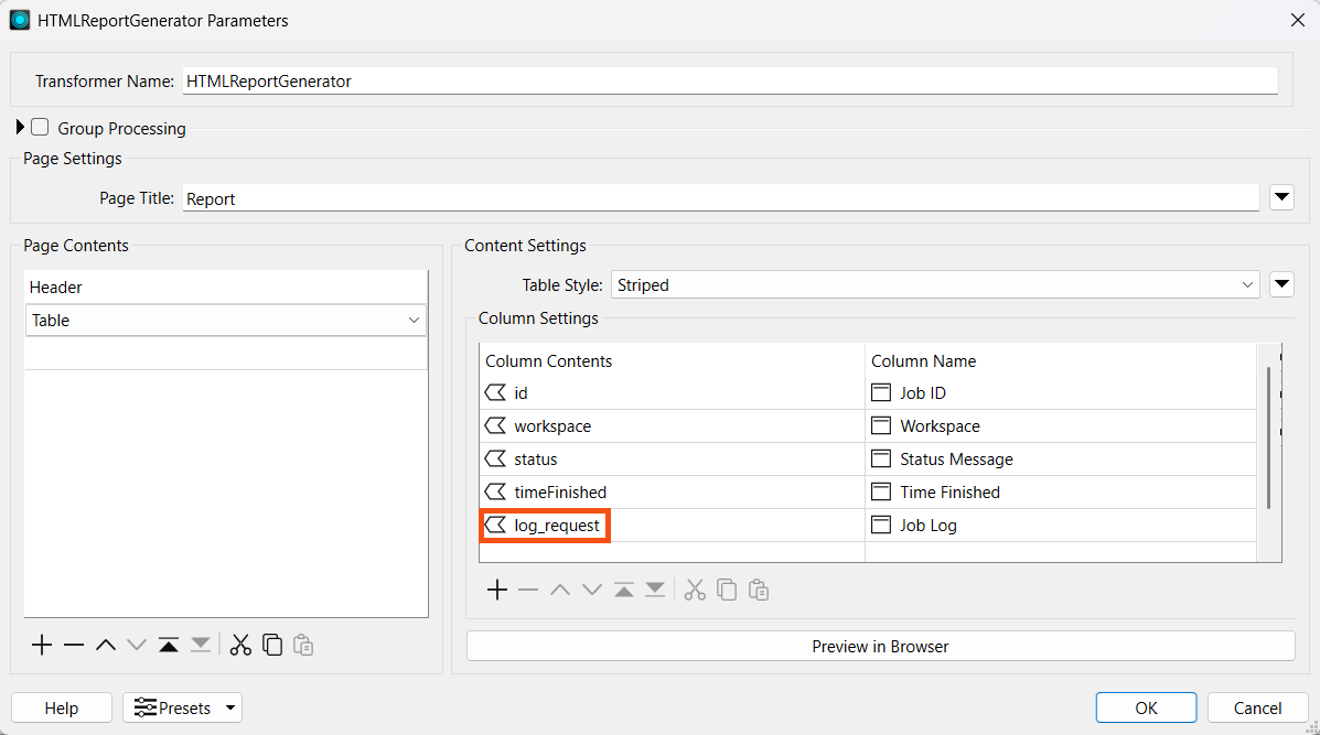

Open the HTMLReportGenerator parameters and click on the Table in the Page Contents bar. Here, you will see how we are populating the table with the log_request value for each returned job, along with some additional information, which we extracted from our first request using the JSONFragmenter (open that transformer as well to see how the request was queried to extract that information).
