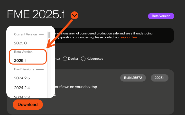

You’ll need a few installers from our Beta Downloads page.
Note that if you are navigating to the Downloads page by yourself, you'll need to select the dropdown to choose 2025.1 for access to the beta installer), and you’ll want to pick the matching build version for compatibility:
  • FME Form 2025.1 or newer
  • A matching build of the FME Form Language Pack
  • Offline Documentation (Optional)
From the 2025.1 Beta page, scroll down to FME Multi-Language Support and select the Language Pack you want to install.

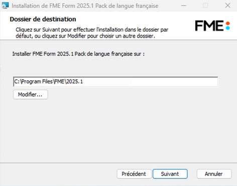

3. Install the Language Pack
Run the installer for the language pack and set the same installation path to the target FME Form version you want to apply it to. In the screenshot below, I have chosen to install the French language pack.
It is important that the language pack be installed in the exact same directory as FME.

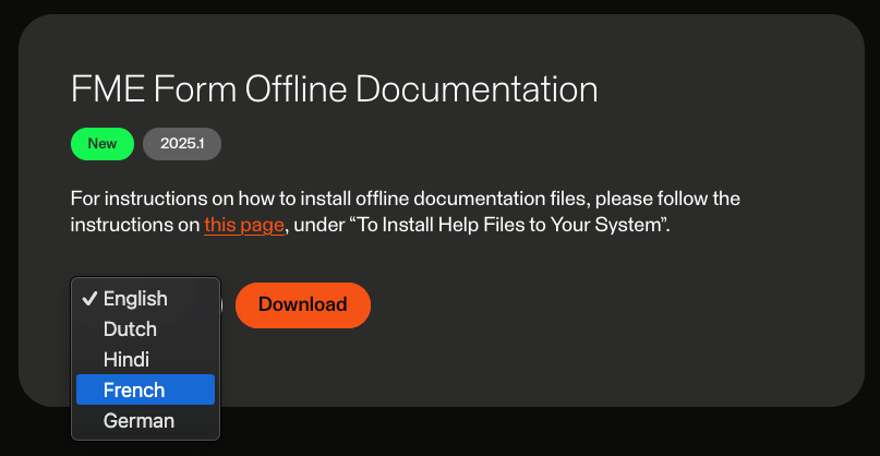

1. Download the Offline Documentation
Download the Offline Documentation from our Betas Downloads.

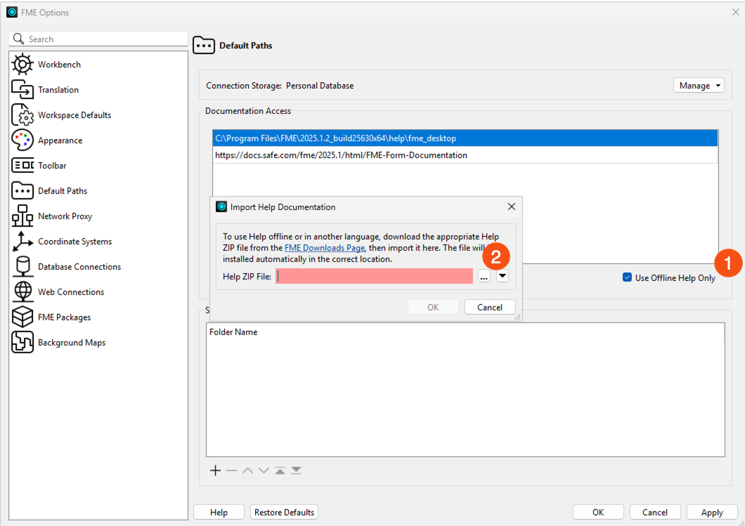

2. Extract the Zip File into Your FME Install Folder
Create a new folder called 'help' in your FME install folder.
Extract the zip file to your installer location under the new folder you created called ‘help’. The zip file contains a folder called fme_desktop and a file called fme_desktop.ini that points to the fme_desktop folder. For example, you could extract the French package to:
C:\Program Files\<FME Version>\help\
For French, this could look like:
 C:\Program Files\FME\2025.1\help\

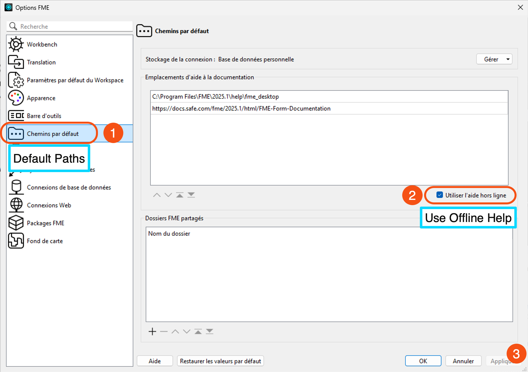

3. Open FME Workbench
In FME Workbench, as a test, add a Creator or any other transformer and select the Help button at the bottom left. If your Help documentation is in the language you want, you’re done!
Especially if you are working with FME in a locked-down environment where you don’t have access to an internet connection, you can enable FME to use offline help by going to Tools > FME Options > Default Paths and enabling 'Use Offline Help'.
If at any point you want to switch to English online help, you can turn off the 'Use Offline Help' here and restart FME Workbench.
4. Apply Changes and Reopen FME Workbench
Press ‘Apply’ and close FME. Open FME Workbench again. Add a Creator and check the Help again and it should be in your preferred language now.

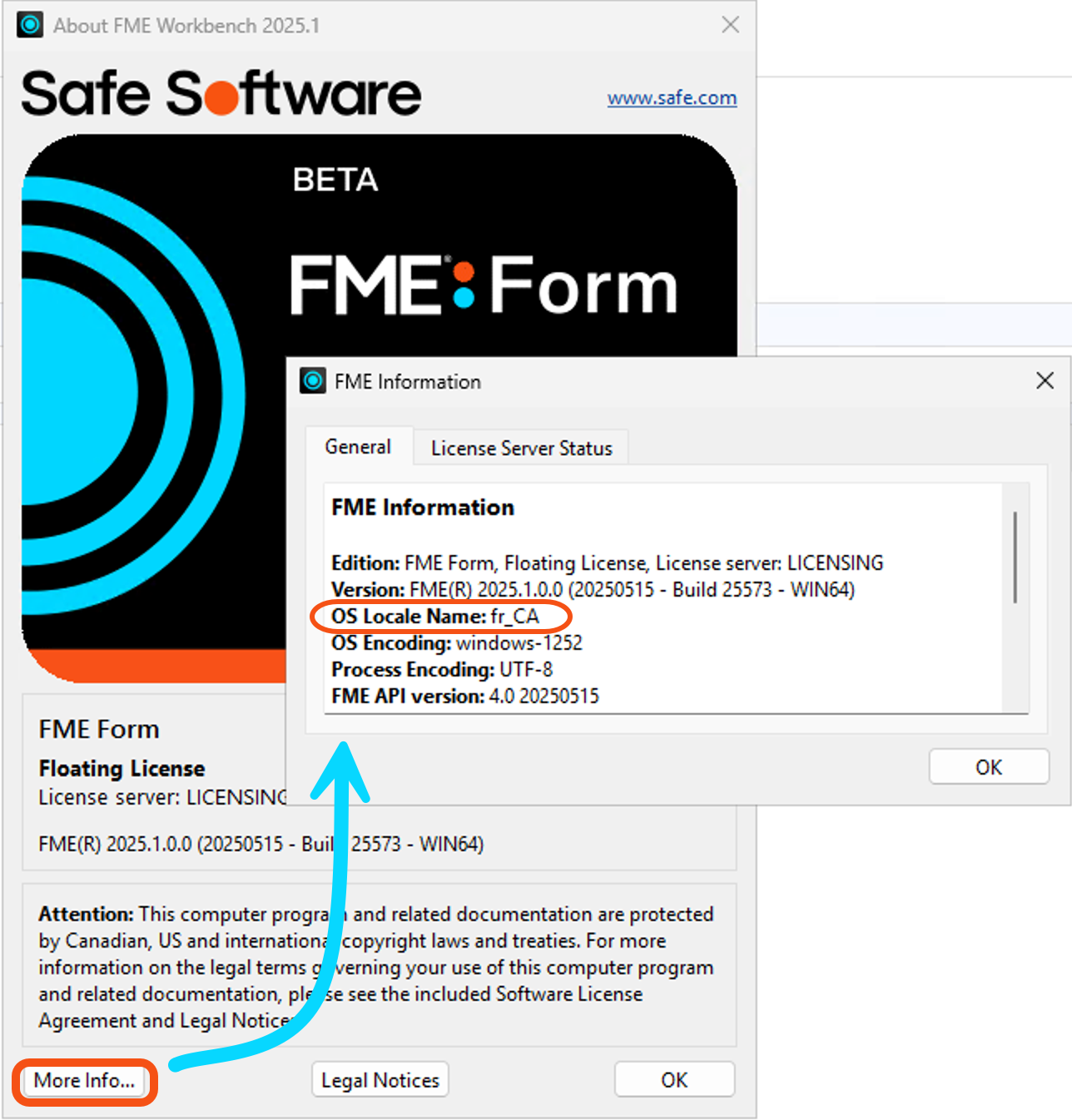

I've installed the language pack for FME Form but FME Workbench is still displaying text in English, what should I do next?
FME Form’s language pack is tied to your Windows system locale or preferred language settings. You can check your system locale through FME Workbench, by going to Help > About FME Workbench and selecting 'More info...'.
If the OS Locale Name doesn't cover the region that speaks your target language, follow the steps below to change your Windows Display Language.
