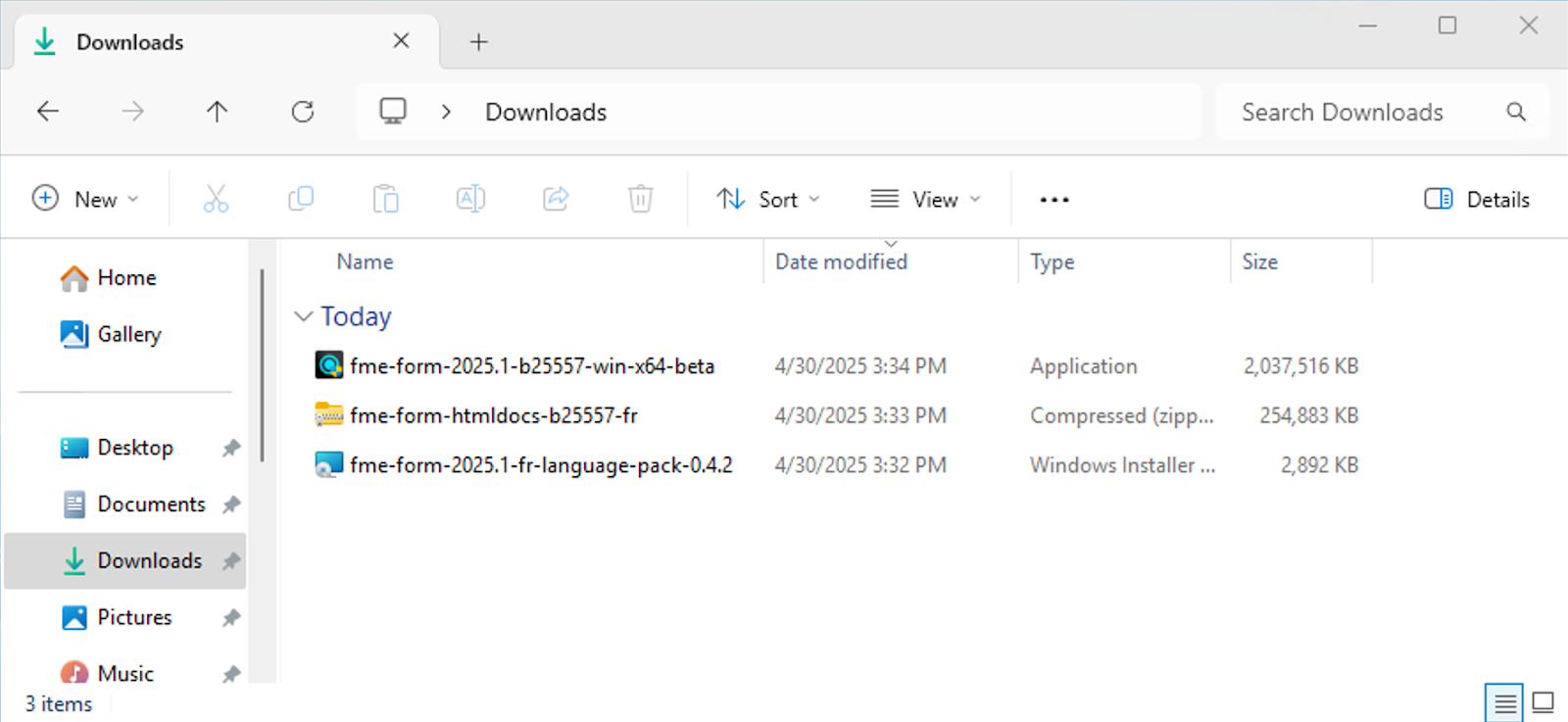

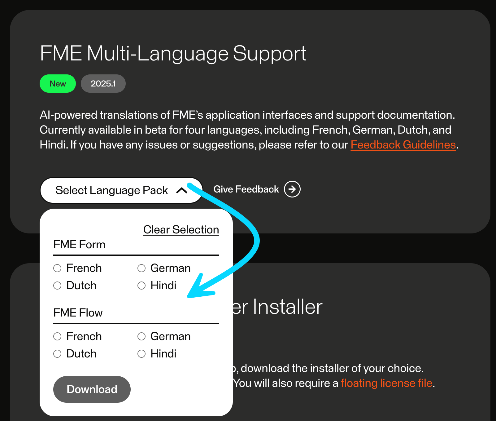

1. Download Installers
You’ll need a few installers from our Downloads page, and you’ll want to match the build versions for compatibility:
  • FME Form 2025.1 or newer
  • A matching build of the FME Form language pack
  • Offline Documentation (Optional)

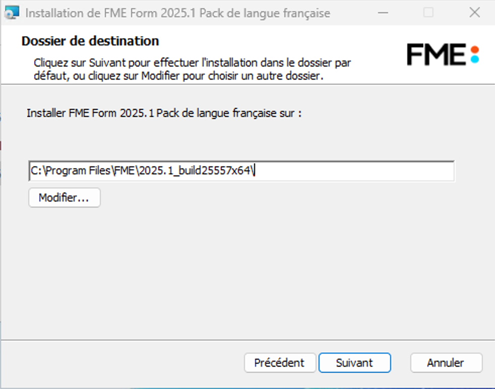

2. Install the Language Pack
Run the installer for the language pack and set the same installation path to the target FME Form version you want to apply it to. In the screenshot below, I have chosen to install the French language pack.
It is important that the language pack be installed in the exact same directory as FME.

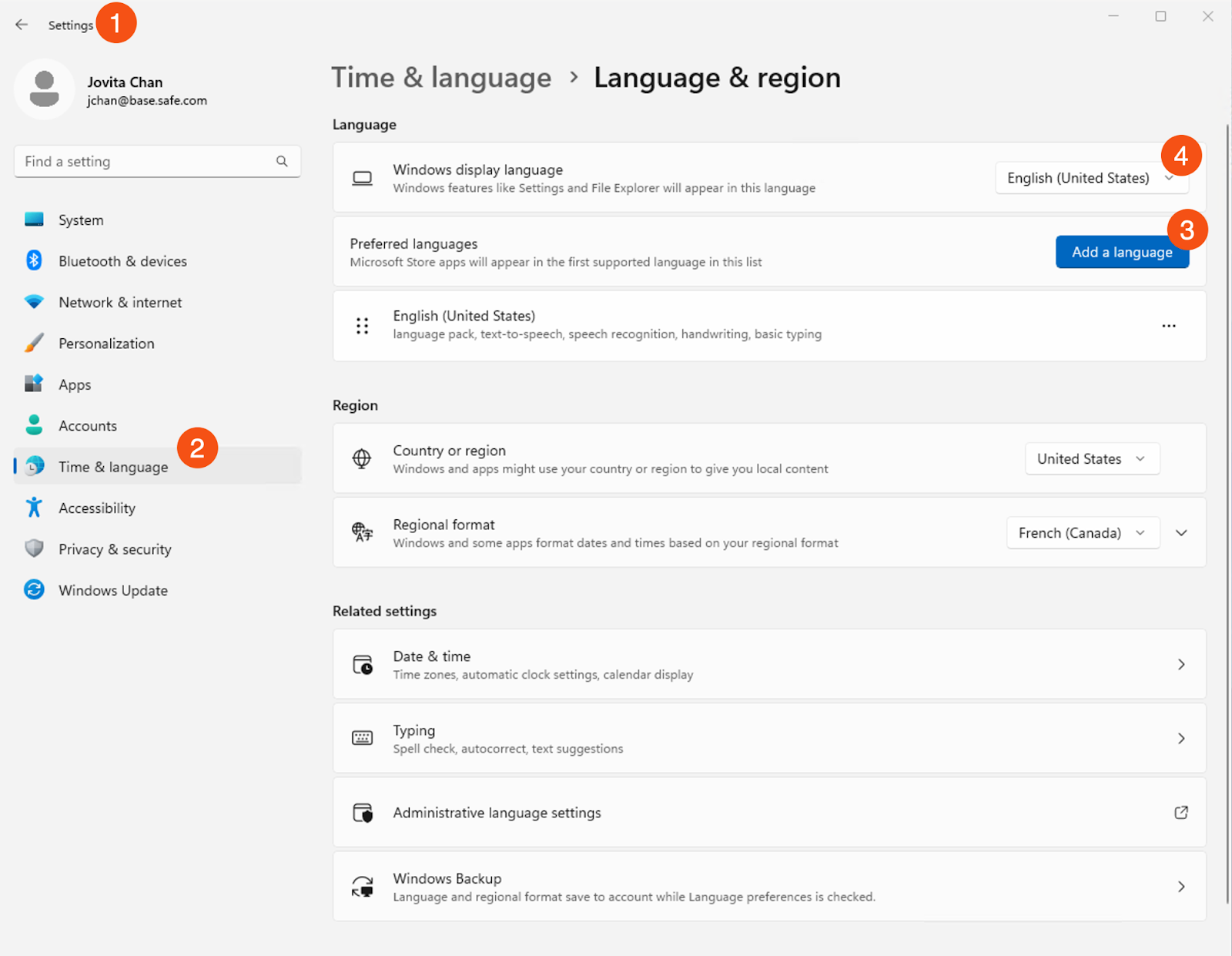

Method 1: Change Windows Display Language
The instructions and screenshot below are performed in Windows 11, so you might search in Windows for “Region” and do the same as the steps below for other supported Windows versions:
1. Go to Windows > Settings
2. Select Time & Language
3. In Preferred Languages, click Add a language, such as French, Dutch, German, or Hindi
4. Change the Windows Display Language to your chosen language
5. Windows 11 will ask you to sign out from your session for the language change to take effect. Sign out and sign back into your profile.
6. Close and reopen FME Workbench.
7. If FME does not display your language, also complete method 2.

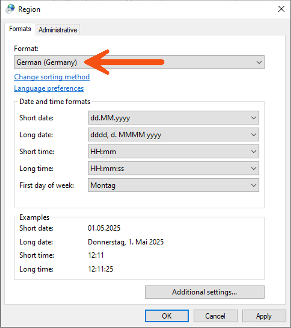

Method 2: Change Windows Region

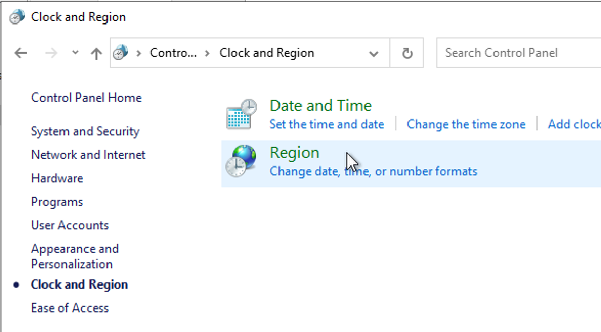

The instructions and screenshots below are performed in Windows Server 2019, so you might search in Windows for “Region” and do the same as the steps below for other supported Windows versions:
1. In the Windows Control Panel, click on Clock and Region
2. Click Region
3. In the Region dialog, change the Format to your preferred language that matches the downloaded language pack. Click Apply.
4. Close and restart FME.
5. If FME does not display your language, also complete method 1.

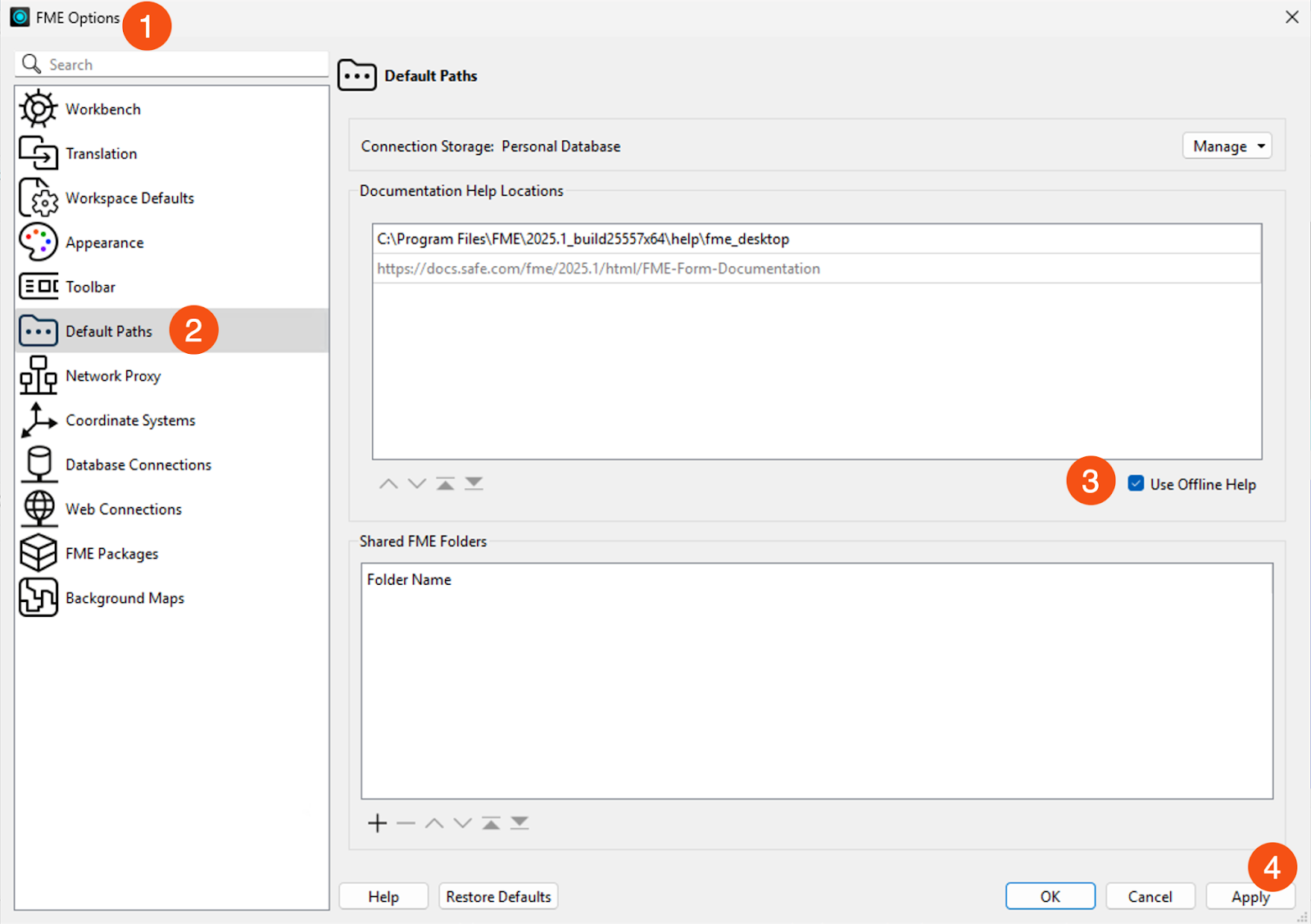

Especially if you are working with FME in a locked-down environment where you don’t have access to an internet connection, you can enable FME to use offline help by going to Tools > FME Options > Default Paths and enabling Use Offline Help.
3. Apply Changes and Reopen FME Workbench
Press ‘Apply’ and close FME. Open FME Workbench again. Add a Creator and check the Help again and it should be in your preferred language now.

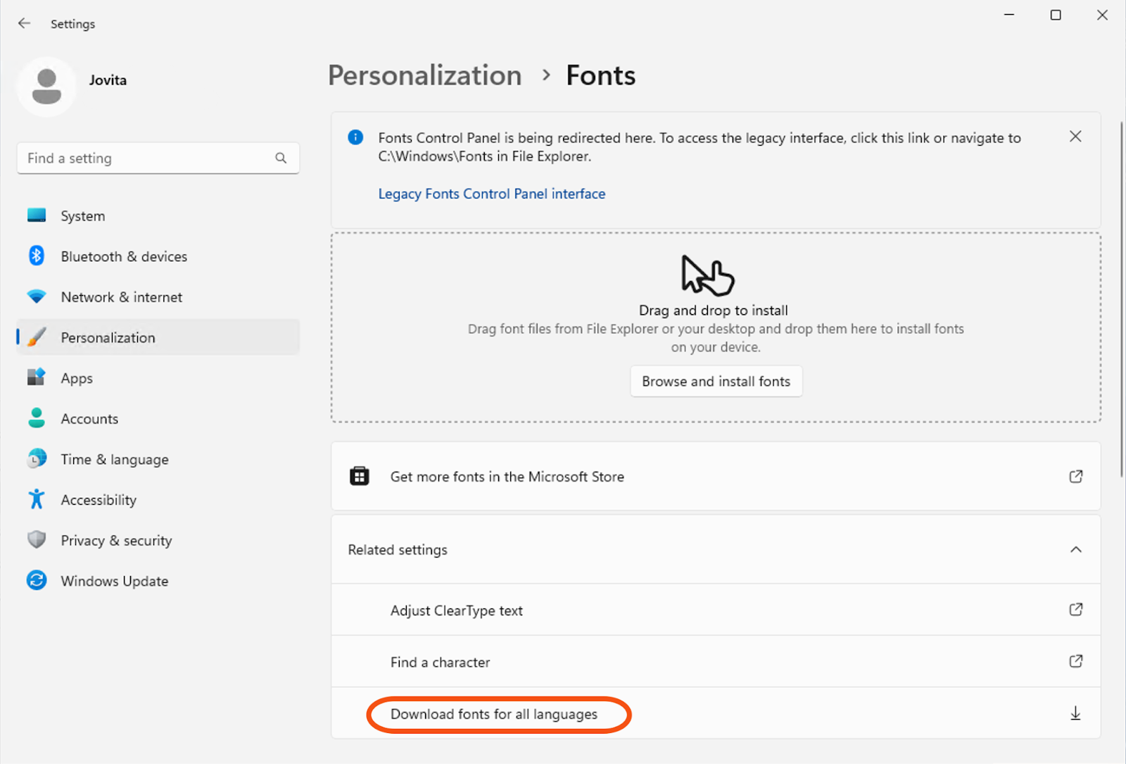

For the Hindi language pack, my Terms and Conditions look incorrect when I first open FME Workbench. What am I missing?
If your Terms and Conditions are displaying incorrectly the first time you open FME Workbench, it may be that the font needs to be installed on Windows. You can go to your Windows Settings > Personalization > Fonts > and select the ‘Download fonts for all languages’ option.
