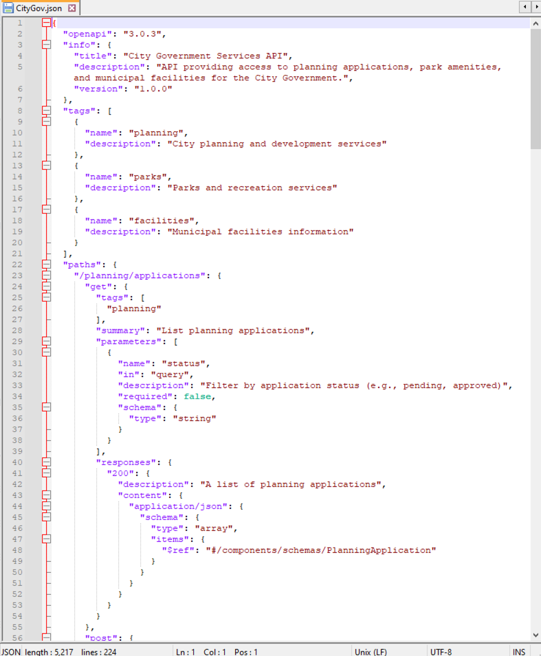

We will start with a preconfigured OAS file: CityGov.json. To familiarize yourself with the OAS, open the CityGov.json file using a text editor, such as Notepad++. This JSON document organizes information about multiple departments in a municipal government.

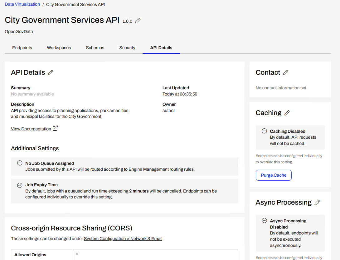

3. Review Swagger Documentation
After the CityGov.json file has been successfully imported, the API Details page for the Data Virtualization API opens. This page provides a summary of key information about the API and allows you to manage its settings.
Additional configurations like Caching, Async Processing, Job Expiry, Queues, and Security can be added and updated after import.

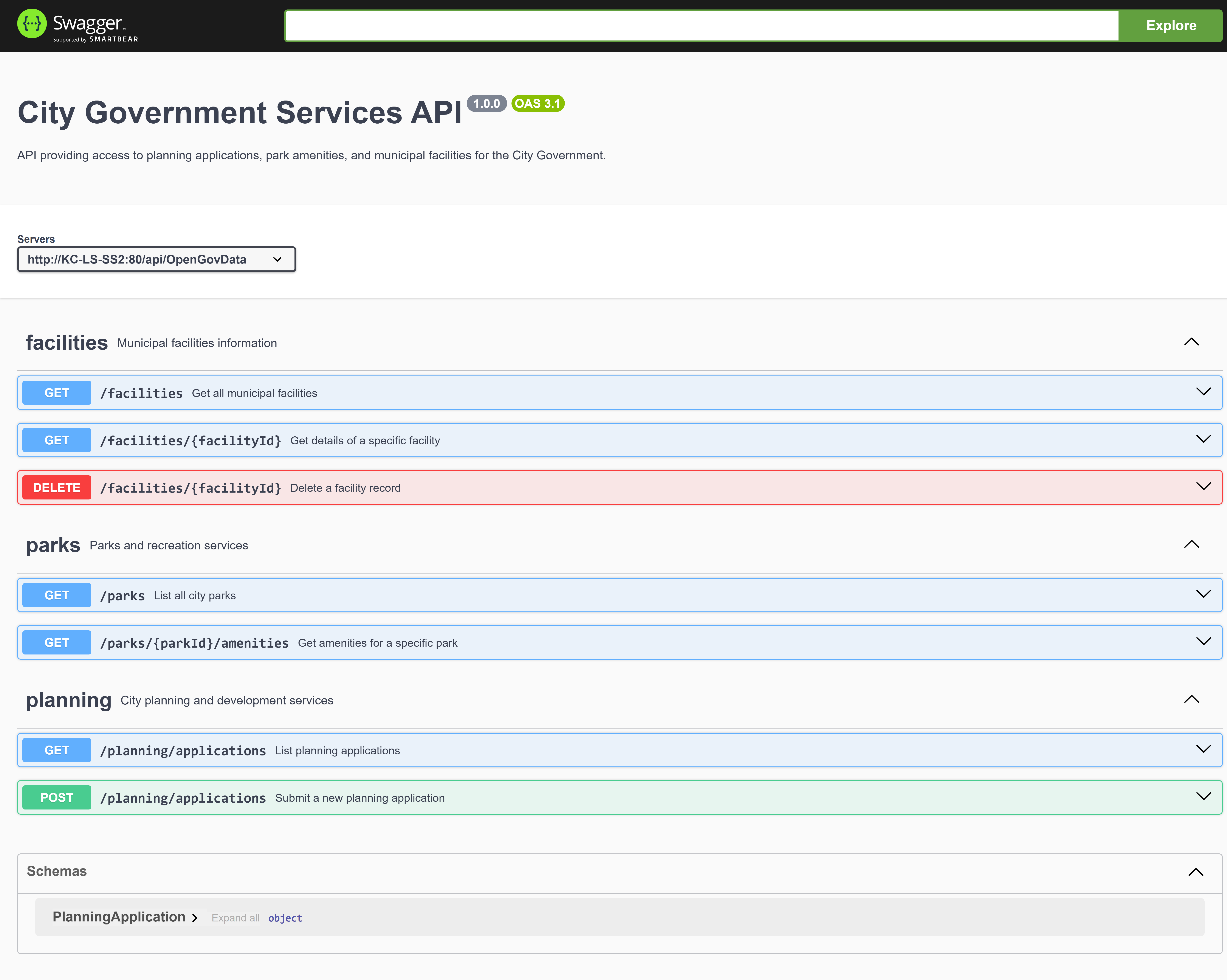

To view the API documentation, go to the API Details section and select View Documentation.
This will open the Swagger documentation in a new tab.
Swagger documentation has been automatically generated based on the imported OAS. Expanding each endpoint allows users to view imported details such as required parameters, possible responses, and associated schemas.
localhost_fmeserver_swagger-ui__api=f61a9c88-652c-4377-b192-6398ed0e6321(High Res Flow).png
At this point, making requests from the Documentation or another Client to the imported API will not be successful. This is because the underlying workflows that generate responses have not been configured yet. To make imported OAS files interactive in FME Flow, generate and author responses for each endpoint.

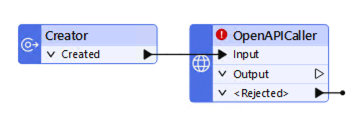

Open a new workspace in FME Workbench. Add a Creator and OpenAPICaller to the canvas.

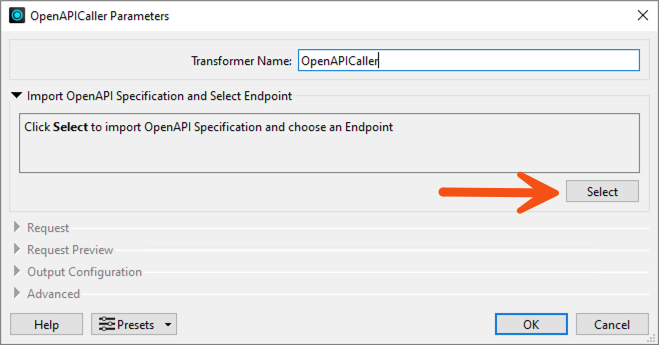

In the OpenAPICaller, use the Select button to Import.

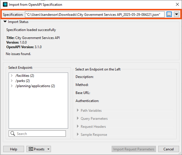

In the Specification, find the downloaded JSON file for the City Government Services API.
3. Review Endpoints
The Select Endpoints window lists all the API endpoints included in the Specification, along with their parameters and requirements.
Choose one and select Import Request Parameters.
The endpoint then auto-populates the OpenAPICaller parameters, leaving only the values for configuration.

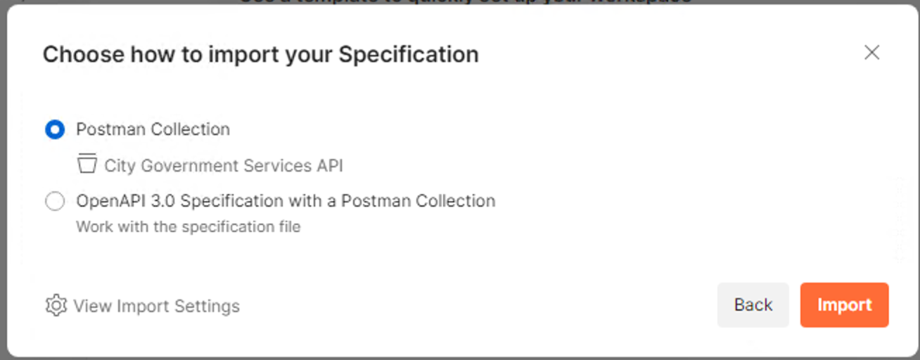

4. Import to Postman

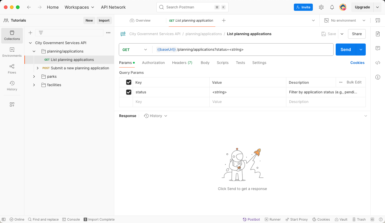

Postman is a widely used third-party tool for API development and testing. With a free account, you can import and work with OpenAPI Specifications directly in Postman. It is especially useful for testing client requests while developing a Data Virtualization API or building workflows that rely on that API.
Open Postman from your desktop and select the Import button.
Find and select the downloaded City Government Services API OAS file.
Choosing "Create a Postman Collection" imports only the requests for testing and usage, without retaining the original OpenAPI structure. Selecting "OpenAPI 3.0 Specification with a Postman Collection" imports both the spec and a synced collection, allowing you to view, edit, and manage the spec within Postman. For basic testing, choose the Postman Collection.
Once imported, the City Government Services API and all its endpoints are fully testable and configurable, directly from Postman.
