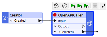

  • Add an OpenAPICaller to the canvas. Open the OpenAPICaller's properties by double-clicking on the transformer or selecting the cog icon from the mini menu.
  • Add a Creator transformer to the canvas. To add a transformer to the canvas, click the highlighted button in the menu bar or type the name directly on the canvas. The Creator parameters can be left as default.
    Next, add an OpenAPICaller transformer and connect it to the creator.
