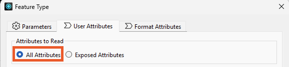

The behavior of attributes with Date only, Time only, Timestamp offset, or Big integer data types varies depending on whether you have opened the Feature Type's Parameters.
  • If you open the Feature Type Parameters and click OK, even without making any changes:
    All attributes with Date only, Time only, Timestamp offset, and Big integer data types will become unexposed.
  • If you do not open the Feature Type Parameters:
    Attributes with Date only, Time only, Timestamp offset, or Big integer data types will remain visible in both the Visual Preview and Feature Information pane.

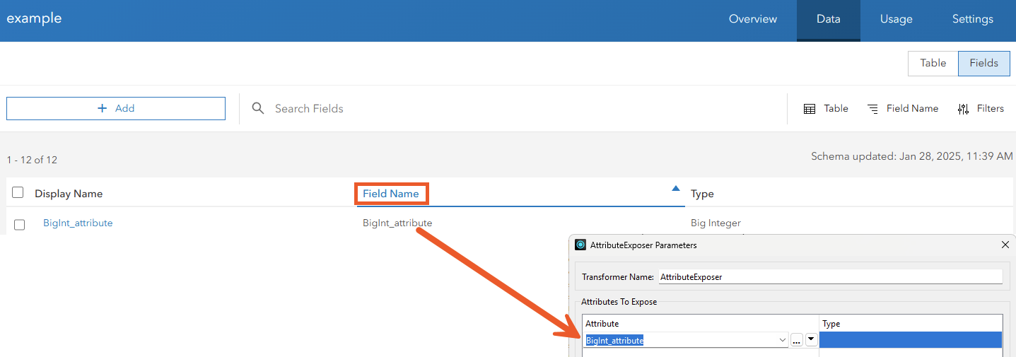

Method 1: Reader (Opened Feature Type Parameters) + AttributeExposer
To expose attributes with Date only, Time only, Timestamp offset, or Big integer data types, you'll need to open the Feature Type Parameters, click on User Attributes, and select "All Attributes" for Attributes to Read, then click OK on the Feature Type Parameters.
Then, add AttributeExposer to the canvas, connect it to the reader, and manually specify the attribute names containing Date Only, Time Only, Timestamp offset, or Big integer data types. The attribute names you specify must exactly match the Field Name values to be exposed, including case sensitivity, otherwise there will be no values for the intended attributes.

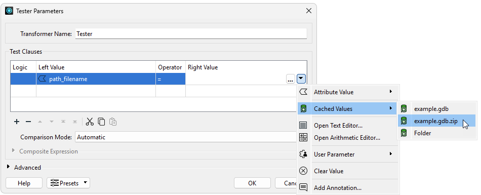

4. Add a Tester to the Canvas
Add the Tester transformer to your canvas then connect this transformer to your Directory and File Pathnames Reader then open its parameters. In the parameters, set the Left Value as "path_filename". For the Right Value, use the downward arrow to access Cached Values and select your zipped File Geodatabase.

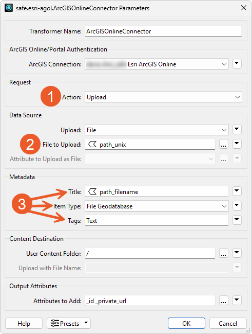

Double-click on the ArcGISOnlineConnector to configure the transformer's parameters. If you have previously set up an ArcGIS Online/Portal connection, you can select that connection here. If you need to create a connection to ArcGIS Online, please refer to How to Create an ArcGIS Online Web Connection (OAuth 2.0), and if you need to create a connection to ArcGIS Portal, please refer to How to Create an ArcGIS Enterprise Portal Web Connection (OAuth 2.0).
  1. In the Request section of the Parameters, select Upload for the Action.
  2. In the Data Source section, select the dropdown arrow next to File to Upload, select path_unix
  3. In the Metadata section, you can either specify a name or use the path_filename for the Title field. For Item Type, select File Geodatabase.
    Then in the Tag Field, write a text relevant to your data.
  4. In the Content Destination section, you can specify a specific folder within the content folder. By default, the uploaded file will not be in a specialized folder in the ArcGIS Online/Portal.
  5. You can manually specify the Title.
Click OK to close the parameter dialog.

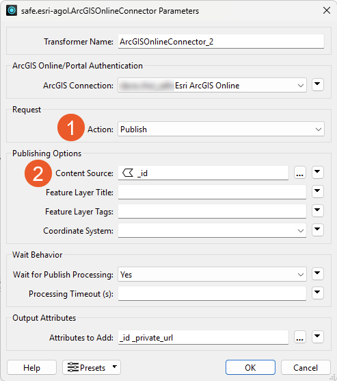

6. Add Another ArcGISOnlineConnector
Add a new ArcGISOnlineConnector and connect it to the existing ArcGISOnlineConnector. This new ArcGISOnlineConnector will be used to publish this File Geodatabase as a Feature Service.
Open up the parameters.
  1. In the Request section of the Parameters, select Publish for the Action.
  2. In the Publishing Options section, for the Content Source, select _id
  • You can specify name for the Feature Layer Title, otherwise the name used for the title for the previous ArcGISOnlineConnector will be used.
