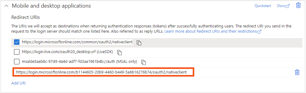

3. Add the Platform and Redirect URI
Click Authentication and then Add a platform. Choose Mobile and desktop applications.
Add Mobile and Desktop Platform
For the Custom redirect URIs, enter:
https://login.microsoftonline.com/[TENANT ID]/oauth2/nativeclient
Replace [TENANT ID] with the value of Directory (tenant) ID from the app registration overview.
Click Configure.
Configure redirect URI
You should now see Mobile and desktop applications with the redirect URI added in the previous step enabled, as well as additional default URIs added by Azure.
Enabled Redirect URI

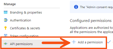

4. Add Delegated API Permissions
Click API permissions and then Add a permission.
Add API Permission
Choose SharePoint from Request API permissions.
Click Delegated permissions. Click Delegated permissions. Enable AllSites.Manage and MyFiles.Write. Click Add Permissions.
Once added, you should see the SharePoint AllSites.Manage and MyFiles.Write permissions in the list of Configured permissions.

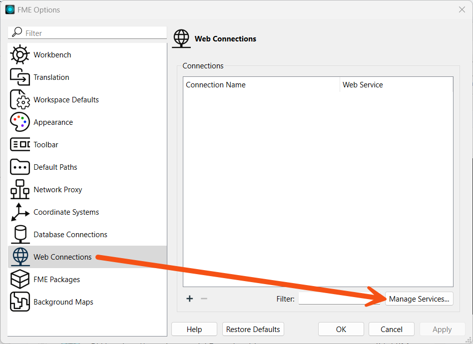

1. Open Web Services
In FME Form, go to Tools > FME Options > Web Connections > Manage Services.

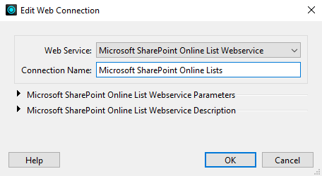

5. Create the Web Connection
From Web Connections, click the plus (+) button to add a new connection.
Choose the web service you created and give the connection a unique name. Click OK.
You will be prompted again to authenticate with Microsoft.
After successfully authenticating, your web connection and service are ready to use in FME Form. Note that the Microsoft account you authenticate with must have access to the SharePoint lists you want to connect to in FME.
