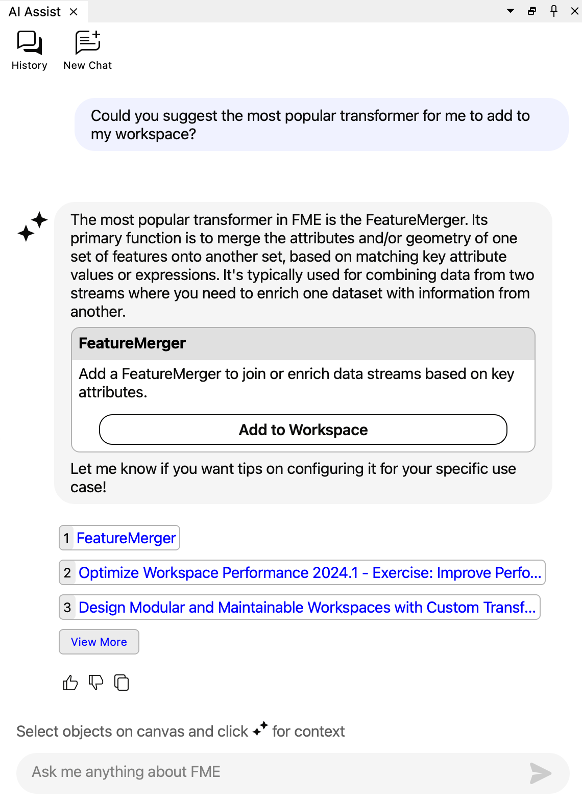

- Conversational Guidance: A conversational interface that helps users understand, debug, and improve their workflows by referencing relevant Workspace Context. AI Assist enables users to retain and access their chat history across sessions, so they can revisit past conversations. Tying chat data to individual users improves continuity in problem-solving and the overall AI Assist experience.

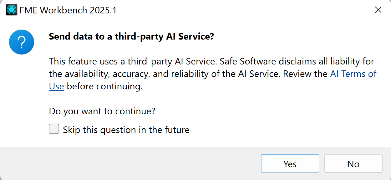

AI Assist requires user consent after logging in with an existing free FME Account via a pop-up dialog before any data is transmitted to the AI service.
FME Account OAuth Window Opt-in User Consent Pop-Up Dialog

AI Assist can suggest actions, such as adding transformers and annotations, but will rely on the user to implement them by clicking “Add to Workspace”.

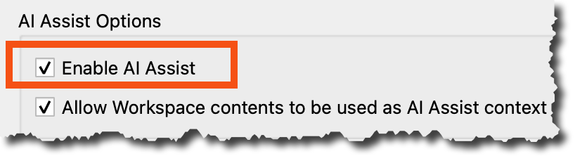

How can I Enable/Disable AI Assist?
In FME Workbench, go to FME Options > Workbench > AI Assist Options and uncheck “Enable AI Assist.”

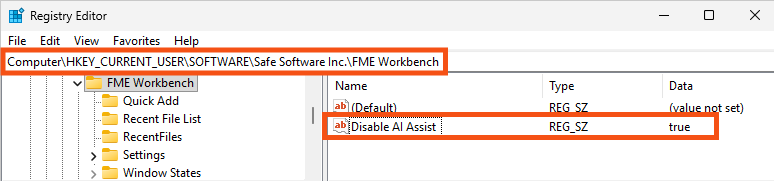

For system administrators, starting in FME 2026.1, you can similarly enable and disable this setting at the machine level using administrative tools, like Windows Group Policy. With this approach, non-administrator users can't re-enable AI Assist from the FME Workbench UI. The method depends on your operating system - please see below. FME Workbench must be restarted after making the change.
Windows
A machine administrator can disable AI Assist in the Windows Registry. In the Registry Editor, navigate to \HKEY_LOCAL_MACHINE\SOFTWARE\Safe Software Inc.\FME Workbench or create the FME Workbench key if it does not exist. Add the string entry Disable AI Assist and set the value to true.

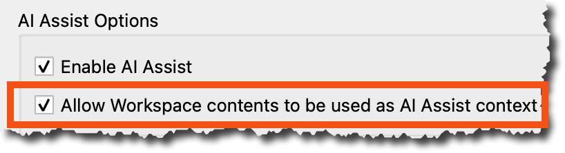

sudo defaults write "/Library/Preferences/com.safe-software-inc.FME Workbench.plist" "Disable AI Assist" -bool YESHow can I Disable Workspace Context Sharing?
In FME Workbench, go to FME Options > Workbench > AI Assist Options and uncheck “Allow Workspace contents to be used as AI Assist context.”
Disabling this option turns off context-sharing for chat while retaining access to the AI Assist UI. When toggled off:
- The context label is removed from the AI Assist conversation window.
- All context labels in related menus and toolbars are removed.
