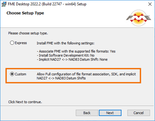

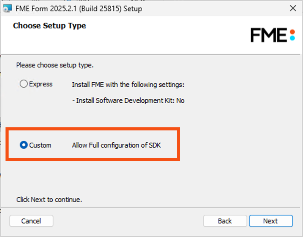

2. Select Custom
On the Choose Setup Type page of the installation wizard, select the Custom option, then click Next.

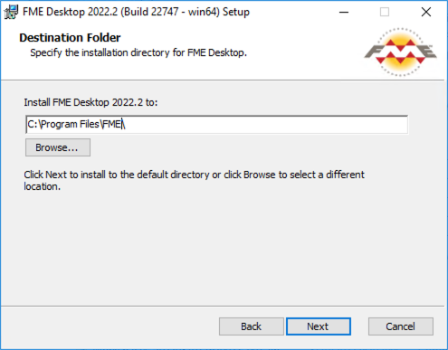

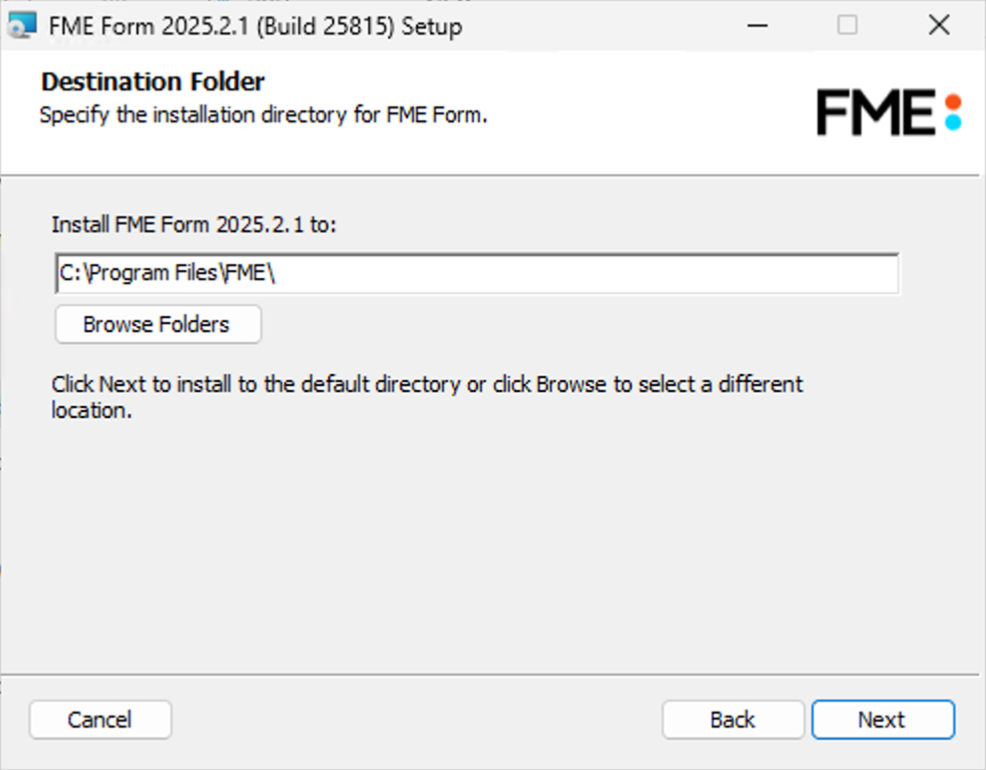

3. Specify the Destination Folder
Browse to a location to install FME Form. This location will also be where the SDK help files are located.

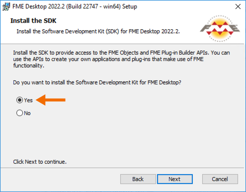

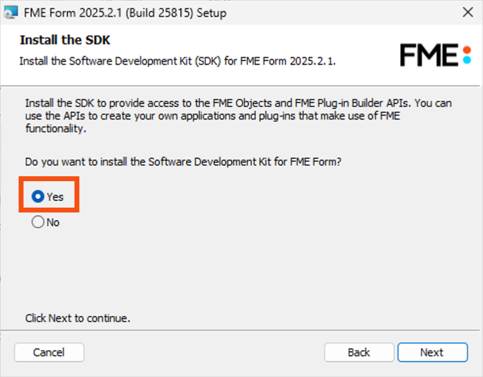

4. Install SDK
On the Install the SDK page of the installation wizard, ensure that Yes is enabled. If this step is missed, FME will need to be reinstalled. This step is only available on Windows installations; the SDK is automatically installed on macOS and Linux.

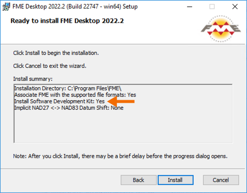

5. Confirm Installation Details
One final step before clicking Install is to confirm that the Install Software Development Kit is set to Yes. Optionally, you can also add FME to the PATH variable.

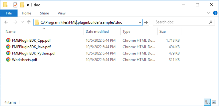

6. Find SDK Documentation
After installing FME, the SDK documentation and worksheets can be found in:
\FME\pluginbuilder\samples\doc
