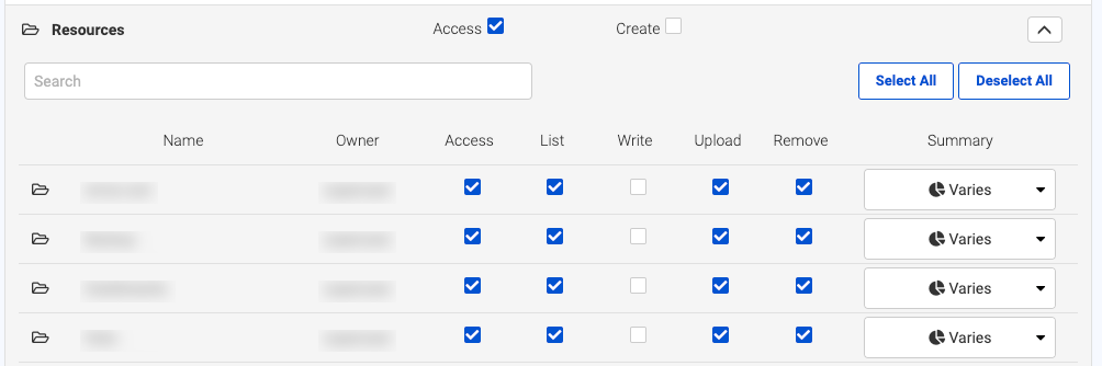

  • FME Flow administrators can limit write permission for Resources to administrators only. This can be done from the Role Management page by turning off Create permission on all Resources and turning off Write permission on each resource connection.
