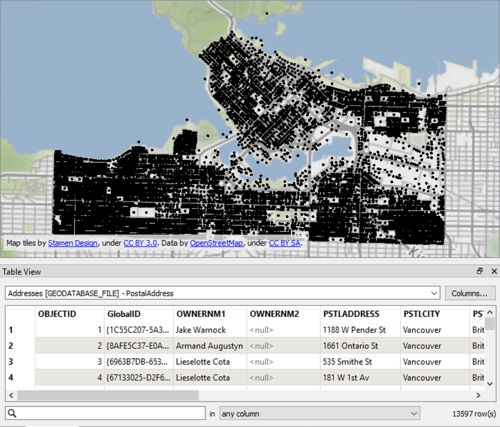

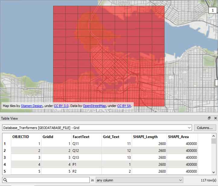

The images above show a visualization of the Grid and Address Points feature classes, along with their accompanying attributes.

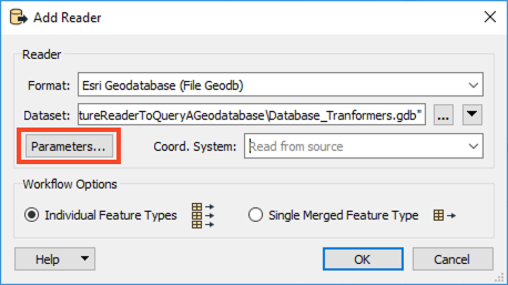

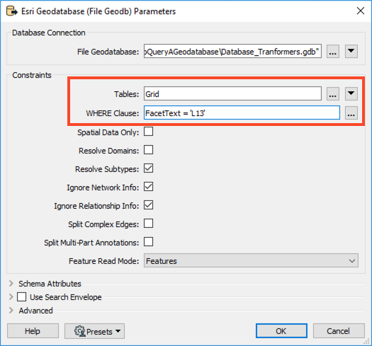

Open FME Workbench and start a blank workspace. Add an Esri Geodatabase (File Geodb) reader to the canvas and browse to the Database_Transformers.gdb dataset, which you can download from the Files section of this article. Then open the Parameters.
The Grid feature provides the spatial constraint used when querying the Address Points dataset. Instead of reading the entire Grid dataset, use the WHERE clause in the File Geodatabase reader to select a specific Grid square as the spatial constraint for the Address Points feature class. Such functionality can improve the workflow's efficiency and performance.
In the parameters, click the ellipsis next to Tables, then select Grid. Then, for the WHERE Clause, type in the following (remember to include the single quotes):
FacetText = 'L13'

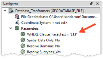

Click OK twice to finish adding the reader. The WHERE clause queries the underlying File Geodatabase and returns only the Grid square that matches the query. You can adjust the WHERE clause after adding the reader via the Navigation window.

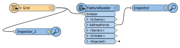

Address feature geometry is read from the source feature class using the FeatureReader transformer. The Grid square selected in Step 1 will act as the initiating feature and the spatial query for the FeatureReader.

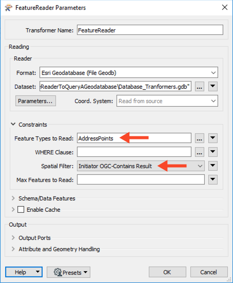

Add a FeatureReader transformer to the canvas and connect the Grid reader feature type to the FeatureReader's Initiator input port. In the FeatureReader parameters, set the Format to File Geodatabase (File Geodb) and the dataset to the Database_Transformers.gdb.
Next, click the ellipsis next to Feature Types to Read and select the AddressPoints feature class. Although you can leave the WHERE Clause empty in this case (since you already selected AddressPoints), you still need to select a spatial interaction.
Select Initiator OGC - Contains Result from the Spatial Filter drop-down menu. For examples of what each Spatial Filter does, see the documentation.

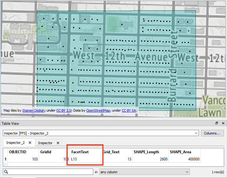

3. Visualize Result
View the data to confirm you selected the correct spatial filter. Connect an Inspector to the AddressPoints output port on the FeatureReader. Also add an Inspector to the Grid reader feature type so you can overlay the two outputs.
Run the workspace. In either Data Preview or the Data Inspector, you’ll see all of the AddressPoints contained within the selected L13 Grid square.

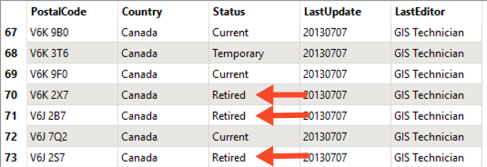

Some addresses in the dataset have a Status field with the value ‘Retired’, indicating an address that is no longer valid. You can see this in the Visual Preview table view:
Use the FeatureReader WHERE clause to filter out addresses with this status.
Note the feature counts for your chosen grid square with and without the WHERE clause. This will help confirm the query is operating correctly. For example, square L13 should have 307 addresses in total or 278 when excluding retired addresses. See the attached FeatureReaderToQueryAGeodatabase_Advanced.fmwt for the correct answer. For more information on writing WHERE clauses, see the W3Schools tutorial.
