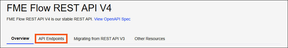

To find this, go to http://<yourServerHost>/fmeapiv4/docs/index.html where <yourServerHost> is your server hostname.
Once on that page, click on the API Endpoints link.

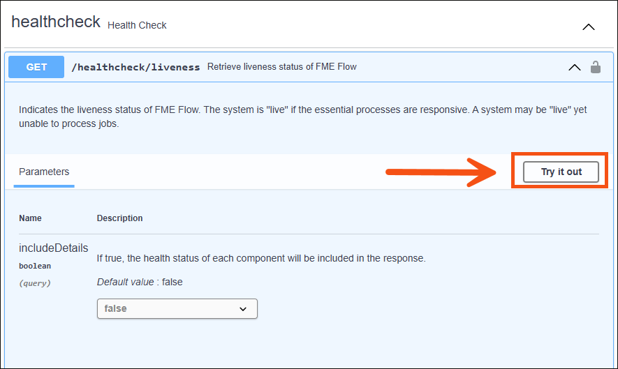

Here, you can explore the various calls you can make to FME Flow. Find the category called health check and expand the call. You should see this documentation at the top.
This page outlines everything you need to know about the call. Click "Try it out." This will connect to your server and provide a response to your call. However, before you receive a response, you will have to connect to your server.

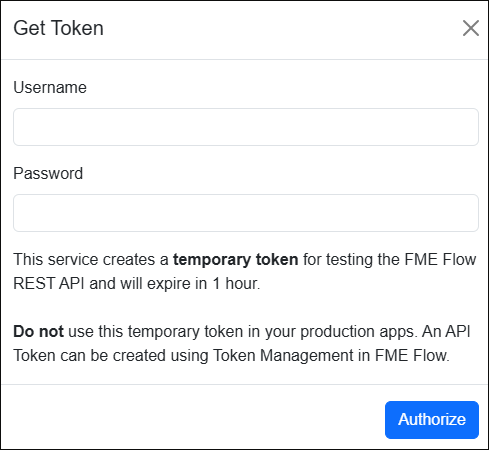

You will be prompted for the server username and password. Here, you will need to request a token to complete your call.
Next, click Authorize. The token should now be in the top right-hand corner of the page. Once you click "Try it out," the call can be made.

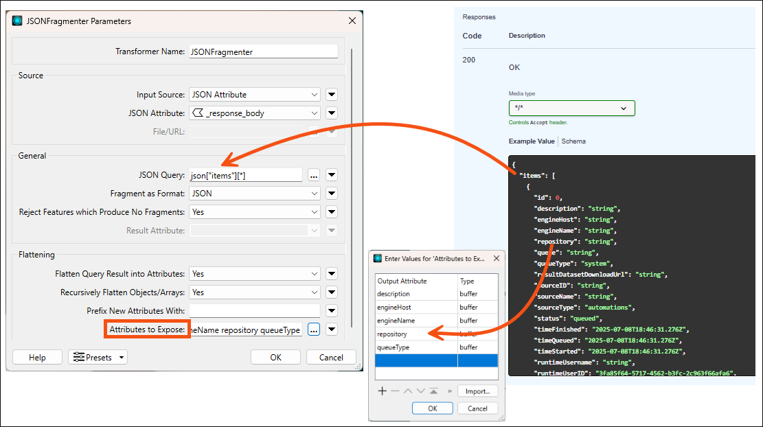

The majority of FME Flow REST API calls return their response as JSON. Therefore, to work with the job statistics in FME, the JSON string must first be parsed and broken into attributes. The JSONFragmenterJSONFlattener, and JSONExtractor can be used to perform this action. The tutorial Getting Started with JSON provides an overview of reading, writing, and transforming JSON data using FME.
