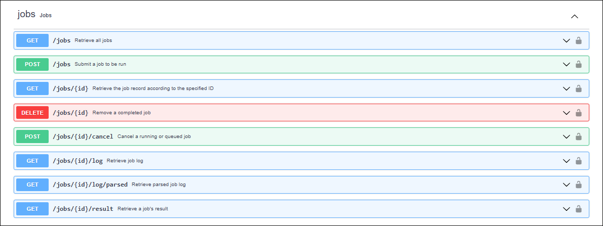

1. Review the FME Flow API Documentation
To start, review the REST API documentation by going to http://<yourServerHost>/fmeapiv4/docs/index.html where <yourServerHost> is your server hostname. If you access the REST API documentation from your FME Flow through the Help Resources icon, you can even test REST API calls out through the web interface.
Alternatively, you can access the documentation here.
Once on the REST API documentation, select the API tab. Then, scroll and select jobs. This section shows all REST API calls related to job routing and history.
Find GET /jobs. Once there, review the documentation. Notice the response is listed and it shows where to find the total count.

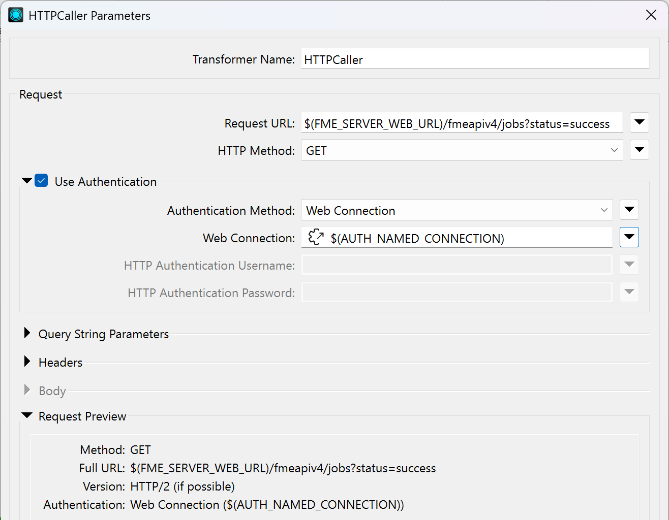

Add an HTTPCaller to the workspace and attach it to Creator_2. Open up the HTTPCaller and set up the following parameters:
  • Request URL: $(FME_SERVER_WEB_URL)/fmeapiv4/jobs?status=success
  • HTTP Method: GET
  • Use Authentication: Enabled
    • Authentication Method: Web Connection
    • Web Connection: $(AUTH_NAMED_CONNECTION)
      • Click the drop-down arrow, hover over User Parameters, and select $(AUTH_NAMED_CONNECTION)
Then click OK.

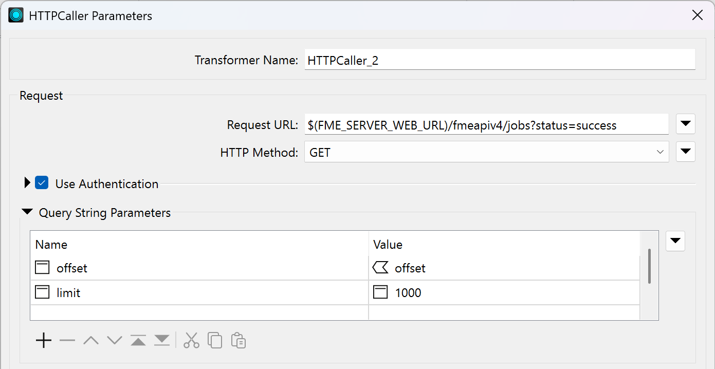

7. Run the 1c. Fetch Results Bookmark
Here, the HTTPCaller is used to fetch the remaining results, if there are any. The offset is used to tell the API where to start fetching the next 1000 records.
