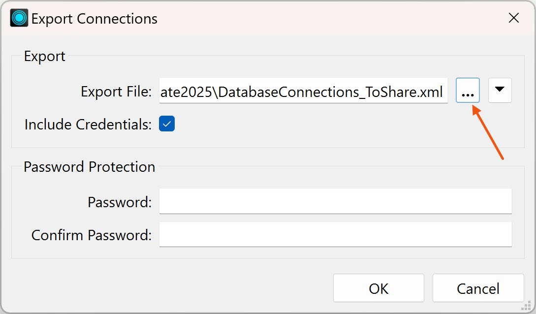

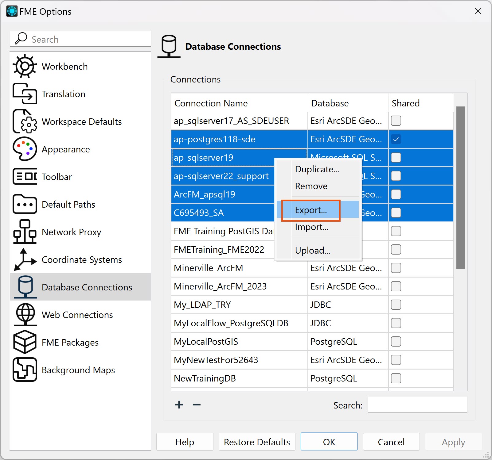

1. Export the Database Connections to Share
In FME Workbench, navigate to Tools > FME Options > Database Connections. Then, highlight the connection(s) to share, right-click, and select Export from the dialog that opens.
The Export Connections dialog will open. Select the ellipses to the right of the Export File parameter, and specify a name and location for the XML file that will contain the exported connections. Be sure to specify a name that indicates these will be exported database connections, not web connections. You can also choose to include the credentials tied to the connections if you wish.

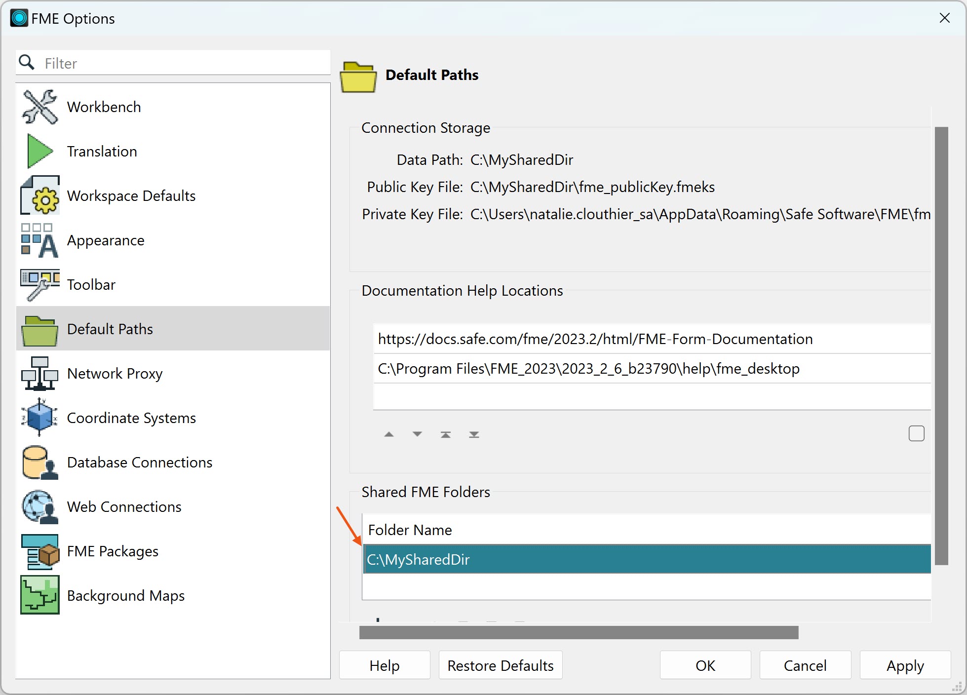

3. Create an Empty Shared Connections Database with its Public / Shared Key File, in the Target Shared Directory
Still in FME Options, select the Default Paths menu at left. Based on the version of FME Form in use, follow the instructions below that best meet your needs.

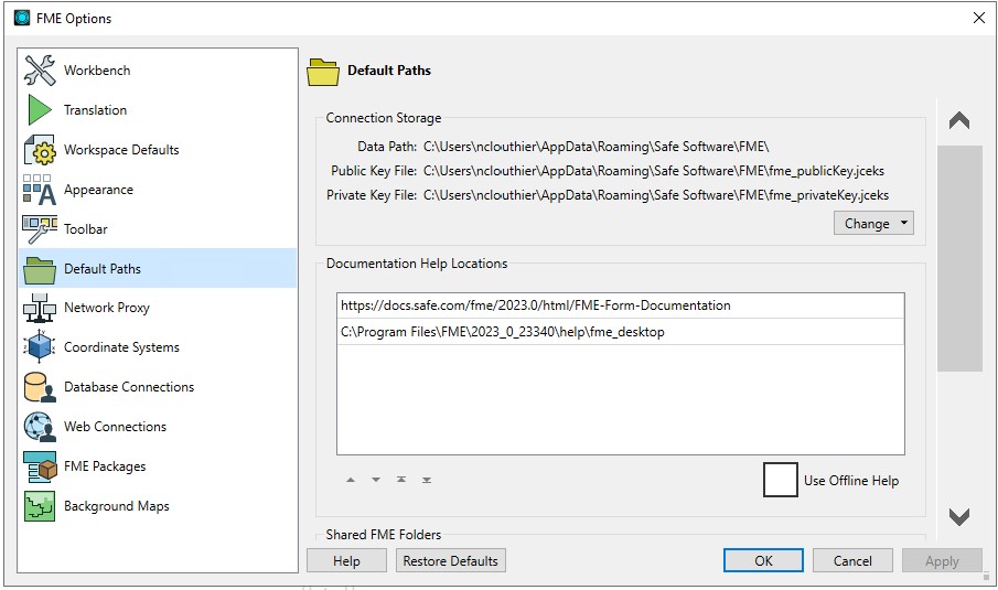

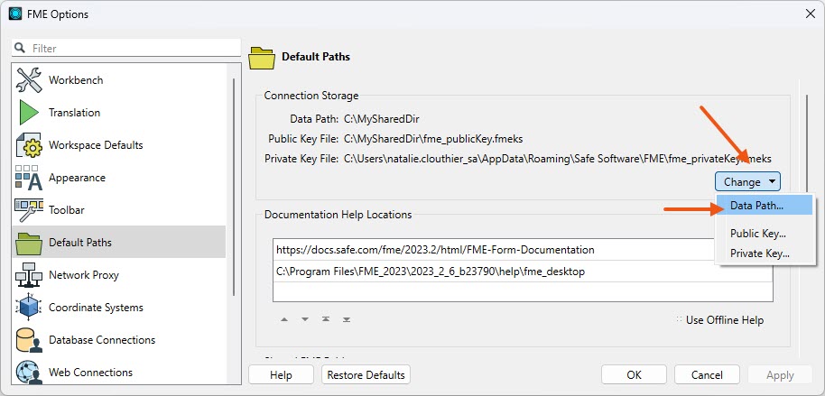

For FME Workbench 2023.x and below, perform the following adjustments from the Default Paths menu:

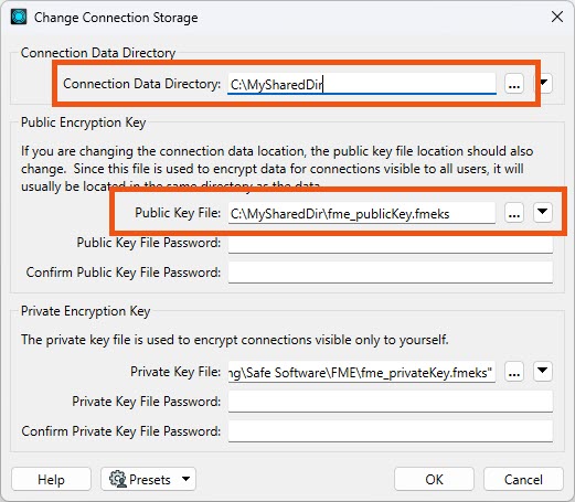

  • Select the Change drop-down menu at the bottom right of the Connection Storage parameter box
  • Choose Data Path from the drop-down options presented
  • In the Change Connection Storage dialog that opens, use the ellipses next to the Connection Data Directory parameter, and navigate to the target shared directory where your new, empty fme_connections.data file will be created. This is your named connections storage database file.
  • Choose the ellipses next to the Public Key File parameter, and again navigate to your target shared directory where your new public encryption key will be created for your new, empty connections database.
  • Do not change the value of the Private Key File parameter.
  • Select OK on the Change Connection Storage dialog to return to the Default Paths menu.

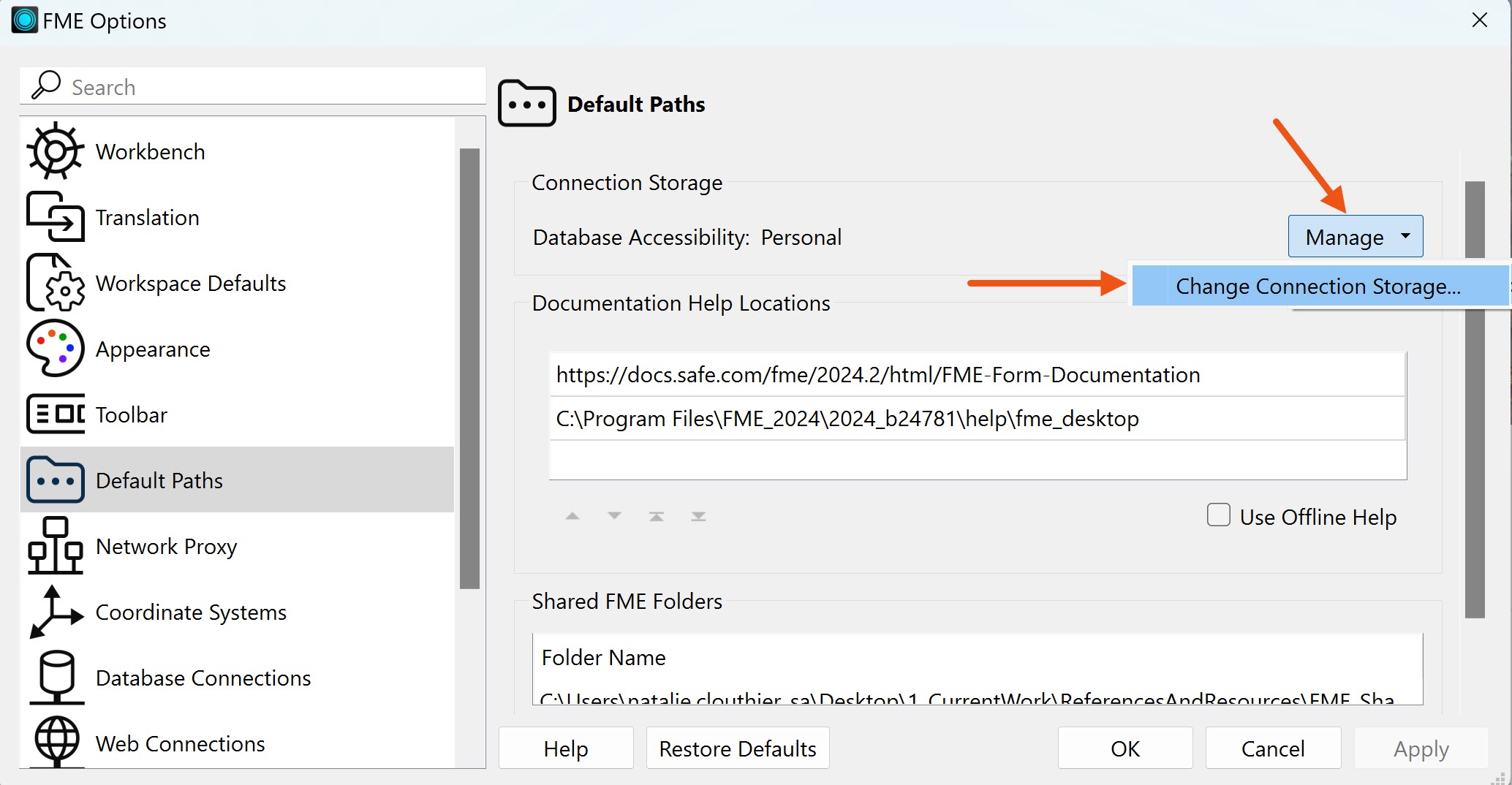

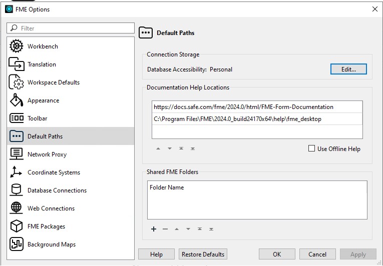

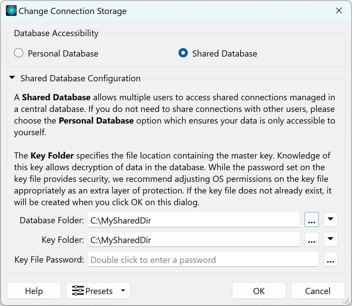

For FME Workbench 2024.x and newer, perform the following adjustments from the Default Paths menu:
  • Select the Manage drop-down menu in the Connection Storage parameter group
  • Choose Change Connection Storage
  • In the Change Connection Storage dialog that opens, choose the Shared Database option for Database Accessibility.

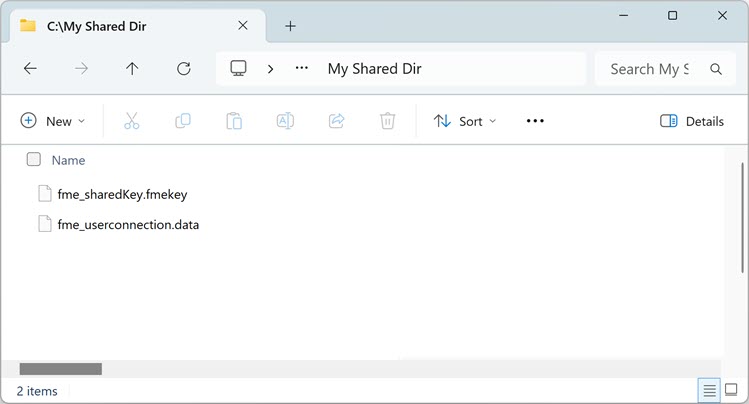

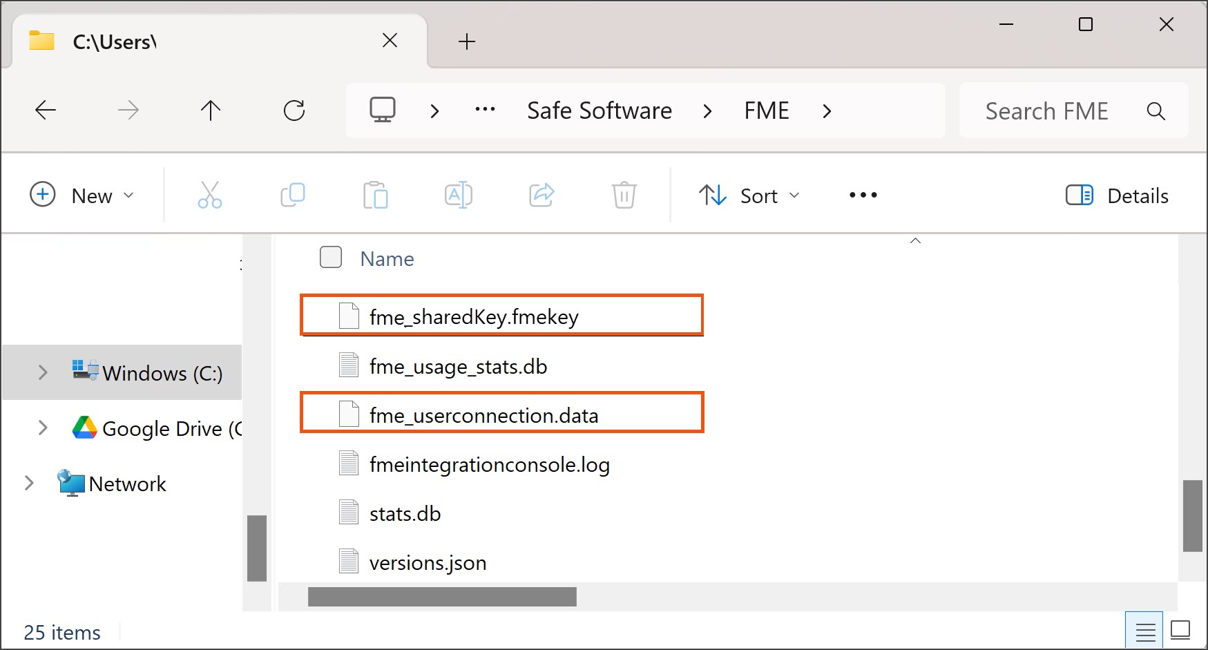

  • Next, select the ellipses to the right of the Database Folder parameter that appears, and navigate to the target shared directory where your new, empty fme_userconnection.data file will be created. This file is your shared named connections database file.
  • The Key Folder parameter's value should auto-populate with the same shared directory file path chosen for the Database Folder parameter. If this does not occur, use the ellipses to the right of the Key Folder parameter, and navigate to the target shared directory.
  • You can optionally create a password for the fme_sharedKey.fmekey file by entering a value into the Key File Password parameter's text box. This password creation is recommended as an added security measure.
  • Choose OK on the Change Connection Storage dialog to return to the Default Paths menu. If you choose not to create a key file password, you will receive a warning that you must acknowledge.

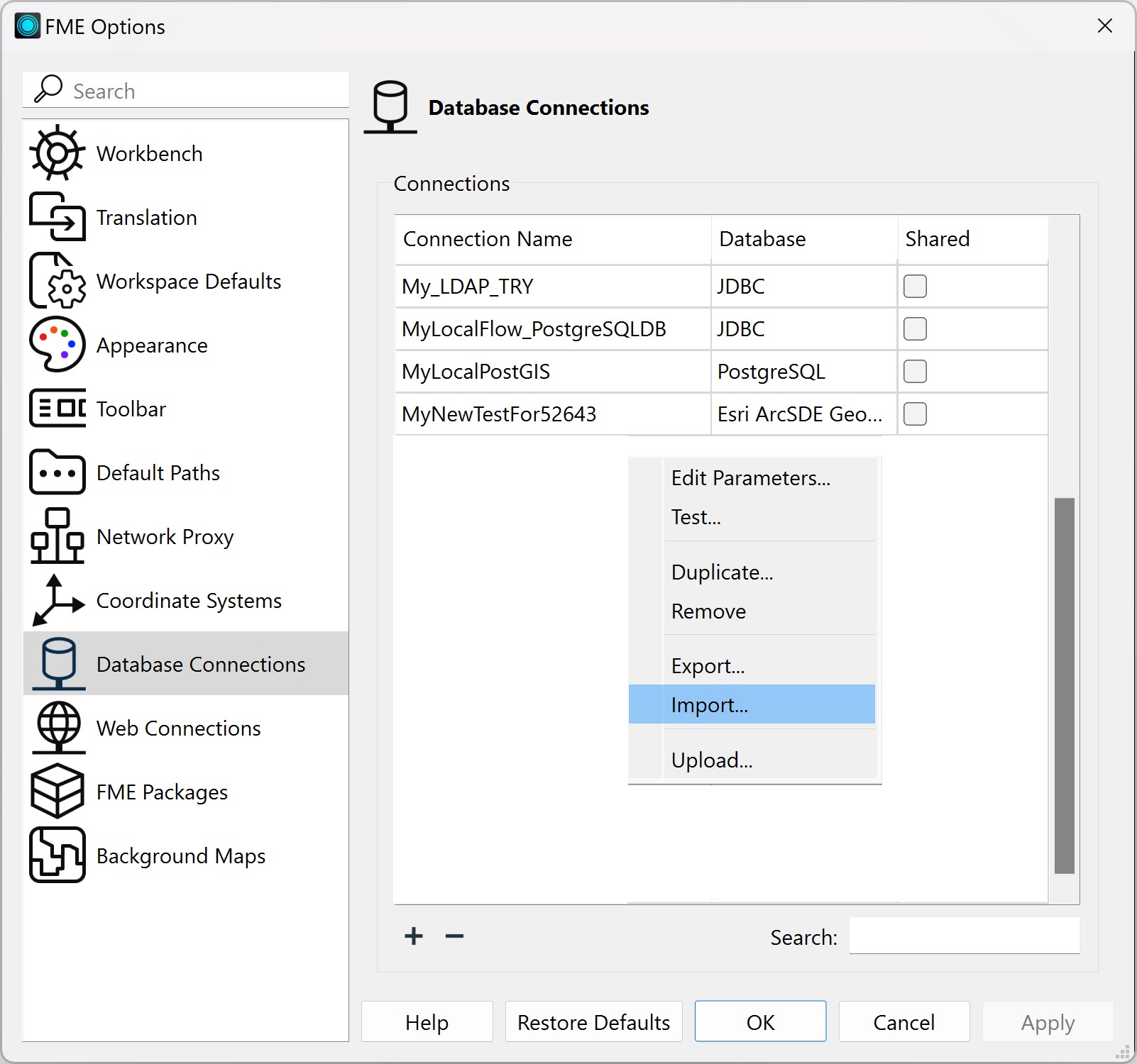

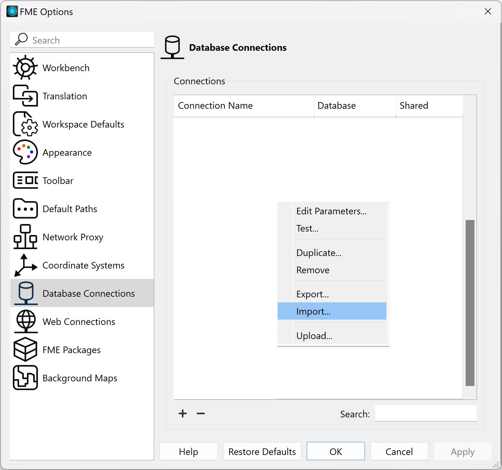

4. Import the Database Connections to Share to the New Shared Connections Database

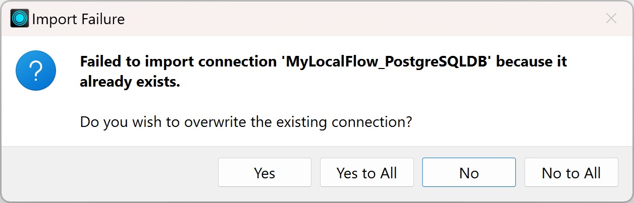

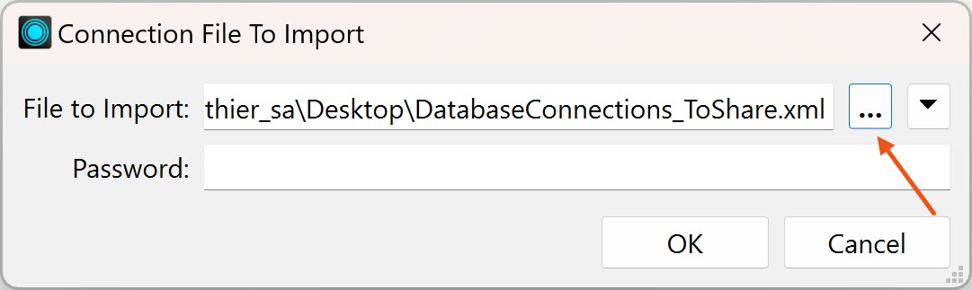

Still in FME Options, select the Database Connections menu option. To import the database connections that were exported in Step 1 to the new shared connections database, right-click in the blank Connections table shown in the right-side pane of FME Options and select Import.
In the Connection File to Import dialog that opens, select the ellipses to the right of the File to Import parameter. Navigate to the exported database connections .xml file generated in Step 1. Select Open, and then choose OK.

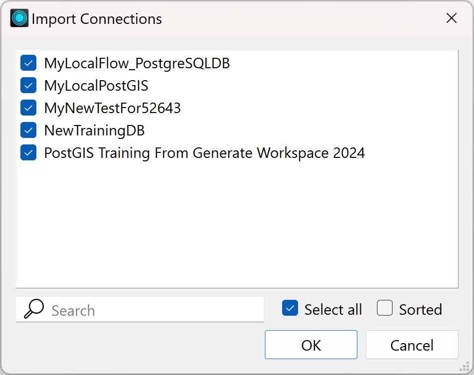

A list of available exported database connections displays; select the connections you would like to import and click OK.
Your imported database connections should now be visible in the Connections table shown in FME Options > Database Connections.

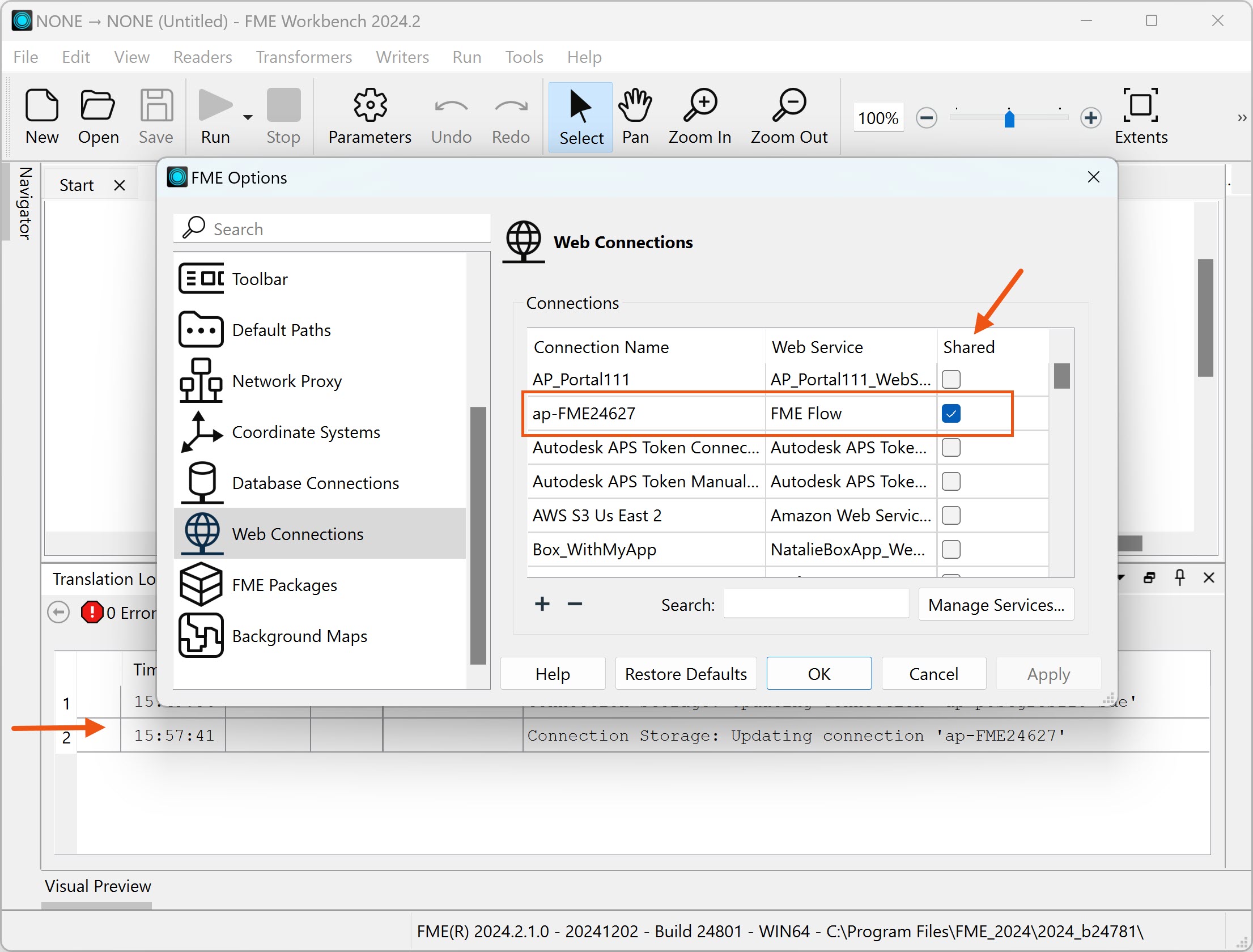

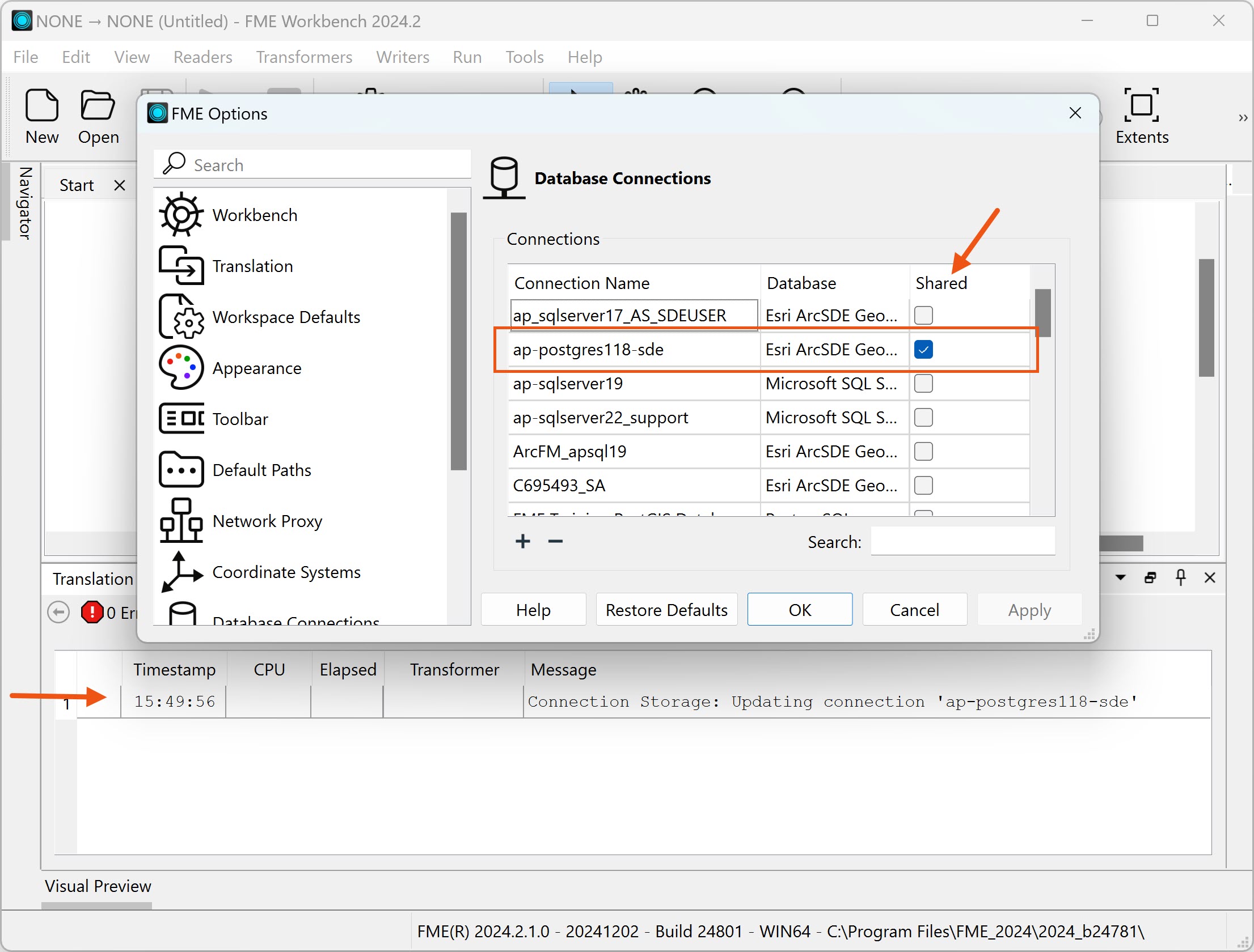

6. Toggle the New Public / Shared Setting for Imported Database and Web Connections
Return to the Database Connections menu of FME Options, and have a look at the Connections table shown in the right-side pane. The table will now show a new field:
  • Public (FME Form 2023 or below); or
  • Shared (FME Form 2024+)
Share the newly imported database connections by checking the Public or Shared checkbox. Each time a connection's visibility is changed from private/personal to public/shared (or the reverse), a message will appear in the Translation Log window, acknowledging this change. This message provides confirmation that the connection is now shared.
You can just repeat this process as necessary for imported web connections by accessing the Web Connections menu of FME Options.

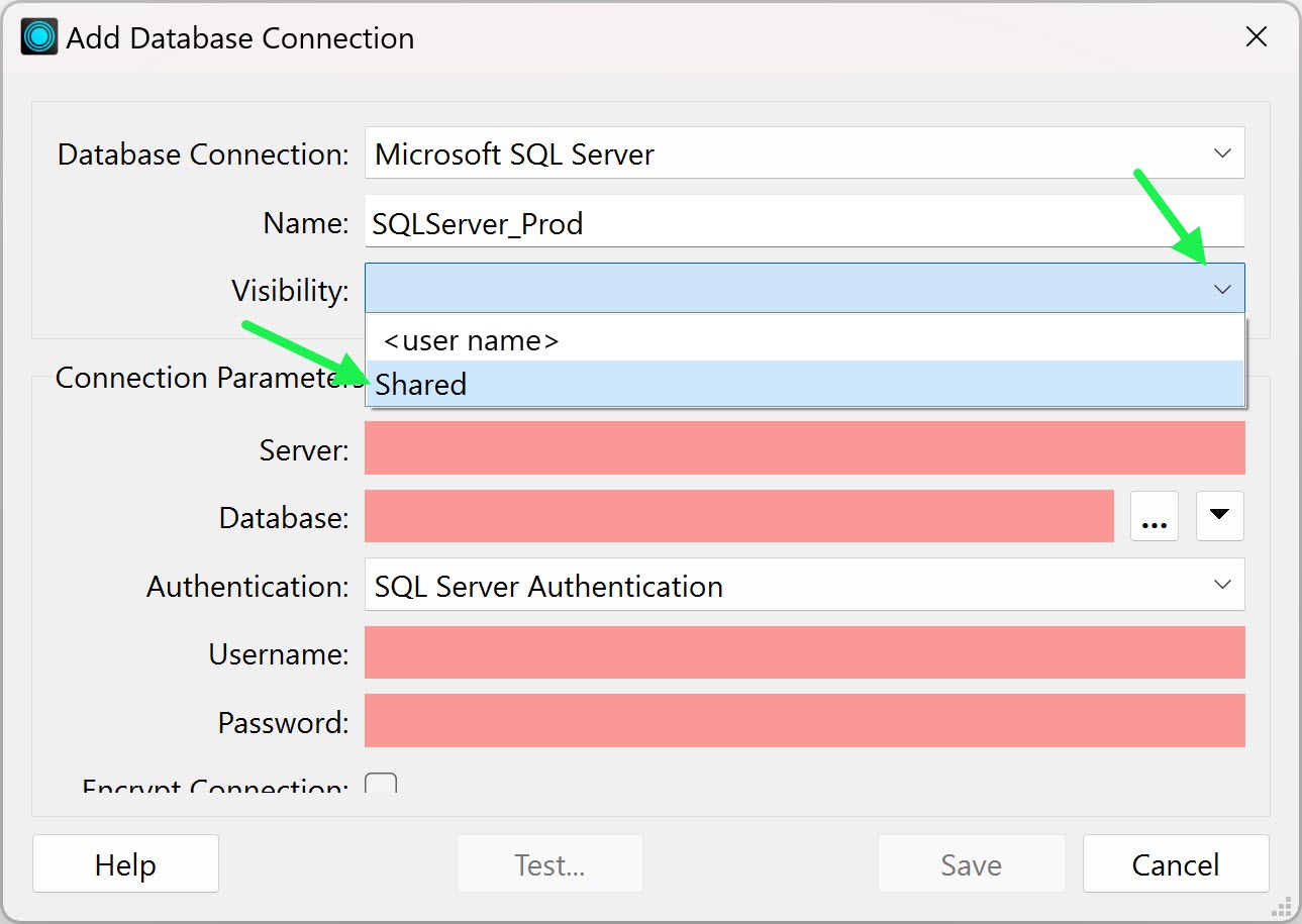

7. Establish Any New Database or Web Connections as Public or Private
From the Database Connections or Web Connections menu of FME Options, choose to add a new connection by selecting the plus (+) button just below the Connections table. In the Add Connection dialog that pops open, notice that a new Visibility parameter is now available, just below the Connection Name parameter. This new parameter allows you to set your new connection to Public or Shared as needed. If set to Public or Shared, the connection will be available to other users who have access to the shared directory shown in FME Options > Default Paths, and who have also adjusted their Default Paths values to point to this same shared directory, as per Step 3 above.

  • fme_connections.data
  • fme_userconnection.data
  • fme_publicKey.fmeks
  • fme_sharedKey.fmekey
