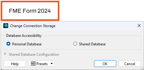

In FME Form 2024 and later:
  • Personal (formerly private) connections use the operating system’s encryption functionality, so there is no key file to manage. It also means that personal connections are now encrypted per user and machine. Since there is no longer a keyfile, it cannot be obtained and used by other people to view personal connection information
FME Form 2024 Personal vs Shared

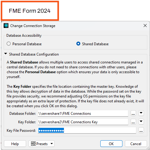

  • Shared (formerly public) connections still use a key file, but it is managed by FME Form.  Only a shared location for the key and connections needs to be specified, not the file itself. Personal connections added to the shared connections database are encrypted for the machine and user who added them - they are not encrypted using the shared key file.
FME Form 2024 Connections

  • In FME Options, set the connection Database Accessibility to Shared on both the old and new machine. On the old machine, check off any connections you want to share. The connections should be accessible from the new machine as long as both machines are pointing to the same folders for the connections database and key file.

If you need to share connections with different machines, please use a shared connections database and enable 'Shared' on the connections you want to access across different machines.
Shared Connections
You can also export connections from one machine and import them to the other, if you prefer to continue using a personal connections database. Personal connections added to a shared connection database will only be visible on the machine from where they were created by the user who created them.
