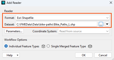

First, we need to add a source dataset. Click on the Reader button. In the Add Reader dialog, enter the following:
  • Format: Esri Shapefile
  • Dataset: Bike_Paths_L.shp
Click OK to add the bike path data to the workspace.

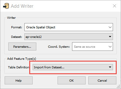

Now the data needs to go to the destination. Click on the Add Writer button on the toolbar. In the Add Writer dialog, enter the following:
  • Format: Oracle Spatial Object
  • Connection: <your database connection>
  • Table Definition: Import from Dataset...
Click OK to accept the writer parameters.

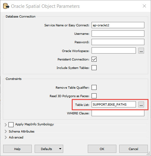

FME will prompt the user to define the Feature Types to be imported through the Import Writer Feature Types dialog. Click ‘Parameters…’, and select the target table that you would like to use for the schema. For our example, the target table is 'BIKE_PATHS'.
Accompanying data for Bike_Paths has been provided in the downloads section in a zipped format. This exercise will assume that the Bike_Paths data is loaded into your Oracle database prior to beginning step 3.
