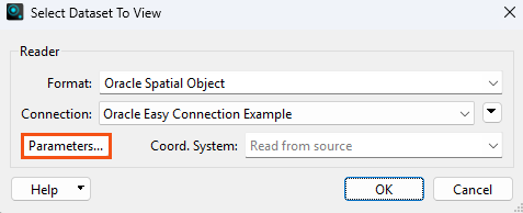

Parameters will differ depending on the database format being used, but changes to parameter settings will always be made by clicking on the “Parameters..” button on the dataset selection dialog.

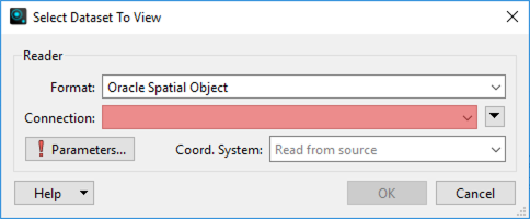

1. Start FME Data Inspector
Open FME Data Inspector. Go to Select File > Open Dataset from the menu bar.
From the Select Dataset to View dialog, choose Oracle Spatial Object as the Format. In the next step, we will define the Connection.

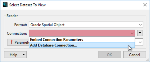

2. Define the Connection
Two methods can be used to connect to database services: Embedded Connections and Database Connections (also referred to as Named Connections).
  • Embedded connections require the user to enter connection parameters each time a user reads from or writes to a database.
  • Database connections provide a simple and secure way to store and reuse connection parameters. They are specified once, and then it is possible to reuse a previously saved connection rather than having to re-enter connection parameters each time.
For more information regarding database connections, please see Using Database Connections.
For this example, we will be using database connections so that our connection will be available in the upcoming examples.
This tutorial series does not provide public access to an Oracle database; rather, it is expected that you follow along through the exercises using your own Oracle instance. Therefore, you will need to replace the database connection parameters with your system-specific parameters. To create a database connection, click the drop-down arrow in the Connection parameter and select Add Database Connection.

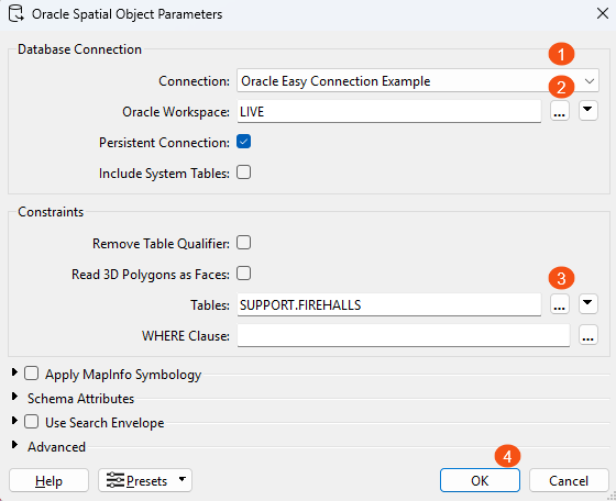

3. Oracle Spatial Object Parameters
1. With the database connection created, now a table needs to be selected. From the Select Dataset to View dialog, click Parameters.
2. Select an Oracle Workspace for use. If the name of the Oracle Workspace parameter is omitted or left blank, the default LIVE workspace will be used.
3. Table List: Clicking from the ellipsis from the table list will allow you to choose which tables to import. This example is using the FIREHALLS table.
4. Once a table has been selected, click OK twice to finish selecting a dataset to view.

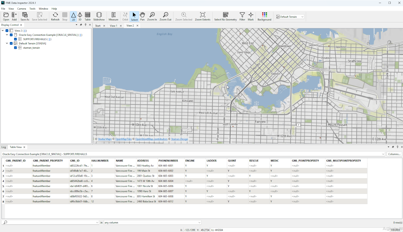

4. Result
The Firehalls table, which includes both geometry and attributes, is displayed in the FME Data Inspector.
