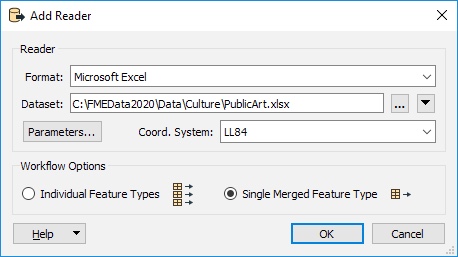

In a blank workspace, add a Microsoft Excel reader to the canvas. Browse to the PublicArt.xlsx file and set the coordinates. Set the system to LL84 and the Workflow Options to Single Merged Feature Types.
As of FME 2025.2, the Coordinate System parameter is now configured within the Parameters dialog of each reader/writer format. For more information, including details about the change and affected transformers, please see Coordinate System Parameter Location Change.

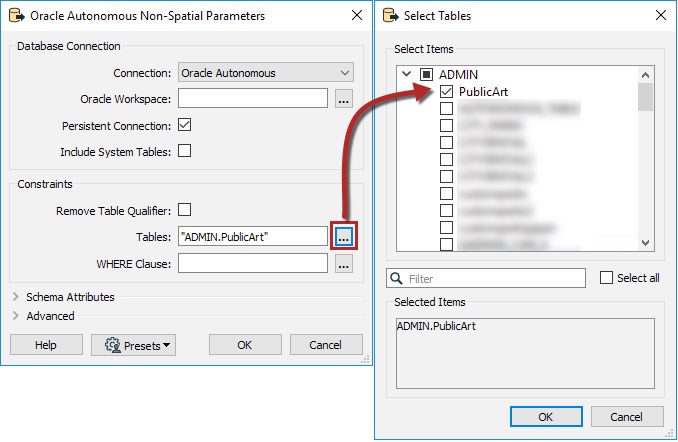

In a blank workspace, add an Oracle Autonomous Non-Spatial Reader to the canvas. Select your Oracle Connection that you have previously created. If you don't have a connection already created, see the article Connecting to Oracle Autonomous Databases.
In the parameters, click the ellipsis next to Table Qualifier and select the table you want to read. For this example, we are reading in ADMIN.PublicArt.
Click OK three times to add the reader to the canvas.
