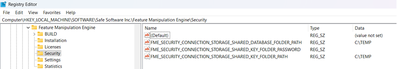

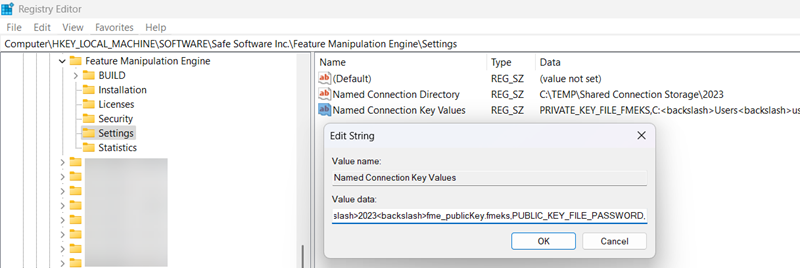

Double-check the correct values have been set in Windows Registry. Open the Registry Editor by opening the Windows start menu and typing “Registry Editor”. This step require administrator privileges.
For 2024 and newer, go to Computer\HKEY_LOCAL_MACHINE\SOFTWARE\Safe Software Inc.\Feature Manipulation Engine\Security and view the registry key values.Windows Registry Editor showing the registry keys at Computer\HKEY_LOCAL_MACHINE\SOFTWARE\Safe Software Inc.\Feature Manipulation Engine\Security
For FME 2023 and older, go to Computer\HKEY_LOCAL_MACHINE\SOFTWARE\Safe Software Inc.\Feature Manipulation Engine\Settings and view the registry key values. Any backslash (\) and space ( ) characters in the private and public encryption key file paths must be replaced with <backslash> and <space> respectively.
