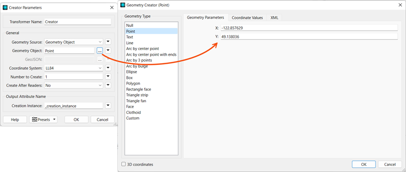

The OpenWeatherMapForecaster takes point geometry as input to return the weather forecast. Add latitude and longitude coordinates for a point of interest into the Creator as a Point Geometry Object. The longitude coordinate is the X value and the latitude coordinate is the Y value.
The Safe Software HQ coordinates in decimal degrees are 49.138036, -122.857629. You can also find your own coordinates using Google Maps.

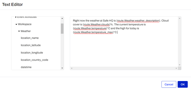

Add an Email Subject, such as ‘Safe HQ Weather Update’. Then open the Text Editor for the Email Body.
In the Text Editor, use the weather forecast attributes passed from the workspace under Workspace > Weather to customize a notification message to be emailed.
