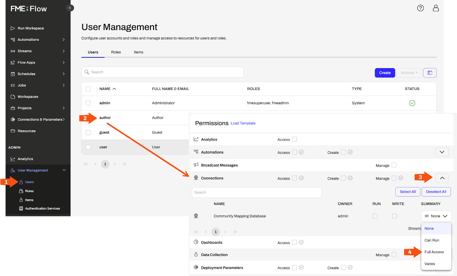

Request Access From an Administrator
Ask a user with administrator privileges to grant access to the connection:
  1. Go to Admin > User Management > Users.
  2. Find the user account and click it to edit permissions.
  3. Under Permissions, locate Connections and click the drop-down arrow next to Show Connections.
  4. Find the connection used in the workspace. Click the drop-down under Summary and select Full Access.
  5. Click Save.
An administrator grants a user access to a connection.

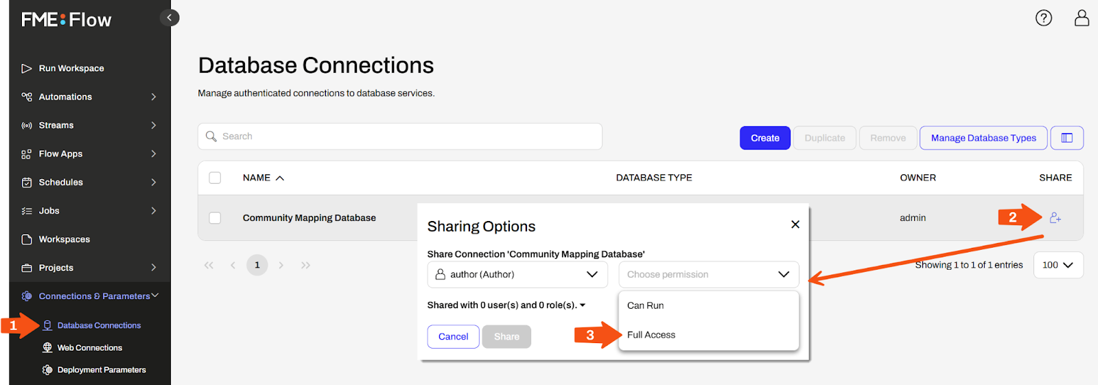

Request Sharing From the Workspace Owner
If another user shared the workspace with you, ask them to also share the connection:
  1. Go to the Web Connections or Database Connections page under Connections & Parameters.
  2. Click the Share with Others button.
  3. Find the username, select Full Access, then click Share.
Ask another user to share their connection with you.

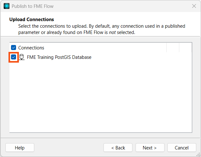

Publish the Connection
If you own the workspace, you may have opted out of publishing the connection.
  1. Open FME Workbench and click Publish to FME Flow.
  2. On the Upload Connections page of the publishing wizard, enable the checkbox for the connections used in the workspace.
Upload connections when publishing a workspace to FME Flow.

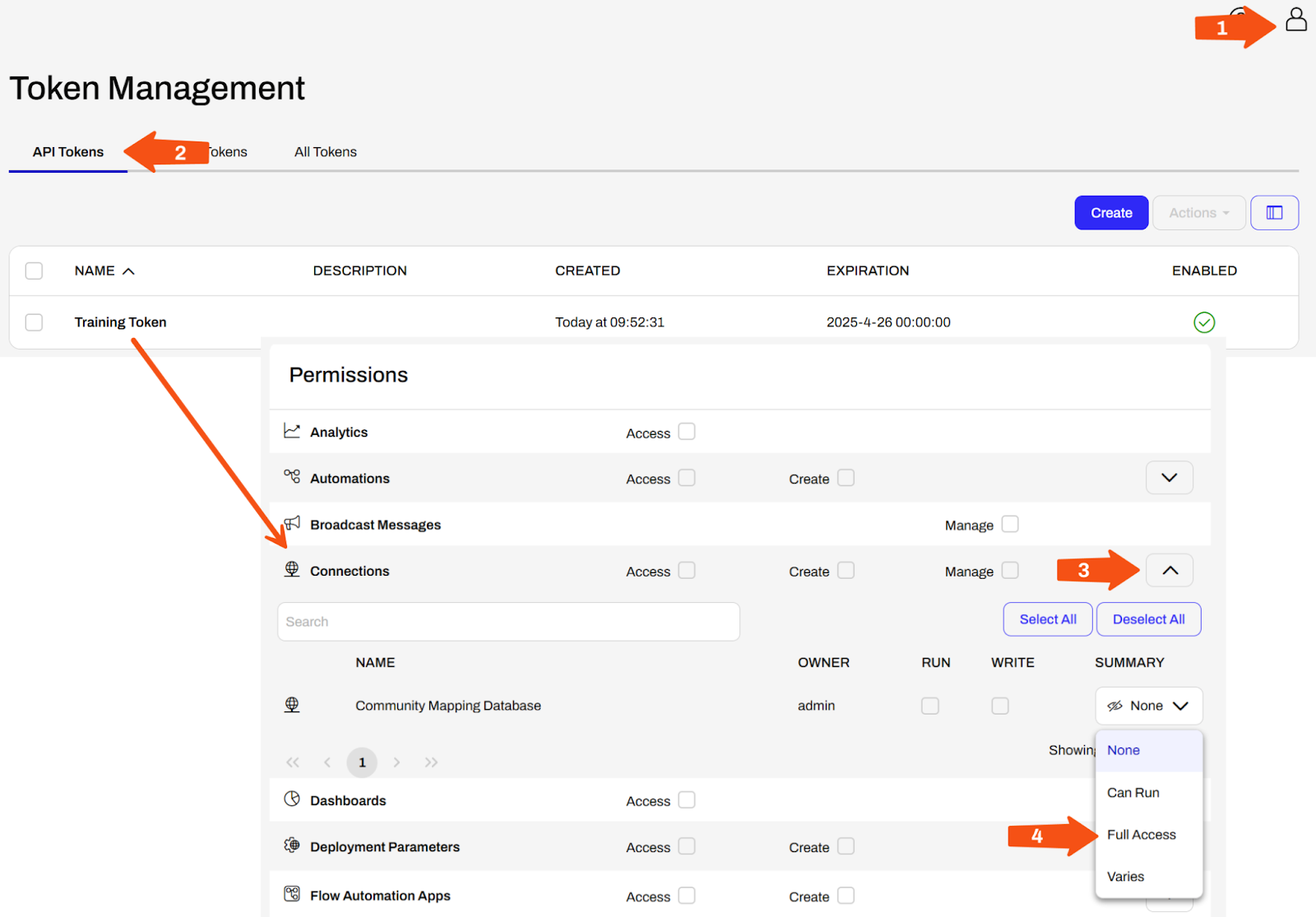

If You Own the Token
  1. Click the User Settings icon in the top-right corner of FME Flow, then select Manage Tokens.
  2. Under API Tokens, find the token used for the workspace and click it to edit.
  5. Click Save.
Assign access permissions to an API token.
