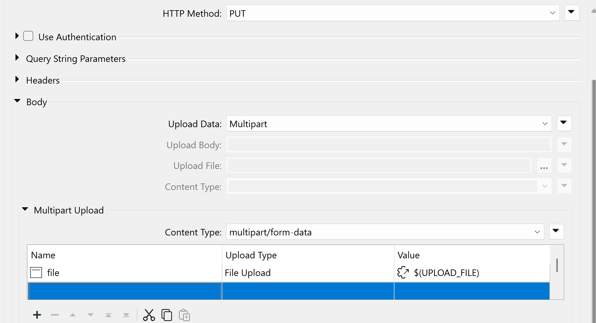

Now that the workspace has been configured to obtain the FME Flow App IDs, another HTTPCaller can be added to the canvas. Configure the second HTTPCaller to use the PUT Method and set the Upload Data parameter to Multipart/Form-Data. Create a single entry in the Multipart Upload called "file" and set the type to File Upload. Lastly, create a new User Parameter in the "Value" column (by default this will be named UPLOAD_FILE).

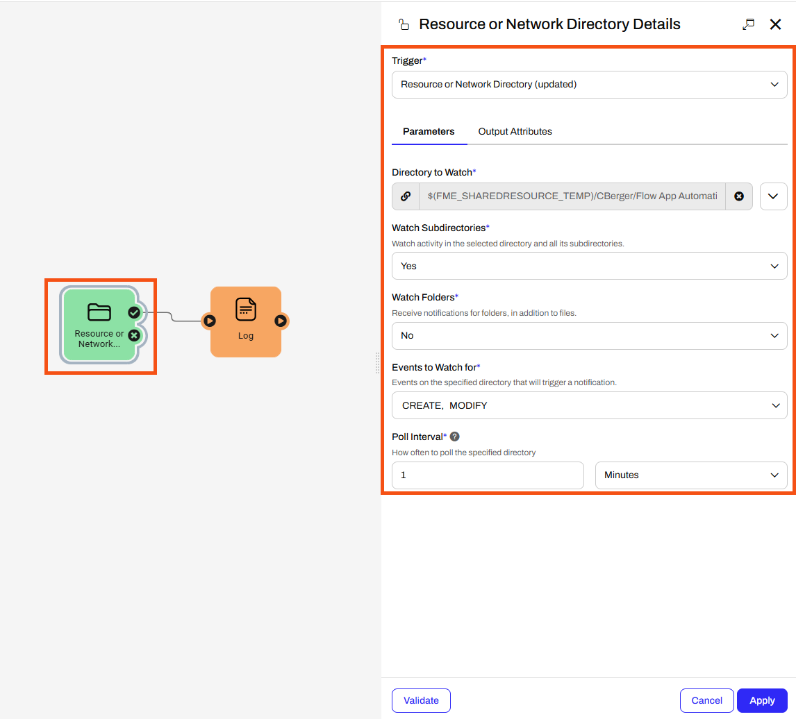

5. Watch Directory
Once the Resource Folders have been configured, you can build an FME Flow Automation that monitors modifications to the Flow App Customization Folder (including its subfolders).
