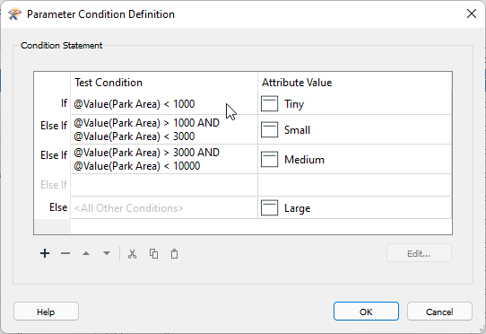

Conditional values take the form of If, Else If, and Else statements. The If statement is read first; if a feature passes the statement, it will follow the action determined by that condition. If the feature fails the If condition, it will be tested against the Else If statement.
A feature that passes an Else If statement will take on that action. If the feature fails, it will move onto the next Else If statement or the final statement: Else.
A final Else statement determines the action for all features that have failed the previous tests or conditions. This includes missing, null, or empty values within the tested attribute.

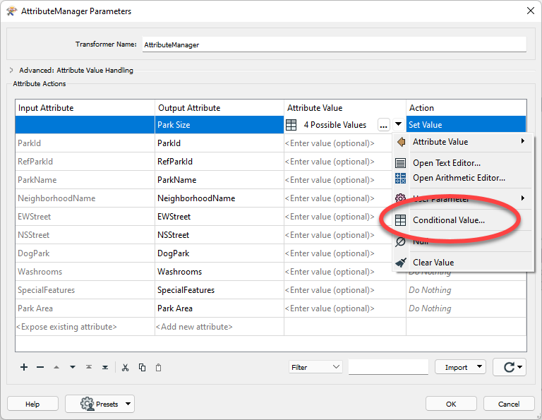

A variety of transformers have the capability to set conditional actions. These are located in the drop-down menu for setting a parameter value.
Selecting "Conditional Value..." in the AttributeManager transformer will expose an "If, Else If, Else" dialog (shown below). Double-clicking a row displays a Tester-style dialog, allowing users to create conditions to test the data against.

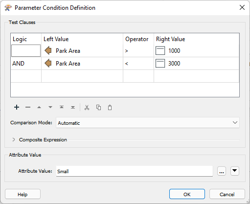

The Parameter Condition Definition dialog allows a user to create a test condition and an output for a feature that passes that condition.

The workflow in this bookmark uses conditional values to determine the size of a park: Tiny, Small, Medium, or Large. The park areas are calculated from the park areas read from a Park MITAB file. Each feature has a park area calculated. The size constraints for the first workflow in square meters are:

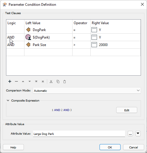

Disable the first bookmark from step 1 and enable the second bookmark. Set the workspace to 'Run with Prompt'. Run the workspace and select 'yes' or 'no' for dog parks; the default value is 'yes'.
This workflow utilizes a User Parameter with conditional values to determine the size of a park, using the user's input to select either dog or non-dog parks. An area of 20,000 square meters is used to divide between the Small and Large parks. Parks that do not pass the Dog Park yes-or-no test are given the attribute value of "Unwanted Park".
A composite test was used for each output value to determine if a park meets the requirements. Composite tests combine three or more tests within a single condition and consist of AND/OR statements to combine the results. In the above dialog, the test condition evaluates if the park is a dog park (Y/N), if the user wants a dog park (Y/N), and if the park is of a certain size (smaller or larger than 20,000).
To create a composite test such as the one above, enter all test clauses and add the logic as you go, including parentheses to control the logic order. Select from the drop-down menu, or type directly into the Logic column fields. Alternatively, after the tests have been written, open the Composite Expression disclosure and edit the Composite Test.
