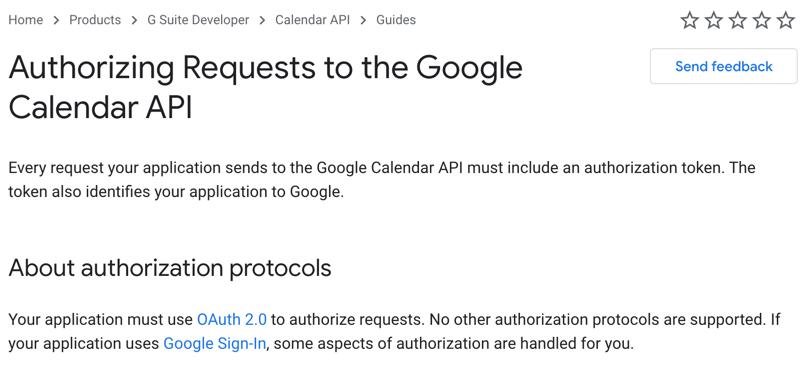

HTTPCaller does not require authentication to make a request. But unless the server (API) is open and requires no authentication, the call is unlikely to be successful. Authentication is required by many servers to access their resources.
There are many different types of HTTP authentication schemes, so it’s best to always start by consulting the documentation. Since we’re using Google Calendar’s API, the documentation specifies the use of OAuth 2.0 to authorize requests.

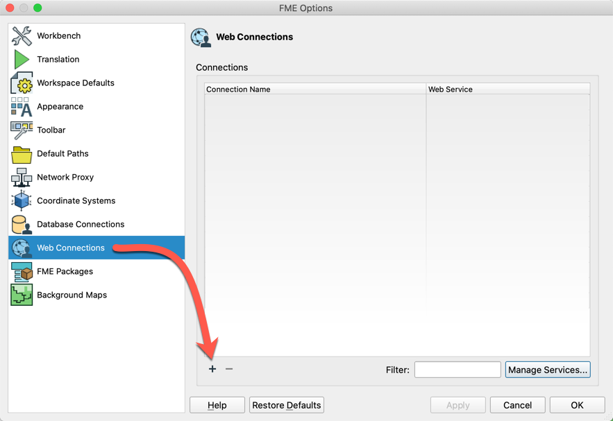

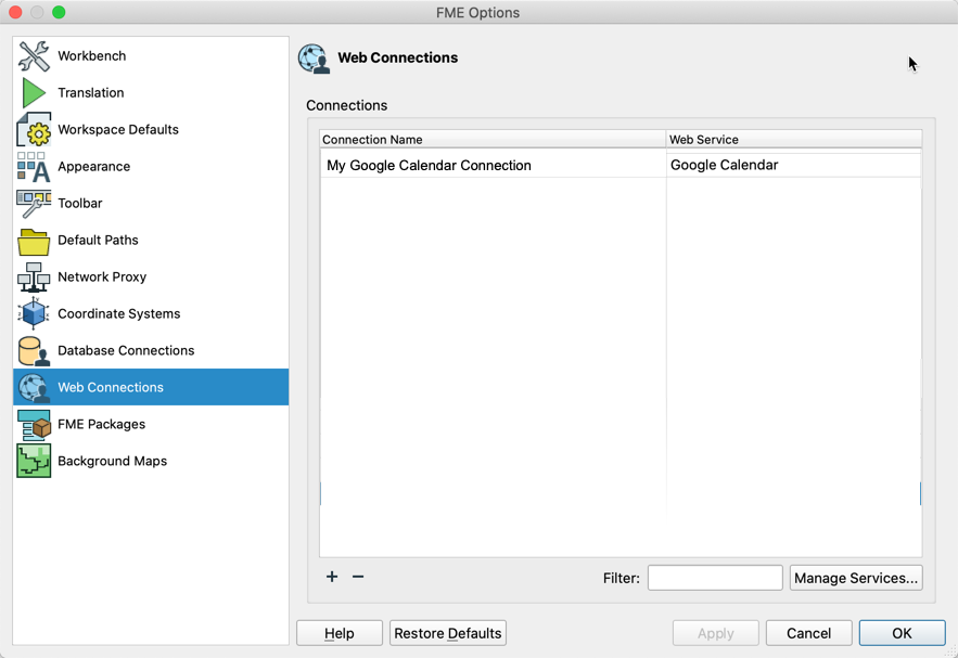

Open Web Connections from the FME Options menu and select the “+” button below the listed Connections.
Mac: FME Workbench > Preferences... > Web Connections
Windows: Tools > FME Options...

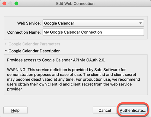

Select Google Calendar as the Web Service and give the connection a name.
Select Authenticate… and in the pop-up window, log in with your Google account.
The Google Calendar Web Connection will now appear in the Connections list. Select OK to finish.

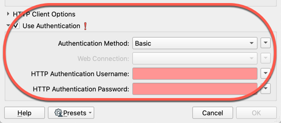

Back on the canvas, double-click the HTTPCaller or select the cog wheel to review its parameters. Near the bottom, there is an option to Use Authentication. Enable Use Authentication, then expand the option using the dropdown arrow to the left of the parameter.
Select Web Connection as the Authentication Method and choose the Google Calendar Web Connection.

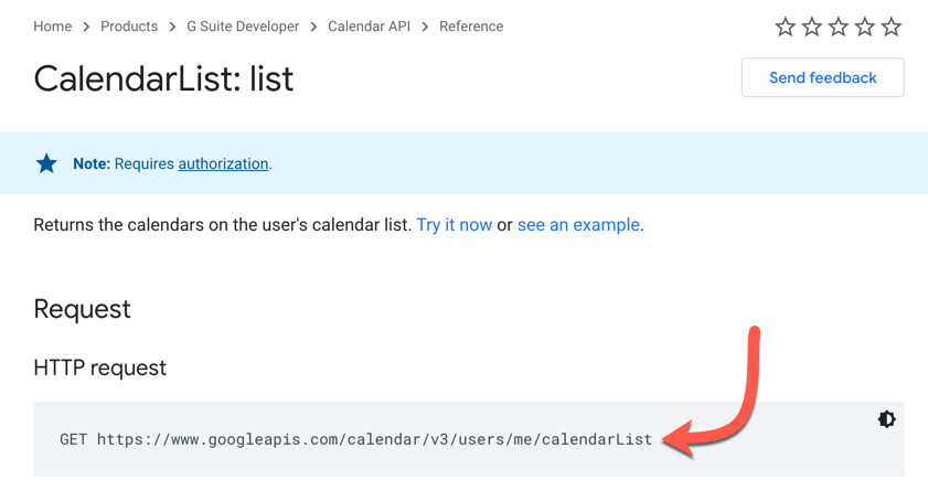

You’re likely to encounter a GET request when using just about any API. GET functions to retrieve a representation of a resource from a server. In its simplest form, a GET request consists of just a Uniform Resource Location (URL) and method. These are also the only required parameters to use the HTTPCaller.
To demonstrate our first call, we will use a GET request to fetch a list of calendars associated with our Google account. CalendarList: list provides the URL and method required to make the call. Copy the Request URL to your clipboard, we will use it in the HTTPCaller in the next step.

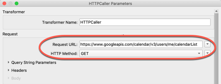

Back in your workspace, open the HTTPCaller to build the request. Enter the copied URL in the Request URL parameter. Select GET as the HTTP Method. Remember to select Use Authentication and choose your Google Calendar connection; we will use it for every call. While the rest of the parameters can be left at their default, note that the response body is saved to an Attribute named _response_body.

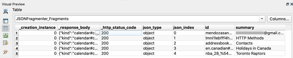

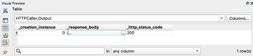

With Feature Caching enabled, run the workspace and open up the Visual Preview table by clicking on the green magnifying glass on the HTTPCaller. The API’s response is stored in the _response_body attribute, and the status code is stored in the _http_status_code attribute. The 200 status code indicates that the HTTP Request was successfully received by the server.
Double-click to open the _response_body and view the API response. The server has returned a JSON body with a list of calendar objects and their attributes, including the “HTTP Methods” calendar we observed in the GUI. Copy the “id” value for a calendar you’d like to use for the next request.

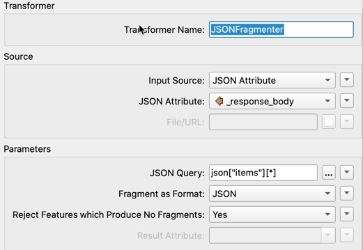

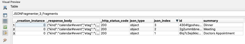

To easily interpret response messages in a workspace, attach a JSONFragmentor to your HTTPCaller. Instead of navigating a large response body, isolate fragments with JSON queries. Here I am using the “items” key to divide the response body into feature types containing JSON objects. Keep in mind that the JSON Query may need to be modified for each call, depending on the structure of the JSON response body.
Now, you can view your response as individual feature types.

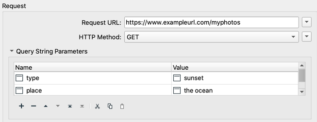

Path parameters follow the URL domain name to refine the location of the resource. Query parameters are used to filter or sort the resource. The key is listed, followed by an equals sign and its value. They are separated from the rest of the URL by a question mark. Multiple queries, for example, when submitting a web form, are separated by an ampersand (&) sign. URL encoding is used to include special characters (such as a space). For example, spaces are replaced by %20.
Here is an example of a GET request format with path and query parameters:
With the HTTPCaller, the process of building a URL is simplified. The URL, query parameters, and special formatting are each handled by the transformer’s graphical interface.

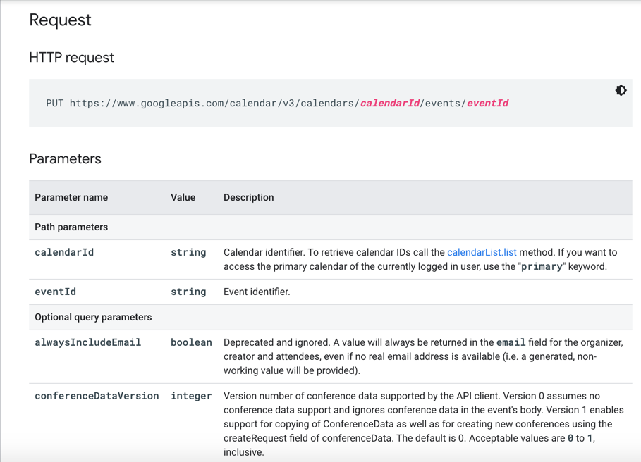

1. Consult the Documentation.
Navigate to the Events: list reference page. In addition to the method and URL, it includes descriptions and data types of both path and query parameters. The path parameter (calendarId) is shown as pink italics in the URL; it tells the server we want to perform an action on the resource (calendar, in this case) specified here.

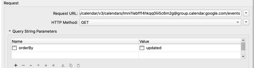

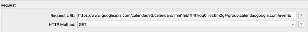

To make a new GET request in FME Workbench, modify your last HTTPCaller or add another Creator and HTTPCaller to the same workspace. Ensure that any new HTTPCallers are using authentication.
Copy the path to the Request URL field on the HTTPCaller. Replace the calendarId path parameter with the “id” we copied from the previous request.

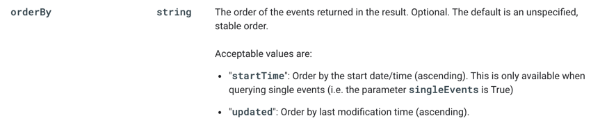

With only these two parameters, it is possible to make the call. The HTTP response would be a list of all the events associated with that calendar. But let's say we want to sort the returned event objects, to do this we can use the orderBy query parameter. The parameter name is "orderBy", its data type is a string, and its value can be “startTime” or “updated”. We’ll sort the events by the date of their last update.
A traditional request URL with the path and query parameters would look something like this:
GET https://www.googleapis.com/calendar/v3/calendars/lmni1lebfff4hkqq0lii5c6m2g@group.calendar.google.com/events?orderBy=updated
The HTTPCaller lets you easily add and organize request parameters using the transformer interface. Enter path parameters in the Request URL and use the Query String Parameters section for query parameters. Directly enter parameters or use the Text Editor to build them dynamically with attribute values. Here is the same GET request built in the HTTPCaller:

With the URL, method, and parameters fulfilled, run the workspace to the HTTPCaller (or JSONFragmentor, if you choose) and view the response. Returned is a list of that calendar’s events and their attributes, sorted by the last update timestamp.
Similarly, viewed with the JSONFragmentor.
You'll notice the response returns the same basic information that is visible when accessing your calendar from a web browser. In addition, there is additional information (like an Id, creation data, etc.) that will help you build your own workflows with the API. Keep reading the next tutorial to learn how to use POST, PUT, PATCH, and DELETE methods with the Google Calendar API and HTTPCaller.
