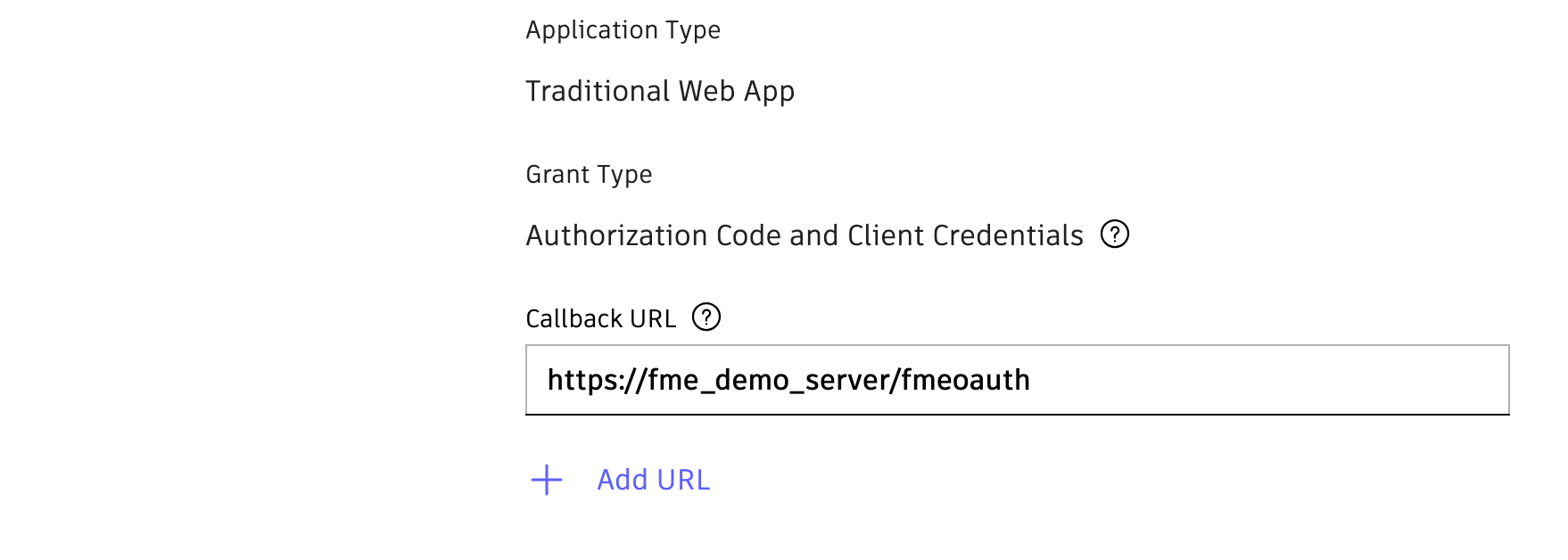

Redirect URI/Callback URL
When configuring the Forge App, you will need to also configure the callback URL, which will be used for the Redirect URI.
In FME, you will need to set the Redirect URI so that it is consistent between FME and the APS App.

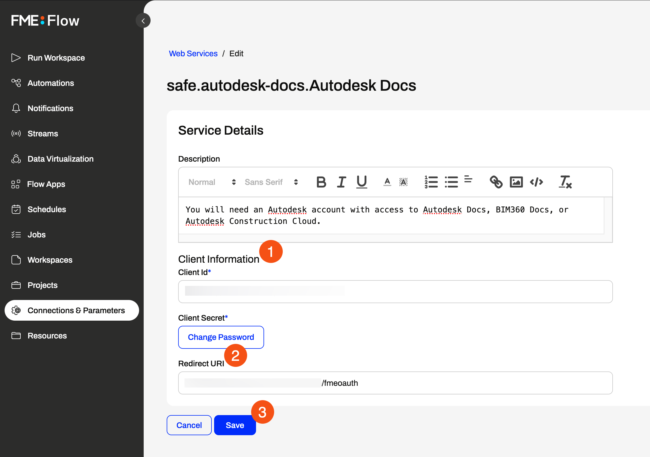

  1. Go back to the app you created in Autodesk Platform Services or potentially in BIM 360, and update the Redirect URI to <yourFMEFlow>/fmeoauth
  2. In FME, Utilities > FME Options > Web Connections > Manage Services from this step, edit your web service definition to match the Redirect URI in your APS web app.
  3. Publish your workspace along with the web connection to Flow.

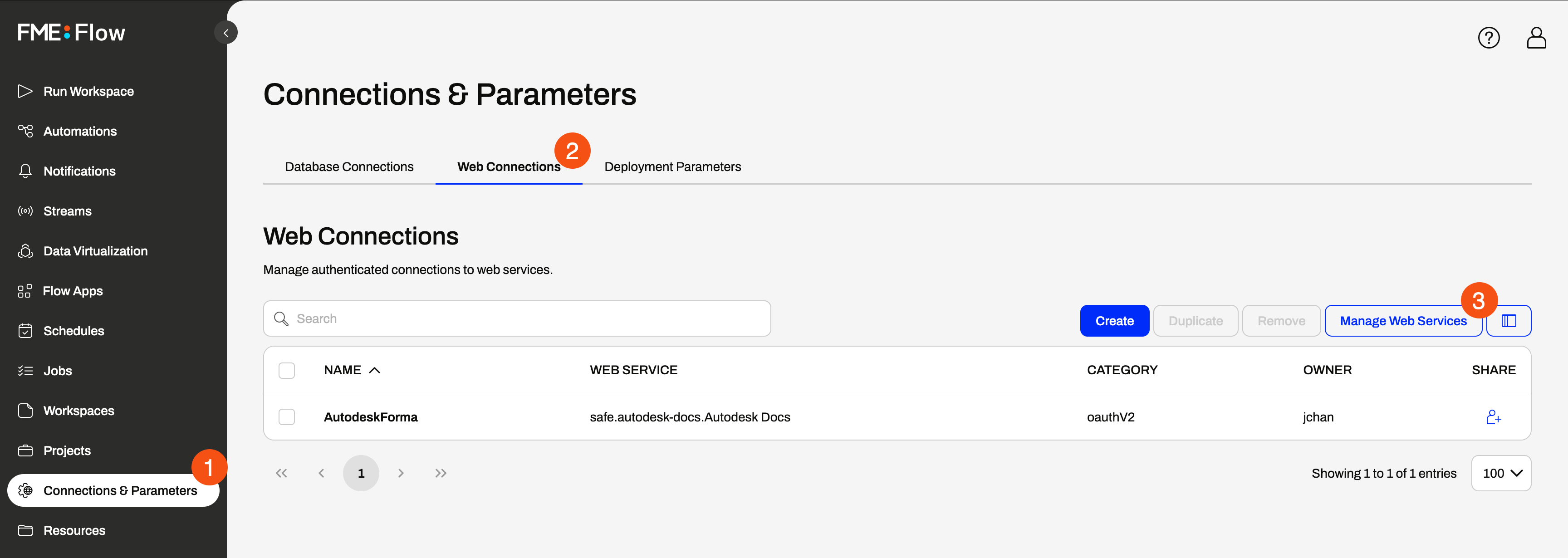

  4. In Flow, go to Connections & Parameters > Web Connections > Manage Web Services and ensure the Client ID is correct, and the Redirect URI points to the same URI value as in your registered app, and Form web service definition: <yourFMEFlow>/fmeoauth
  5. Save and return to the Web Connections page. Select your web connection now and click 'Authorize' to authorize the connection for Flow.
