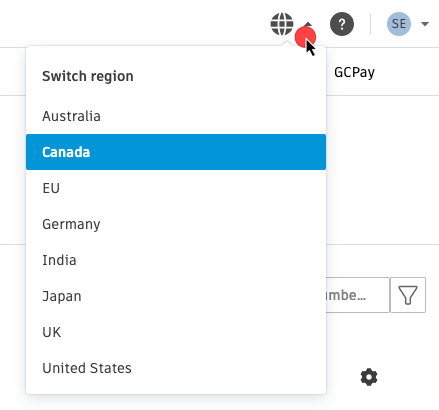

You can switch regions either by choosing the region when you log in, or if you're already logged in, go to the top right corner while on the ACC Home page, and select the globe icon to "Switch region". Check Apps to ensure FME is enabled.

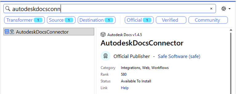

1. Download and Install the AutodeskDocsConnector Package
Download and install the AutodeskDocsConnector package from the FME Hub: https://hub.safe.com/publishers/safe/packages/autodesk-docs. Alternatively, from within FME Workbench start typing "AutodeskDocsConnector" and add it to the canvas to automatically download the package.

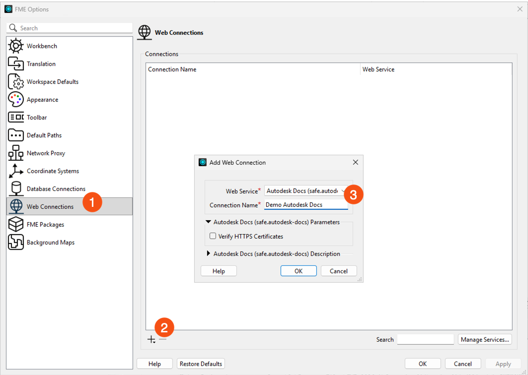

2. Add a New Autodesk Docs Web Connection
Go to Tools > FME Options > Web Connections > Add button (+)
  • Select Web Service: “Autodesk Docs”
  • Specify a “Connection Name”

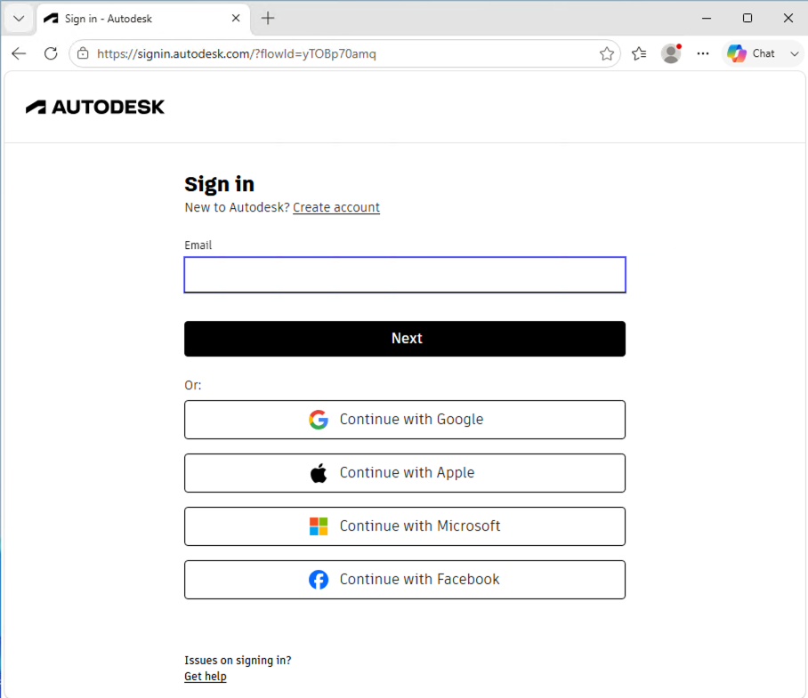

  • Click Authenticate and enter your Autodesk Account login
  • Click “Allow” to accept permissions to view your accessible data
Now you’re all set to use the Autodesk Docs web connection in FME!
