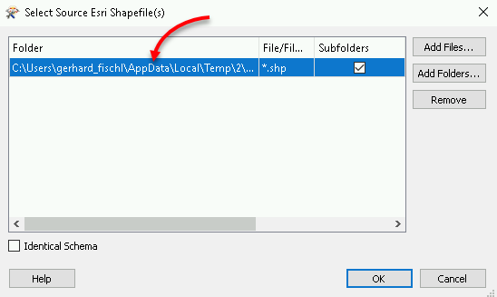

Select the source shapefiles data folder by selecting the dropdown arrow to the right of the Source Esri Shapefile(s) parameter and select the “Select Multiple Folders/Files…” option.
Click on the down arrowhead to the right of the Source Esri Shapefile(s) parameter and select the “Select Multiple Folders/Files…” option.
Note the Subfolders checkmark, which ensures Shapefiles contained within the directory and any subfolders will be read into FME. Double-click on the existing path in the Select Source ESRI Shapefiles dialog that appears.
Ensure the Subfolders checkbox is enabled, which tells the reader to read files in subfolders.
In the Folder Selector dialog, navigate to the directory called “Folder” (...\1\USA\Folder) and select it by clicking the 'Select Folder' button. This directory contains three Shapefiles and a directory called “Subfolder”, which contains three additional Shapefiles. Click 'OK' to exit the Select Source Esri Shapefile(s) dialog.

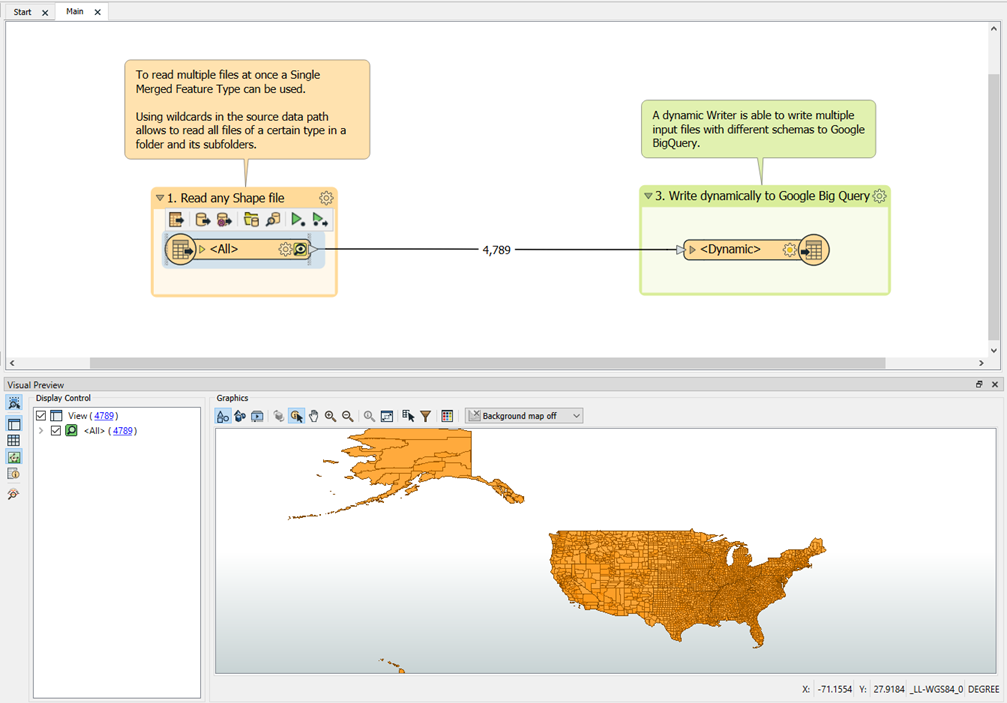

In the Translation Parameter Values dialog, select the BigQuery Web Connection created in the previous exercise and choose your Google Cloud Project and type in the name of an existing Google BigQuery Dataset. Then click the 'Run' button on the dialog. The files will be read in FME, and you can inspect the 6 different Shapefiles in the Visual Preview window.

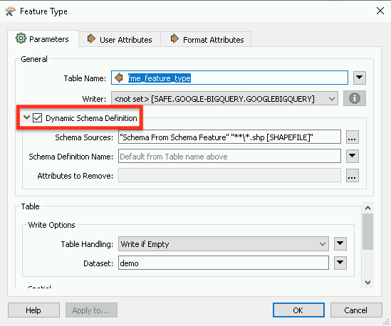

Now inspect the BigQuery Writer settings. Click on the cogwheel on the BigQuery feature type to open up the Writer feature type parameters. Notice that the “Dynamic Schema Definition” is selected, which means this Feature Type will create multiple BigQuery Tables in the specified Dataset. Each one will have its own schema based on the schema of its source file.
Run the translation by clicking on the big green button in the menu bar. If the Translation Parameter Values dialog appears, select the 'Run' button again.

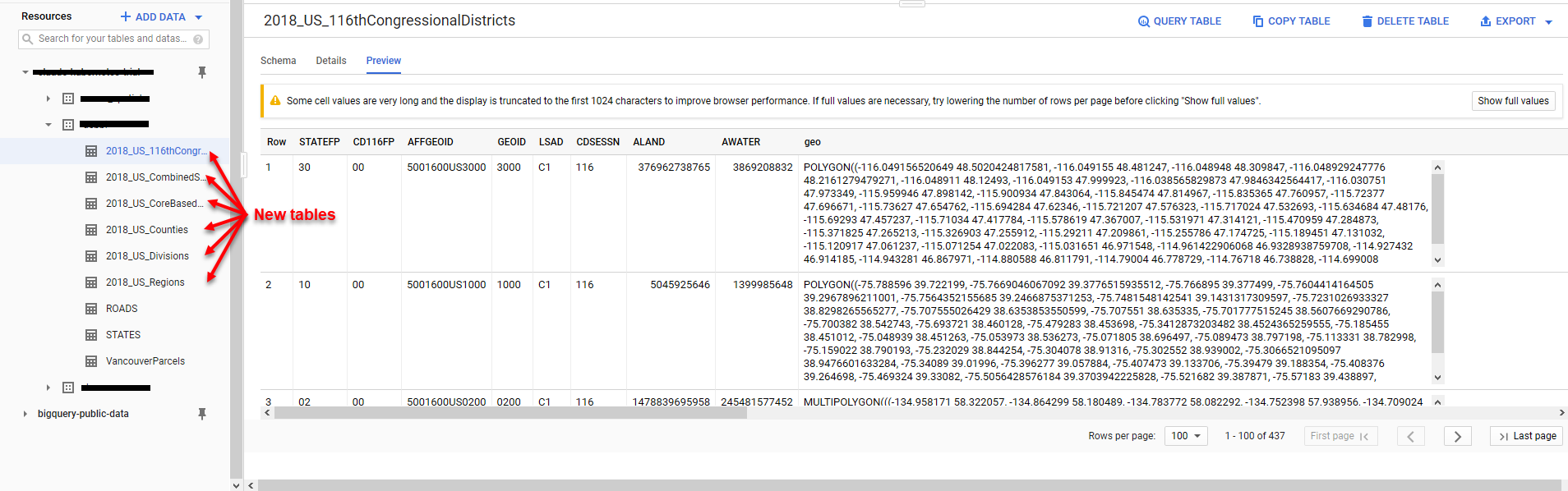

In the final step of this exercise, we will examine the tables created in the Google BigQuery user interface and the BigQuery GeoViz tool using the Export to GeoViz functionality. Notice the six new tables created in the dataset specified in the workspace.
If you do not see the new tables in the BigQuery user interface, ensure the workspace has finished and refresh the BigQuery user interface.

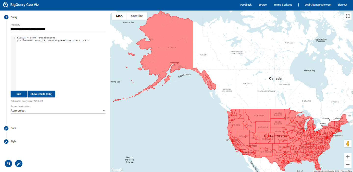

Visualize spatial data in BigQuery using the GeoViz web tool via the Explore with GeoViz functionality under the Export dropdown.
You have now successfully uploaded multiple files dynamically to BigQuery with FME!
