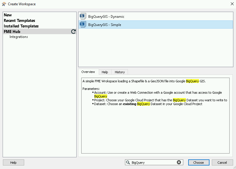

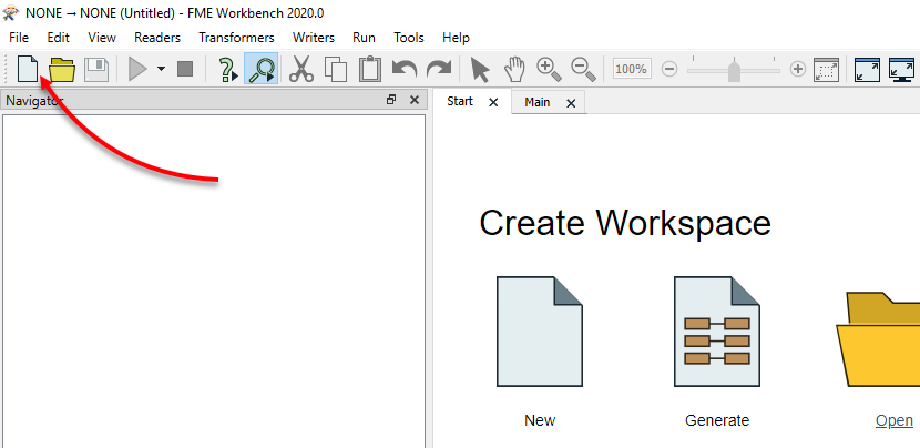

To get started, launch FME Workbench and select the Create Workspace button located at the top left (or enter the shortcut Ctrl-N on Windows).
In the Create Workspace dialog, click on FME Hub and search for “BigQuery” in the Filter field, then select BigQueryGIS - Simple. The workspace should automatically download and open in Workbench.
Search for “BigQuery” using the Filter field in the Create Workspace dialog and select BigQueryGIS - Simple to download the workspace.

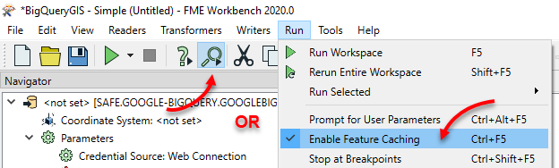

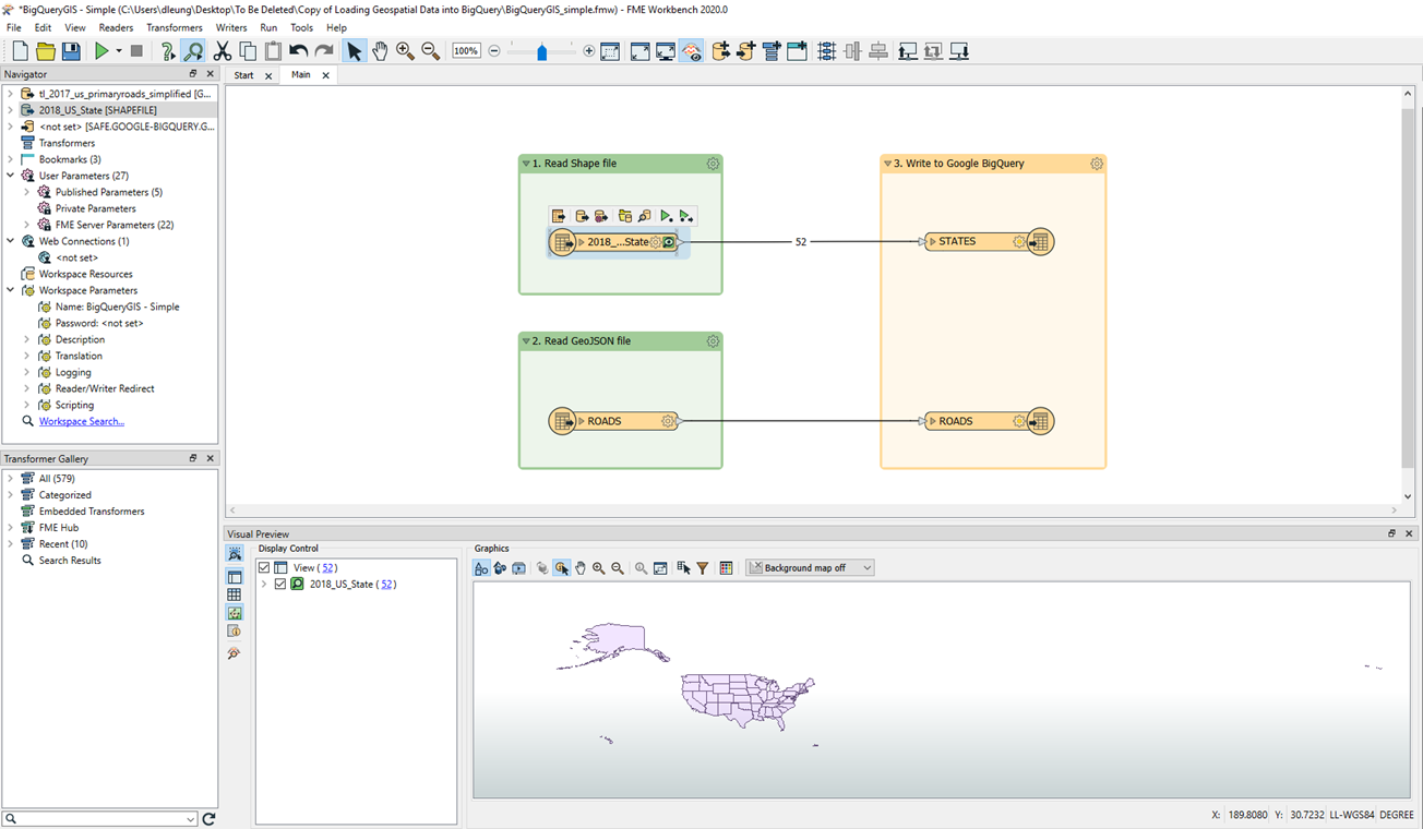

2. Enable Data Caching
Ensure Enable Data Caching (formerly feature caching) is enabled using the green magnifying glass icon. Alternatively, use the menu bar (Run > Enable Feature Caching).

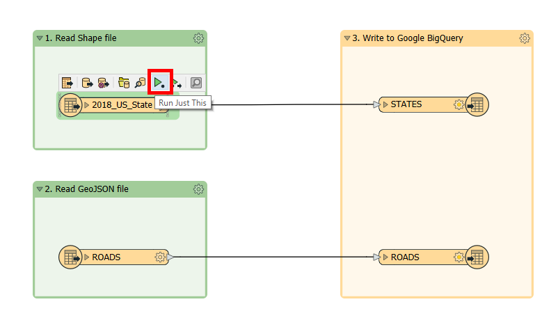

Inspect the source data by selecting the Shapefile Feature Type. A button bar will appear above the feature type. Click on the green “Run Just This” button to read in the data. The Translation Parameter Values dialog should appear.

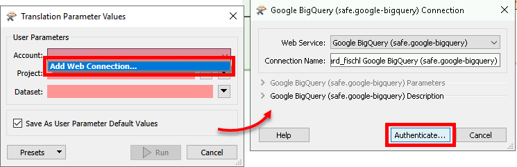

3. Add Web Connection for BigQuery

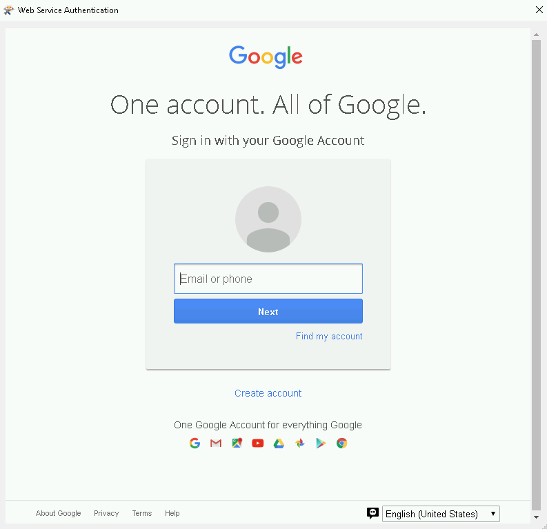

In the Translation Parameter Values dialog, select the Account parameter, and from the dropdown, click “Add Web Connection...”. In the next dialog, select Authenticate. Follow the Google sign-in procedure to enter your credentials and finish creating the Web Connection for Google BigQuery.
Select Add Web Connection to create a Web Connection, then select Authenticate to enter your credentials.
Enter your Google credentials and follow the sign-in procedure.
After you enter your credentials and complete the sign-in process, your Google BigQuery web connection will be added to Workbench, and the Account parameter will no longer appear red (invalid value).

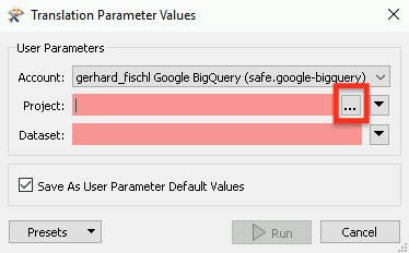

Once the Web Connection is created, click on the ellipsis next to the Project parameter to browse Google Cloud Projects available to your Google Account. If you don't see any projects listed in the dialog, ensure you've created a Google Cloud Project or been granted access to one.
Browse Google Cloud Projects available to your Google account using the Project parameter ellipsis.
After selecting the Project, you can now type in the name of the Google BigQuery dataset that the files should be written to. The Google BigQuery Dataset needs to already exist in your Google Cloud Project before FME can write to it. Please reach out if this is inconvenient and you would like FME to create new BigQuery datasets when writing.

5. Inspect Source Data
Click the Run button in the Translation Parameter Values dialog. Once the data is read and cached, click the green magnifying glass to inspect the data. You can also view the data for the GeoJSON feature type.

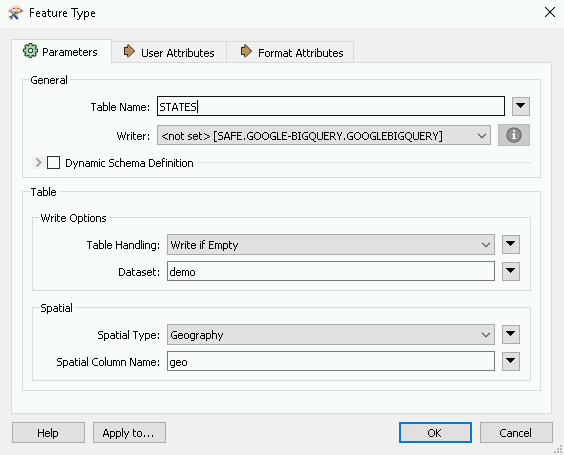

6. Inspect BigQuery Writer Settings
Inspect the BigQuery Writer settings. Click on the cogwheel on one of the BigQuery feature types to open the Writer feature type parameters. These parameters control the writing behavior and the geography column settings.

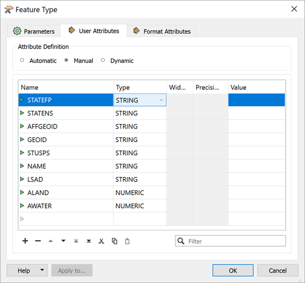

Select the User Attributes tab and notice that the schema settings allow you to map certain attributes to data types supported in Google BigQuery using the Type dropdown field when Attribute Definition is set to Manual.

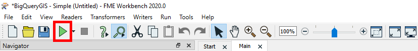

Now we are ready to run the translation and load the 2 files into the previously selected Google BigQuery Dataset. Click the big green button in the menu bar. If the Translation Parameter Values dialog appears again, make sure no parameters are invalid (red), then select Run.
Run the translation and write the 2 files into the selected BigQuery Dataset.

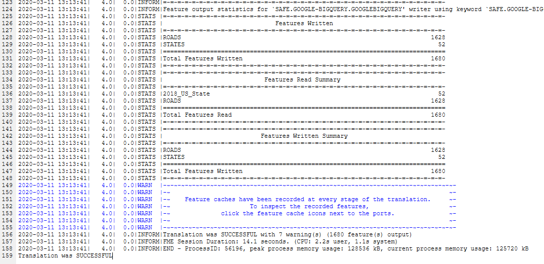

Check Workbench to confirm the translation finished and the features were written using the Translation Log pane. You should see the number of features written in the log. For this exercise, 1628 ROADS features and 52 STATES features were written.

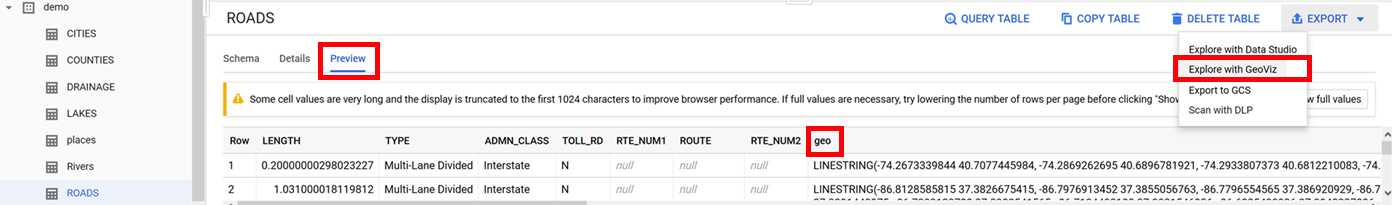

8. Inspect Output in BigQuery
In the final step of this exercise, we will review the tables created in the Google BigQuery user interface. Navigate to the tables written and select Preview. Notice the Well-Known Text geometry contained in the geo column.
If you had the Google BigQuery user interface open before running the workspace in FME, you may need to refresh the page to view the newly created tables.

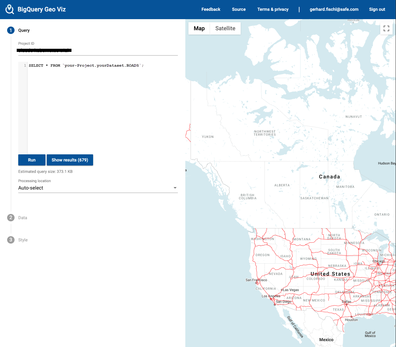

Users can visualize spatial data in BigQuery using the GeoViz web tool, accessible via the Explore with GeoViz functionality in the Export dropdown.
