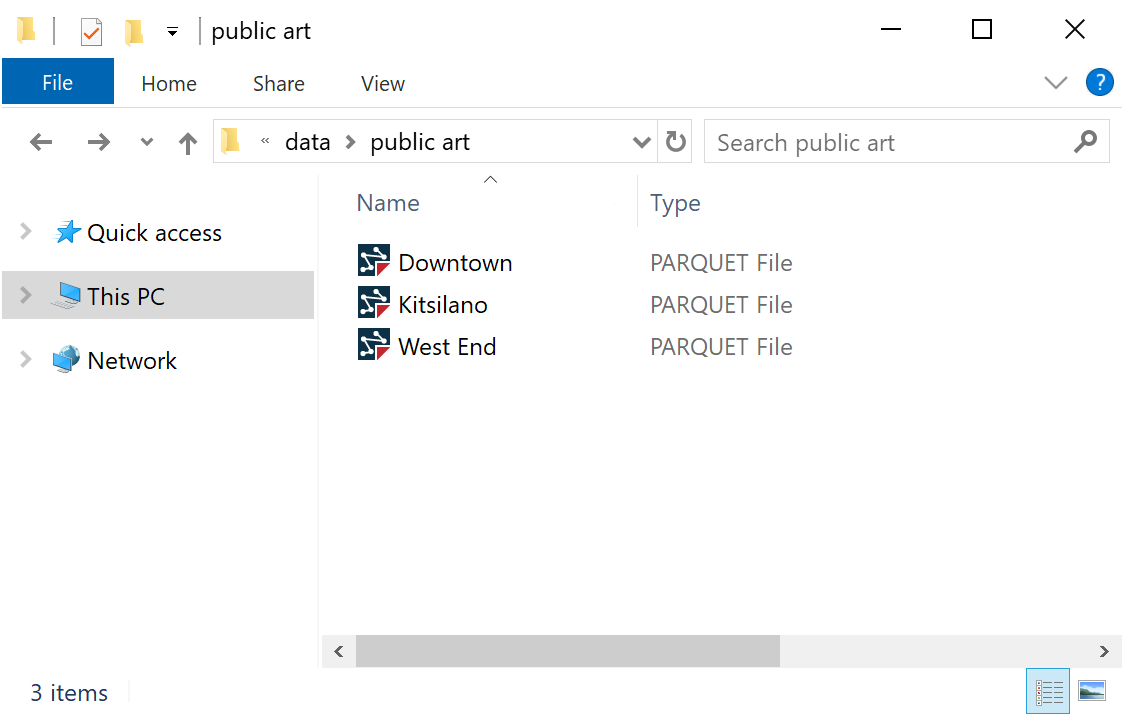

The data we are working with is a set of partitioned Parquet files representing public art in Vancouver:

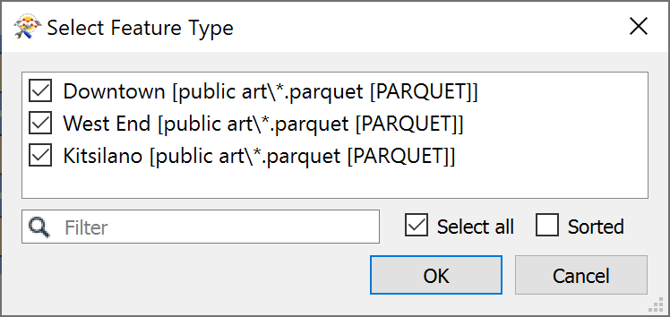

In the Select Feature Types dialog that pops up, ensure all 3 files are selected and click OK.
A Parquet reader will be added to the workflow, and all 3 feature types will be added to the canvas.
