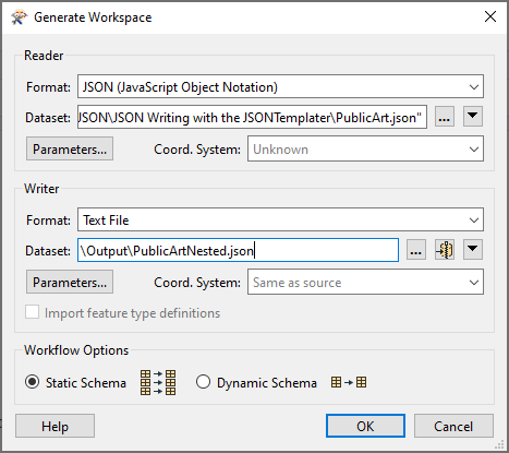

1. Start FME Workbench and Generate Workspace
Start FME Workbench and click Generate Workspace. Fill in the Generate Workspace dialog as follows:
  • Reader
  • Writer
    • Format: Text File
    • Dataset: ...\Output\PublicArtNested.json (wherever you wish)
      • You may have to switch the file type to All Files (*) for the .json extension to work.

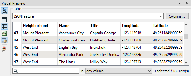

Run the workspace and inspect the source dataset
You can see that each of the 185 features is an art installation in Vancouver. Although the data includes longitude and latitude values, we will not be creating geometry in this example. The goal is to transform this JSON from a large array with Neighborhood as an attribute to a nested structure of key-value pairs where each art installation is nested underneath its respective neighborhood, like so:

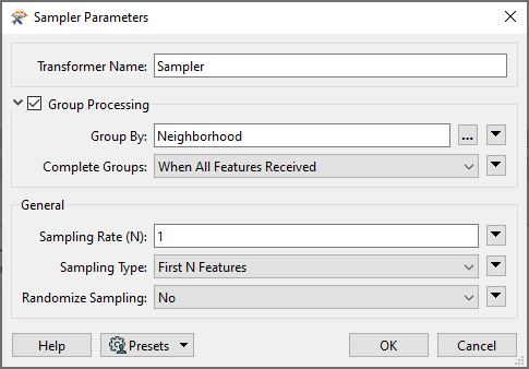

To build our nested JSON, we will use a JSONTemplater with two sub-templates: one to create a separate array for each neighborhood, and another to contain all the art installations in that neighborhood. To get a separate array for each neighborhood, we need to provide the JSONTemplater with six features, one from each neighborhood. To do this, we’ll use a Sampler transformer. Add a Sampler and connect it to the reader feature type, then set the following parameters:
  • Group Processing: Enable
    • Group By: Neighborhood
  • Sampling Rate (N):1
  • Sampling Type: First N Features
With Feature Caching enabled, click Run To This on your Sampler. You should have six features coming out of the Sampler:Sampled port, one for each neighborhood. These will be provided to one of the JSONTemplater sub-templates.

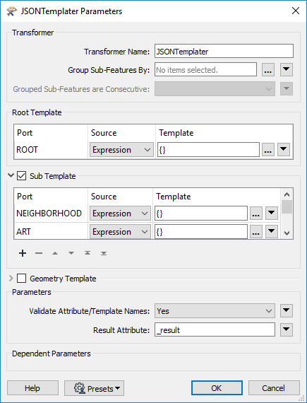

Open the JSONTemplater. First, let’s add our sub-templates. Sub-templates are used to turn FME features into children of the ROOT template, or even other sub-templates.
To add a sub-template, check the Sub Template box and then click the + button in the Sub Template table. In the Port field, rename this sub-template NEIGHBORHOOD. Add another sub-template named ART.
You’ll notice each Template field is red, meaning we must supply a value before we can click OK. Because we want to connect our new sub-template ports to features, start by just typing empty curly braces {} into each Template field. Your dialog should look like this:

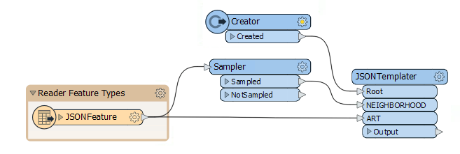

You’ll see that each template (ROOT, NEIGHBORHOOD, and ART) creates an input port on the JSONTemplater. We are supplying six features to ROOT, but currently none to the other ports. Connect the Sampled port on the Sampler to the NEIGHBORHOOD input port. Then, since we want ART to contain all of the art installations, connect the reader feature type to the ART input port. This will provide all 185 features for use in our sub-template.
Now we need to connect features to the Root template. Because we want a single JSON document output from the JSONTemplater, the easiest approach is to use a Creator, which provides a single feature to the Root template. Add a Creator to the canvas and connect it to the JSONTemplater's Root input port.

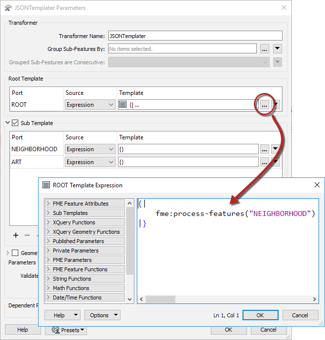

First, let’s set up the ROOT template. This template sets the top level of the JSON hierarchy and, in this case, will execute only once because it receives one feature. Click on the ellipse [...] button in the ROOT Template field to open the ROOT Template Expression dialog. This dialog is similar to the Text Editor and lets us build our Template Expression. Copy and paste the following template, or build it yourself by typing and double-clicking the Sub Templates > SUB on the left to add functions (note the pipes inside the curly braces, {| |} ):
    fme:process-features("NEIGHBORHOOD")
The fme:process-features(“NEIGHBORHOOD”) function will insert the results of our sub-template NEIGHBORHOOD as items in the array.
For this example, we are using one of the slightly more advanced JSON templating expressions, the pipe |. As specified in the JSONiq documentation, the pipe is a dynamic object construction expression. What it means, in this case, is to create each sub-template result as a separate object. If we didn’t add these pipes, the resulting JSON document would not have the required commas between each neighborhood entry.

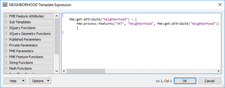

7. Build the NEIGHBORHOOD template
This sub-template will create a JSON document for each feature, with the neighborhood name substituted for fme:get-attribute("Neighborhood"). The fme:process-features(“ART”) function will insert the results of our sub-template ART as items in the array. Click on the ellipses [...] button next to the Template field for NEIGHBORHOOD. Copy and paste the following template:
    fme:get-attribute("Neighborhood") : [
        fme:process-features("ART", "Neighborhood", fme:get-attribute("Neighborhood"))

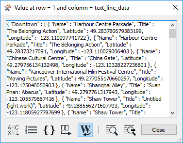

Run the workspace and inspect the JSONTemplater's Output port. You should see all the neighborhoods combined into a single JSON document, matching our goal template in the _result attribute. Click the ellipse [...] button next to the cell in the Table View of Visual Preview to view the full value. However, this JSON is quite hard to read as it is not pretty-printed:
Let’s fix that issue.
10. Add a JSONFormatter
Add a JSONFormatter after your JSONTemplater. This transformer will format our JSON document for pretty printing. Open its parameters and set the JSON Document to _result. Then, set the Output Attribute to text_line_data. This attribute name is reserved for use when writing using the Text File writer. Your dialog should look like this:
11. Run Workspace and Inspect Final Results
Connect the JSONFormatter to the Text File writer feature type. Run your workspace and inspect the final results, either in Visual Preview or your text editor of choice. You should see JSON following the goal structure identified at the beginning of the article, something like this (abbreviated):
