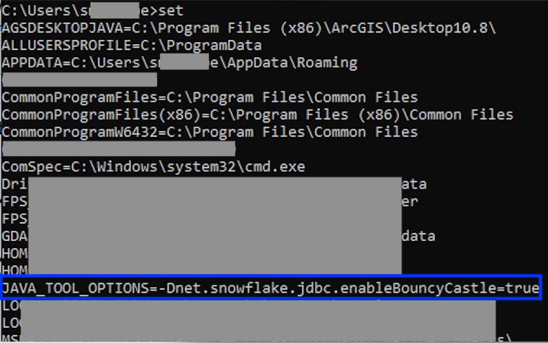

Ensure the JAVA_TOOLS_OPTIONS is properly set by reviewing the system Environment Variables. Open a command line and type set, then press Enter. You should see a list of output similar to the following. Confirm that the JAVA_TOOL_OPTIONS appear as below.
Restart FME Form and test again. If the issue persists, please contact Safe Software Support.
