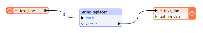

2. Build an FME workspace that will read the data you POST to it. In most cases, using the Text File Reader is best. Even if the data is XML or JSON, you can still use the Text File reader. Make sure to set the reader parameter "Read Whole File at Once" to Yes. You can then parse the data further along in the workspace using the appropriate XML or JSON transformers.
3. Add a writer to the workspace for output data - which will be sent to the Data Download or Data Streaming services. In the sample workspace attached (ReceivePost.fmw), we simply use a Text File writer to return the same data.

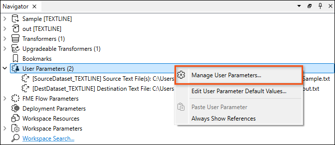

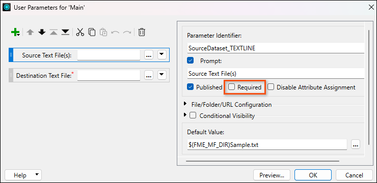

4.  From the Navigator Panel, right-click on User Parameters and select "Manage Parameters".
Ensure that the Required checkbox is disabled for the Source Text File(s). In order for the call to work, the source file parameter needs to be optional, so ensure that the Required box is not checked. The Destination Text File can remain enabled for the Required checkbox.

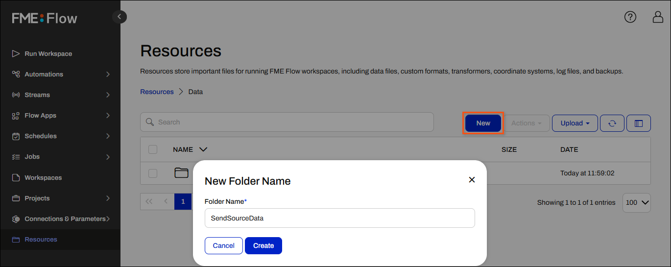

Create Folders in FME Flow & Link to FME Workbench
5. Log in to your FME Flow web interface using your admin account. Your admin account should be enabled with sufficient permissions for the following steps. The default permissions for the fmeauthor role will work too, but for best practice, use your admin account here. On the Resources page, select the Data folder and click New. Name the new folder "SendSourceData" and click Create. This will be the folder that the workspace will be writing out to.

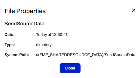

6. Select the newly created folder "SendSourceData", click "Actions" and go to "Properties".
A new window will appear, giving the folder's file properties. Copy the SystemPath:
 "$(FME_SHAREDRESOURCE_DATA)/SendSourceData"

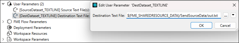

7. Return to FME Workbench. In the Navigator panel, expand User Parameters, right-click the [DestDataset_TEXTLINE] Destination Text File parameter, and select Edit Value. Paste the copied System Path into the Destination Text File value:
Finally, specify the output file name and format by appending "/out.txt" to the end of the System Path:
$(FME_SHAREDRESOURCE_DATA)/SendSourceData/out.txt
Save the workspace.

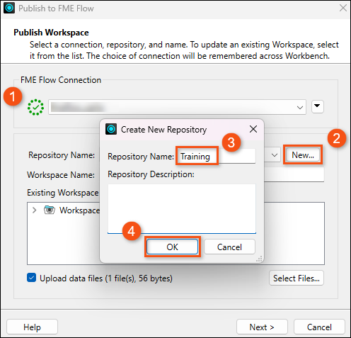

8. In FME Workbench, click the "Publish to FME Flow" button or select File > Publish to FME Flow from the menu bar. Connect to your FME Flow and publish the workspace into a new repository named “Training”.
Select a valid FME Flow connection, then click "New..." to create a new repository for the workspace. Name this new repository "Training" and click OK.

    3. Create Repository
    Repositories are used to store groups of related items that have been published to FME Flow (similar to directories). Items such as workspaces, source data, custom formats, custom transformers, and templates can be published to a repository.
    If you need to create a new repository, click on the New button next to Repository Name. Enter the repository name and an optional description. Click OK to close the Create New Repository dialog.
    To select an existing repository, click the drop-down next to Repository Name and select the desired repository.

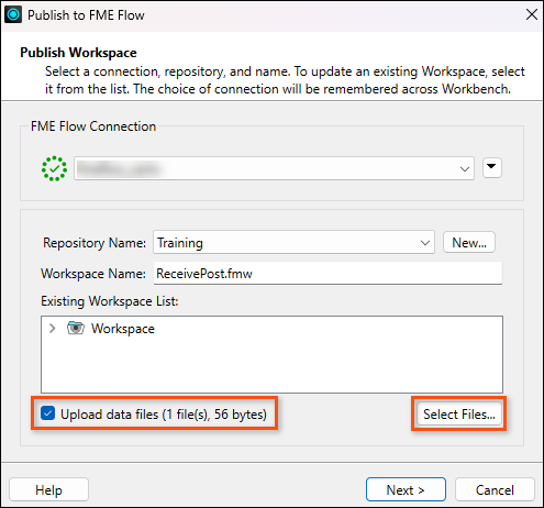

    4. Upload Files
    Some workspaces require additional files to run correctly on FME Flow, so these need to be uploaded along with the workspace. To upload files, enable Upload data files at the bottom of the dialog.
    When files are uploaded through the publishing menu, they are stored within the repository. If you want to upload folder files (such as geodatabases) or to specify where the files stored, the Select Files button allows you to do that. For detailed instructions on how to use the Select Files button, see the documentation.

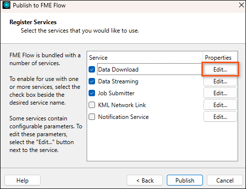

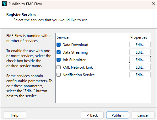

    5. Register Services
    The final step before publishing a workspace is to register services. Services control how the data will be output after the workspace is run.
    Services return results in different forms:
    • Data Download Service returns results as a downloadable zip file
    • Data Streaming Service returns results as a data stream
    • Job Submitter Service accepts and runs workspace job requests
    • KML Network Link returns a KML Network Link that can be used in Google Earth
    • Notification Service allows for event-driven messaging
    Typically, the Job Submitter is always enabled, but multiple services can be enabled. Once services have been enabled, click Publish.

9. Ensure "Upload data files" is enabled. Click "Select Files..." to ensure the path to your Sample.txt file is correct. Select OK and click Next.

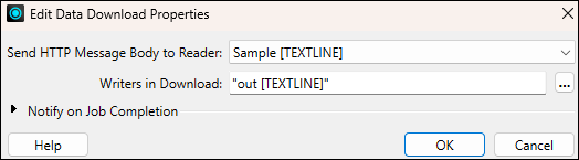

10. In the last dialog box of the Publish to FME Flow wizard, click on the Edit button beside the Data Download service.
First, ensure that the "Send HTTP Message Body to Reader" parameter is set to your reader. Below this is another parameter called "Writers in Download". Ensure this is set to your Text File Writer.
11. Repeat step 10 for the Data Streaming and the Job Submitter services. Ensure Data Download, Data Streaming, and Job Submitter services are selected and click Publish.

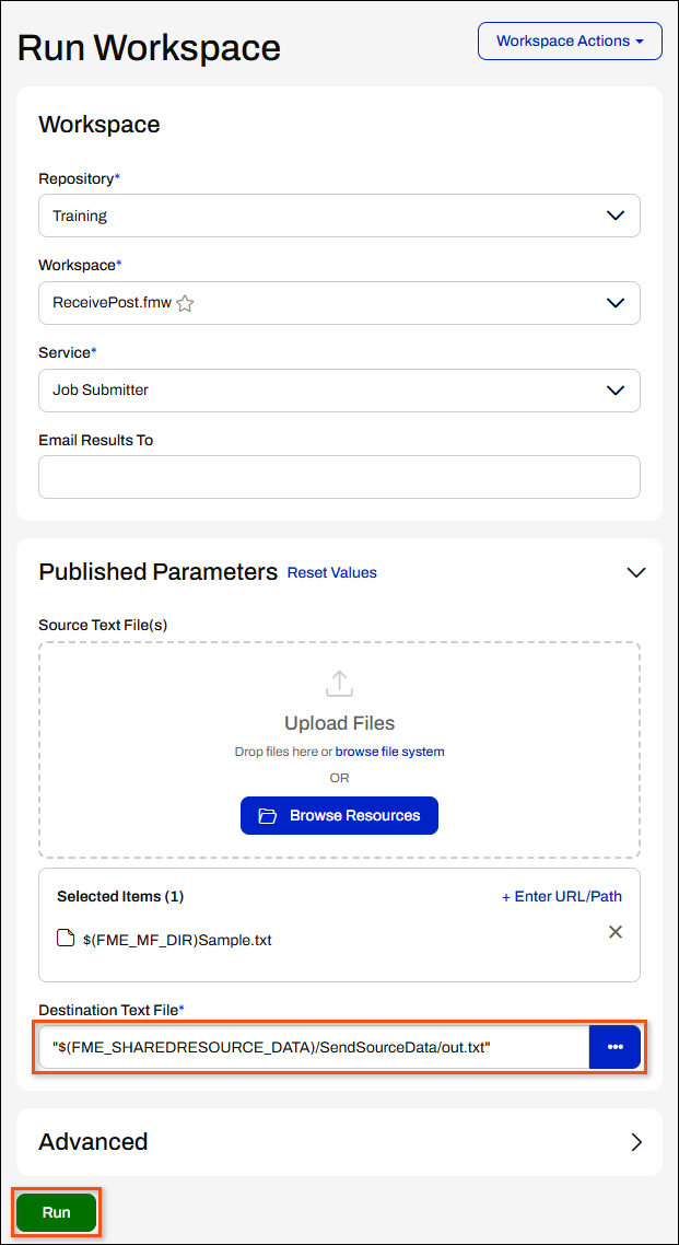

12. On the FME Flow web interface, go to Run Workspace. Select the Repository "Training" and the Workspace "ReceivePost.fmw" that was just published. Select the Job Submitter service and ensure that the Destination Text File ends with ".../out.txt".
Click Run to ensure the Workspace runs successfully.

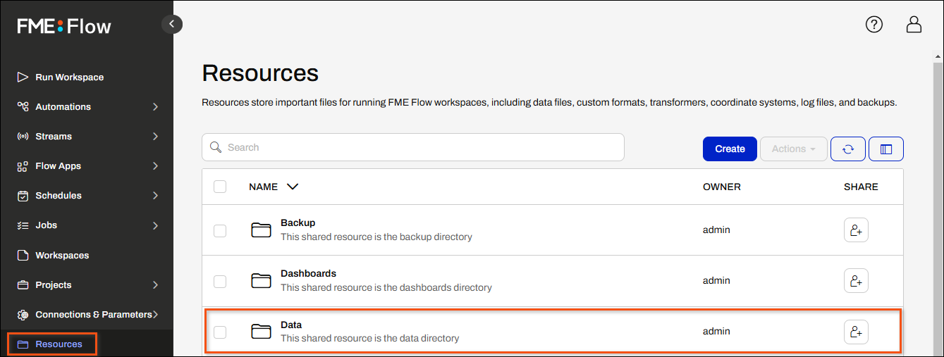

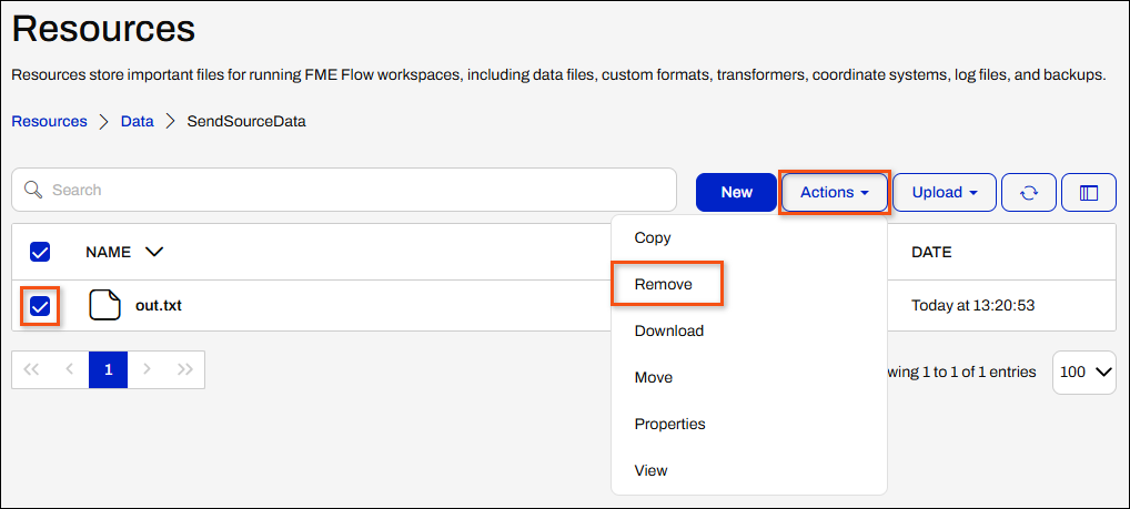

13. Once the ReceivePost.fmw is complete and the translation is successful, go to Resources > Data > SendSourceData > out.txt and delete this file. To delete the file, select it, go to Actions, and click Remove. Next, we will run the workspace via REST API.

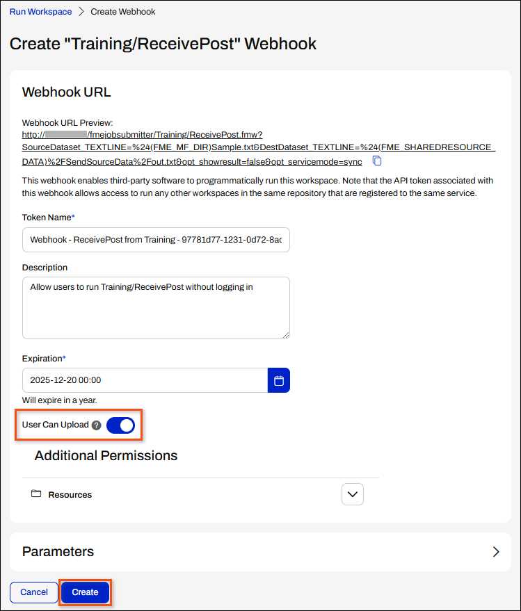

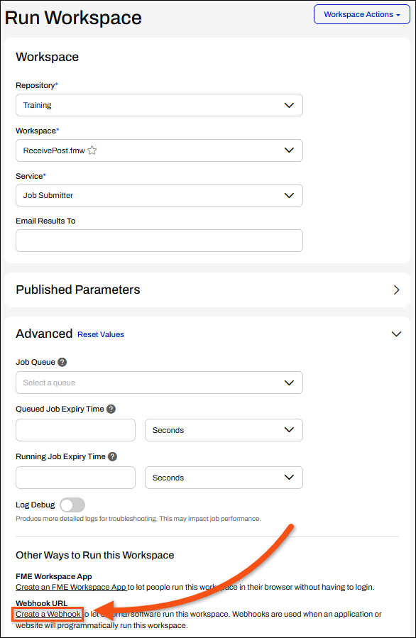

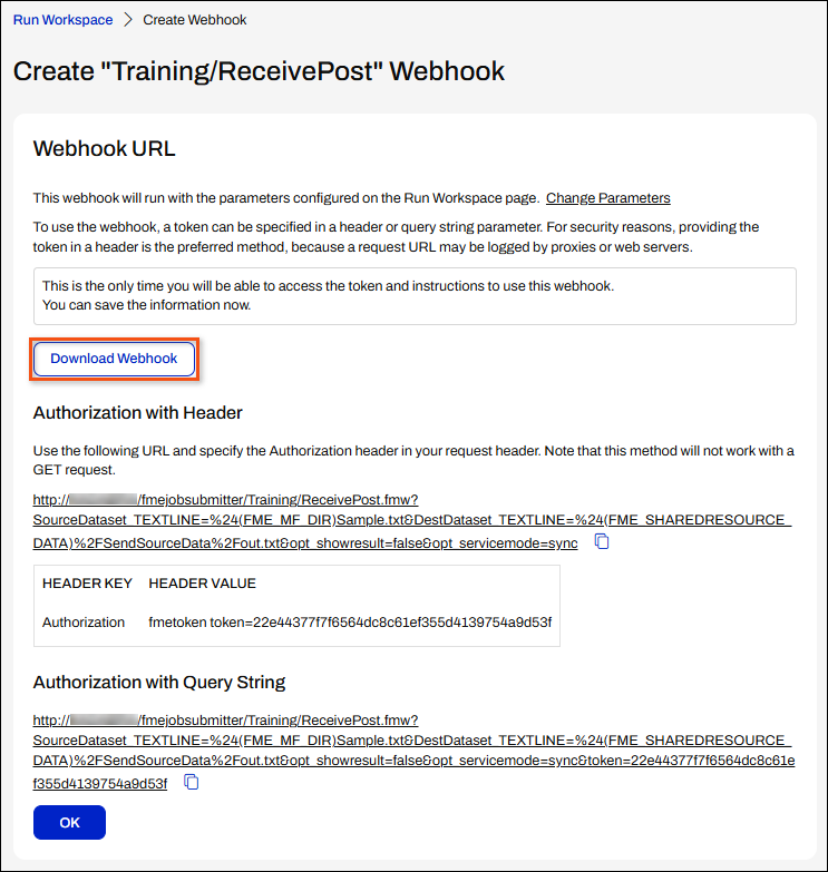

14. Return to the Run Workspace page. Open the Advanced panel and select "Create a Webhook". The webhook enables third-party software to run this workspace programmatically.
The API token associated with this webhook allows access to run any other workspaces in the same repository that are registered to the same service.
15. On the Create Webhook page, a Webhook URL for that repository will be automatically filled with the Token Name, Description, and Expiration date. You may choose to change the expiration date here. Enable "User can upload", and select Create. We will manage the Token's permissions after the webhook is created.
16. Download the webhook to save the information. This is the only opportunity you will have to access the token and instructions for using this webhook, so please don't skip this step.

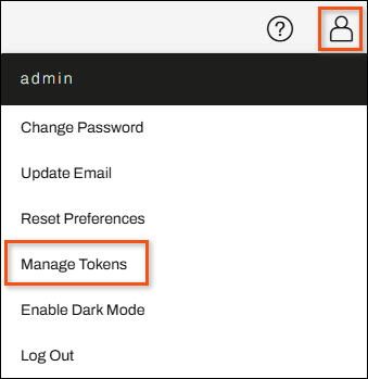

17. Now that the webhook is created, go to the FME Flow User Settings (top right corner) and select Manage Tokens.
This will bring you to the API Tokens page. To update the permissions, click on the "Webhook-ReceivePost from training" token that was created.

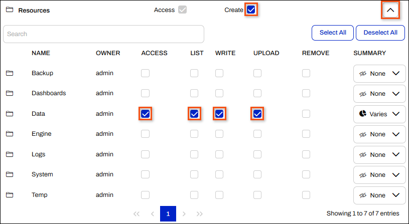

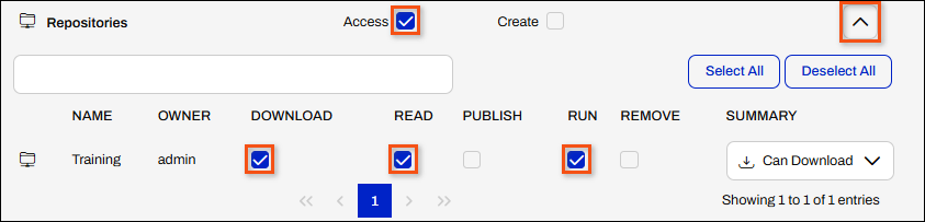

18. In the token's Permissions panel, enable Access to Repositories, and expand with the down arrow to reveal additional options. Enable Download, Read, and Run for the "training" repository.
Next, enable Create for Resources, and expand with the down arrow to enable Access, List, Write, and Upload for the Data Folder.
Select Advanced for Run Workspace.

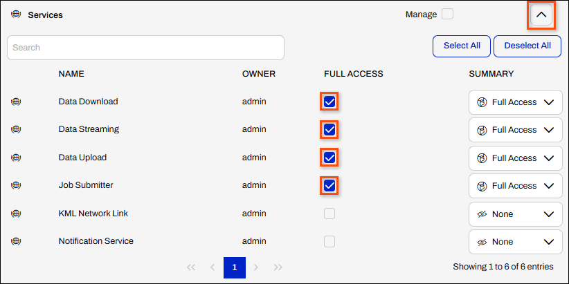

Finally, click the down arrow for Services to select the type of services you need with this webhook token. Enable Full Access to Data Download, Data Streaming, Data Upload, and Job Submitter if you want to only use one webhook for these services. At the bottom of the page, click Save to apply the new permissions to your webhook token.

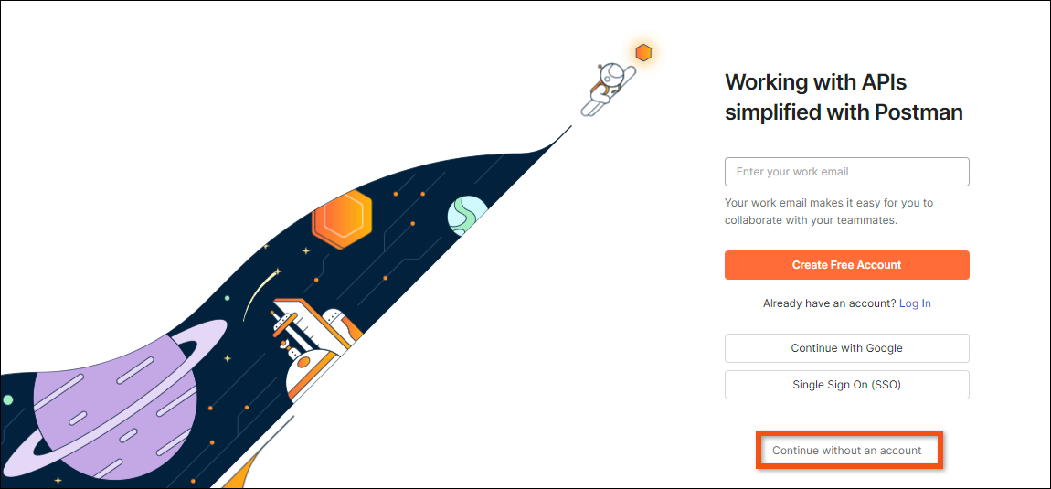

19. Download Postman using this link https://www.postman.com/downloads/. Postman is a REST client tool to make calls to FME Flow.
20. Open Postman and select "Continue without an account".

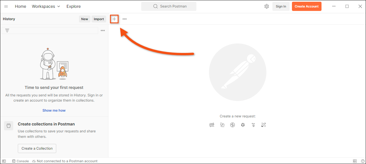

From the main Postman workbench view, click the "+" icon to create a new HTTP request.

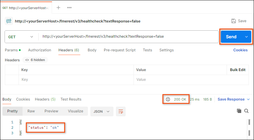

21. Before posting to FME Flow, let's start with a GET request to do a health check from FME Flow using the REST API.
Use the GET method and the following URL to send the request to your FME Flow. Please note, you will need to replace <yourServerHost> with your FME Flow hostname.
http://<yourServerHost>/fmerest/v3/healthcheck?textResponse=false
Click Send. The Body should return a JSON response of "status" : "ok" (200), which is a standard response for successful HTTP requests.
Note: This will be the only call that does not require a token.

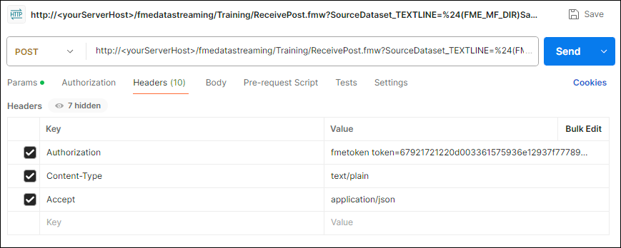

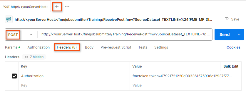

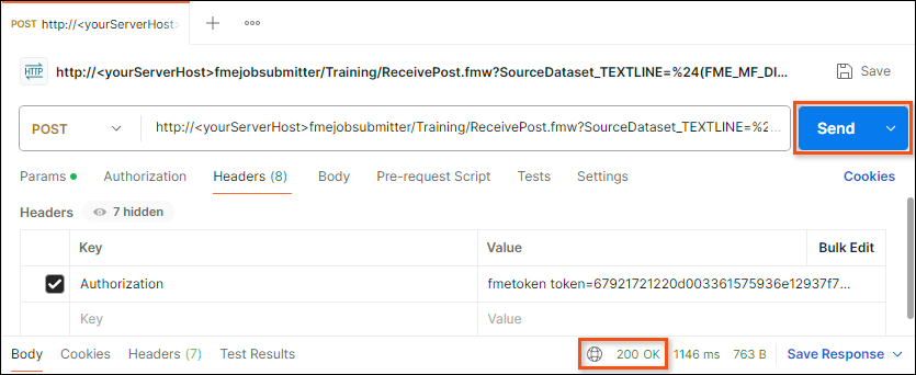

22. Let's proceed with the HTTP POST request. In Postman, create a new request by clicking the + on the tab. Change the HTTP request from GET to POST.
From the webhook file that you downloaded in Step 16 (fmewebhook-Webhook-ReceivePost from training -<yourToken>.txt), copy the Authorization with Header URL and paste into the "Enter request URL" parameter in Postman.
http://<yourServerHost>/fmejobsubmitter/training/ReceivePost.fmw?SourceDataset_TEXTLINE=%24(FME_MF_DIR)Sample.txt&DestDataset_TEXTLINE=%24(FME_SHAREDRESOURCE_DATA)%2FSendSourceData%2Fout.txt&opt_showresult=false&opt_servicemode=sync
Go to the Headers tab and add a new header. For the Header Key, enter "Authorization", and for the Header Value, enter "fmetoken token=<yourToken>".
23. Click Send in Postman, and a Status 200 OK should return, signifying a successful HTTP request.

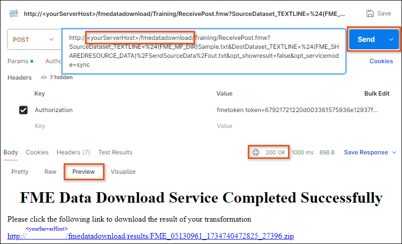

24. Since our token also has permissions enabled for the Data Download and Data Streaming services, we can access those services by simply changing a string in the request URL from "fmejobsubmitter" to "fmedatadownload".
In Postman, create a new request by clicking the + on the tab. Ensure the HTTP request is set to POST. Copy the Authorization with Header URL from your downloaded webhook file into the field. This time, we will edit the URL by changing the "fmejobsubmitter" string to "fmedatadownload".
http://<yourServerHost>/fmedatadownload/training/ReceivePost.fmw?SourceDataset_TEXTLINE=%24(FME_MF_DIR)Sample.txt&DestDataset_TEXTLINE=%24(FME_SHAREDRESOURCE_DATA)%2FSendSourceData%2Fout.txt&opt_showresult=false&opt_servicemode=sync
Navigate to the Headers tab and enter the same values that were used previously: for the Header Key, enter "Authorization", and for the Header Value, enter "fmetoken token=<yourToken>". Click Send.
A Status 200 OK should return. Under Body, select "Preview" to format the HTML. You will find the link to download the zip file. Paste the zip file link to your web browser and the data will be downloaded onto your machine.

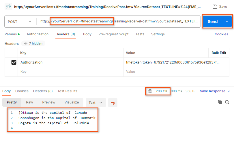

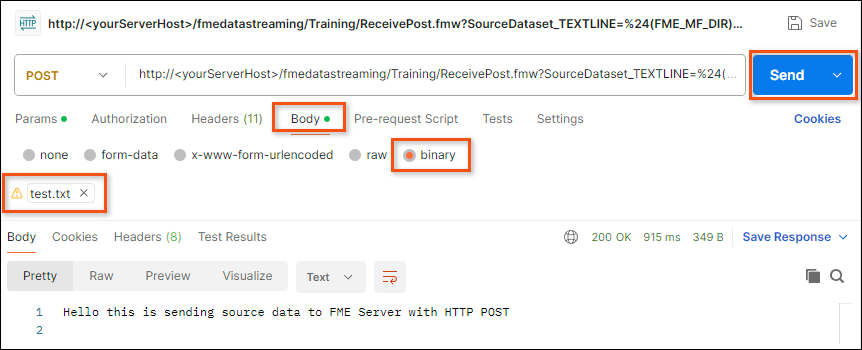

25. Repeat step 25 for the Data Streaming service, except this time, replace the "fmedatadownload" string in the URL with "fmedatastreaming."
http://<yourServerHost>/fmedatastreaming/training/ReceivePost.fmw?SourceDataset_TEXTLINE=%24(FME_MF_DIR)Sample.txt&DestDataset_TEXTLINE=%24(FME_SHAREDRESOURCE_DATA)%2FSendSourceData%2Fout.txt&opt_showresult=false&opt_servicemode=sync
Once you click Send, a Status Code 200 OK should be returned. In the return Body, the Data Source will be visible in the text format that was uploaded from the Sample.txt file.
To upload a text file as your source data, return back to the Headers section. Under the Authorization Key, we will be adding two more Keys-Value pairs:
  • Key: "Content-Type", Value: "text/plain"
  • Key: "Accept Key", Value: "application/json"
In the Body tab, select binary and upload the test.txt file from the Sample folder. You may choose to create your own text file or edit the test.txt file. Click "Send" and the Status should return 200 OK with the return Body "Hello this is sending source to FME Flow with HTTP POST".
Congratulations! You’ve successfully posted data to FME Flow and triggered a workspace that reads this data as a source dataset using several different FME services.
